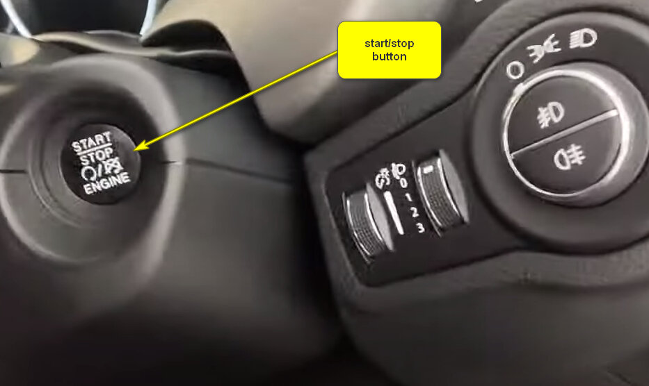

Is your vehicle equipped with a start/stop button? see image below.
If so, try holding the key fob directly at the button and press the button using the key fob.
