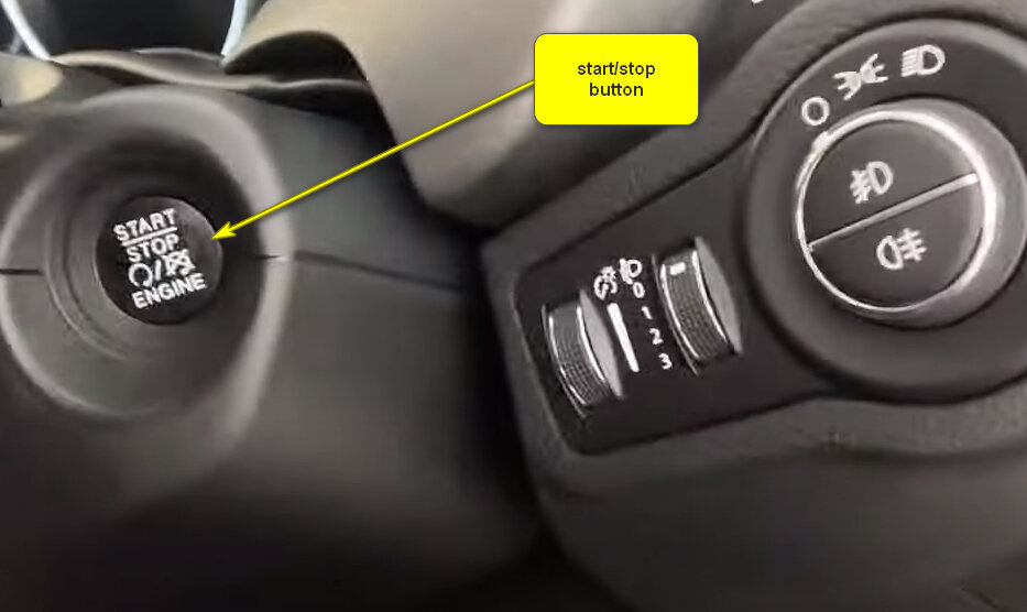

We can’t start the car. The battery in the key fob was replaced a few months ago and we’ve had no problems. All of a sudden, we can’t start - lights come on, but we get a warning that says, ‘check vehicle protection system’. We had done all sorts of locking and unlocking, from inside/outside, we have disconnected the battery for 5 minutes. We have held the lock button down…We have called Fiat and they tell us to get the car towed to them!

Is your vehicle equipped with a start/stop button? see image below.
If so, try holding the key fob directly at the button and press the button using the key fob.

The message "check vehicle protection system" usually points towards a possible failure of the Fiat Code (immobilizer) system and should be diagnosed using a suitable diagnostic tool.
I suggest trying and read the fault memory and post the fault codes here so we can evaluate and advise.
