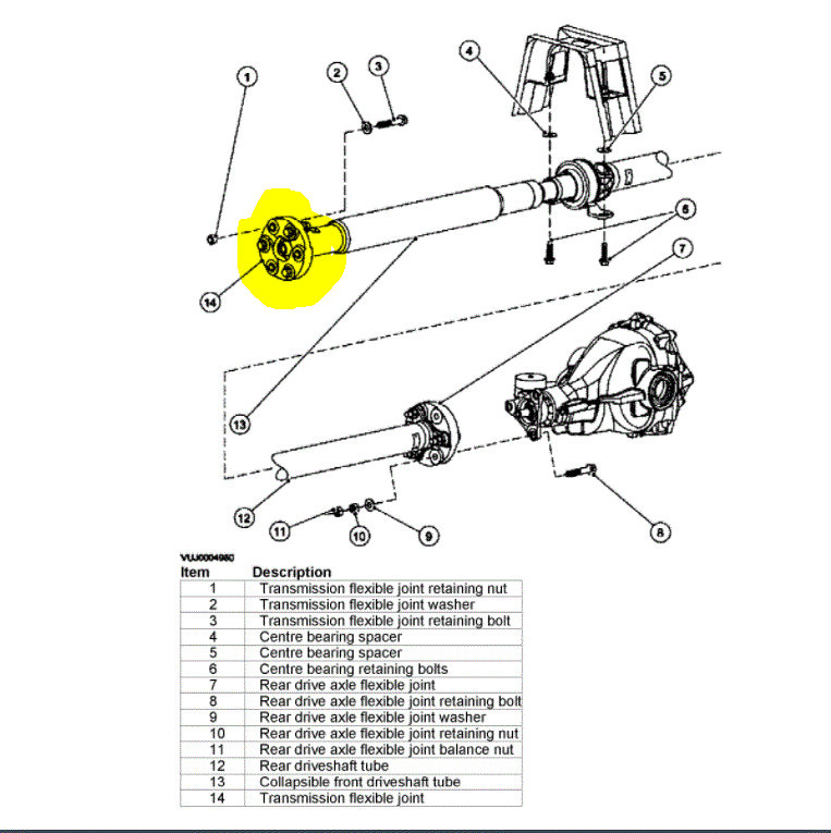

There is oil running down on the rubber that connect the driving shaft to the transmission
2003 JAGUAR S-TYPE
67,000 MILES • 3.0L • 6 CYL • 2WD • AUTOMATIC
AUSTINO
  • 228 POSTS
Good afternoon!
I removed the positive battery terminal wire to check the alternator if it is charging and when I removed it, the vehicle did not shut off but the battery light still remained in the dash board. Then when I looked underneath the car I saw oil leaking from the transmission so I jacked it up to see where directly the oil was leaking from. So I saw the oil running down on the rubber that connect the driving shaft to the transmission. Can you tell me if where the driving shaft connect to has a seal there? I wonder if this
issue can cause the problem that I told you about yesterday. Thank you in advance..

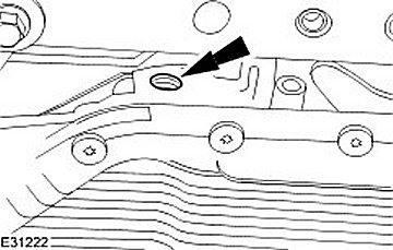

I attached a pic below that shows the driveshaft. I highlighted where it attaches to the transmission output shaft. Is this what you are referring to?

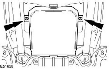

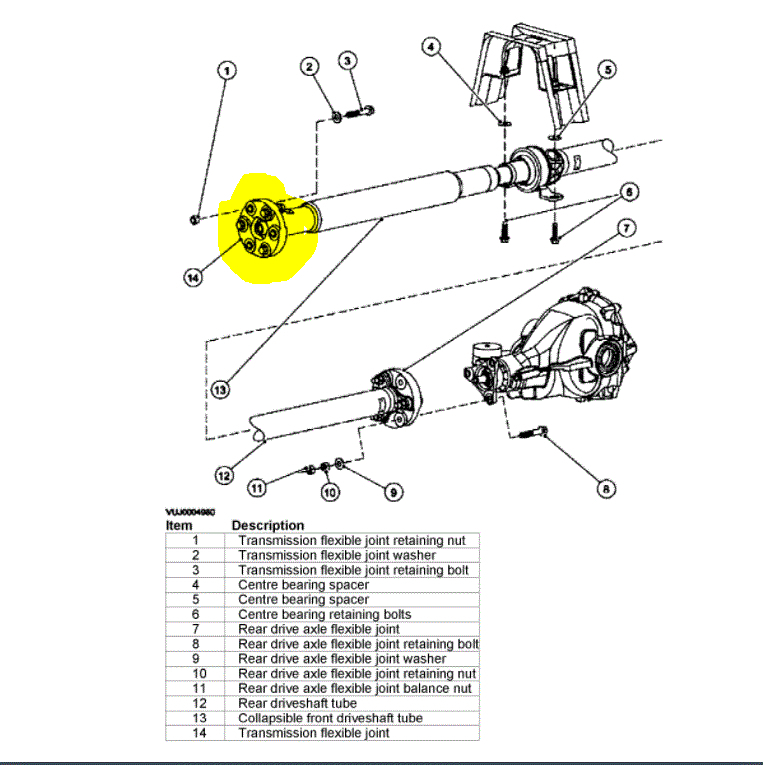

There is an extension housing seal where the driveshaft attaches that can leak. However, I can't picture how it would drip down on the driveshaft. See pic 2. That is where the seal is located. The pic shows seal location after removal of the driveshaft and extension housing.
If possible, take a pic of what you are seeing and upload it for me to see. Hopefully, that will help me diagnose the issue.

The seal needs to be specific to your vehicle. You should be able to find an aftermarket one, but I really question if that is the issue. You indicated it was dripping from above onto the driveshaft. I honestly don't see how the output seal could do that unless it is really leaking badly. Please send a pic so I can confirm. Seal replacement isn't a very easy job on this vehicle and it requires special tooling.
As far as the ATF, no. You have to make sure it meets the manufacturer's specifications.
Here is the fluid listed in my manual. You don't have to purchase this brand, but get one that meets the same specifications.

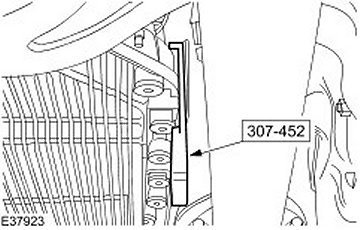

7. Place a suitable container under the transmission fluid filler plug.
WARNING: Make sure that care is exercised near rotating parts. Failure to follow this instruction may result in personal injury.
pic 3

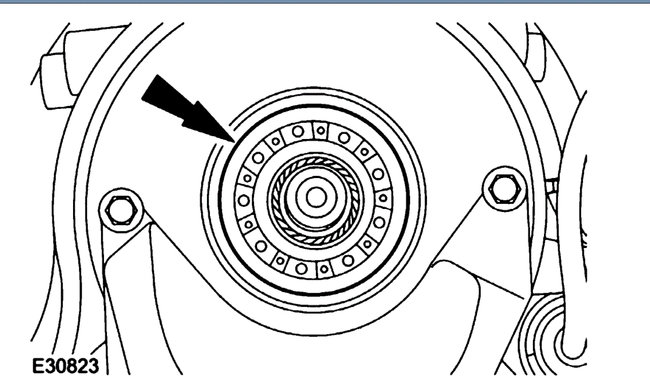

8. With the engine running, using the special tool remove the transmission fluid fill plug.
- Remove and discard the transmission fluid fill plug.
NOTE: Use transmission fluid meeting Jaguar specification.
pic 4

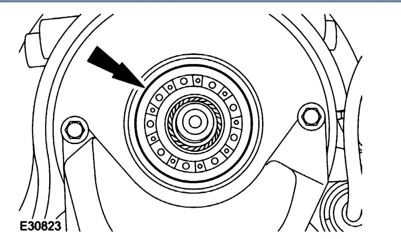

9. If the transmission fluid does not come out of the transmission fluid filler plug hole the transmission fluid level is insufficient. If this is the case add the transmission fluid in 0.5 liter units into the transmission fluid filler plug hole until fluid comes out.
NOTE: Make sure the transmission fluid temperature does not exceed 50°C (122°F). If the transmission fluid temperature does exceed 50°C (122°F) stop the transmission fluid level check and allow the transmission fluid to cool until the temperature is below 30°C (86°F).
pic 5
10. Allow the transmission fluid to drain from the transmission fluid filler plug hole until the flow almost stops.

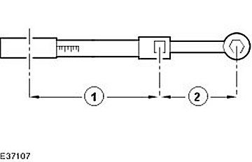

- Tighten the transmission fluid fill plug to the torque given by the calculation
- To make sure the transmission fill plug is torqued to the correct specification. Using the special tool and a torque wrench the following calculation steps must be followed.
Step 1.Multiply 35 Nm by the effective length of the torque wrench (1).
Step 2.Add the effective length of the special tool (2) to the effective length of the torque wrench (1).
Step 3.Divide the total of step 1 by the total of step 2.
Step 4.Set the torque wrench to the figure arrived at in step 3.
- Tighten the transmission fluid fill plug to the torque given by the calculation.
