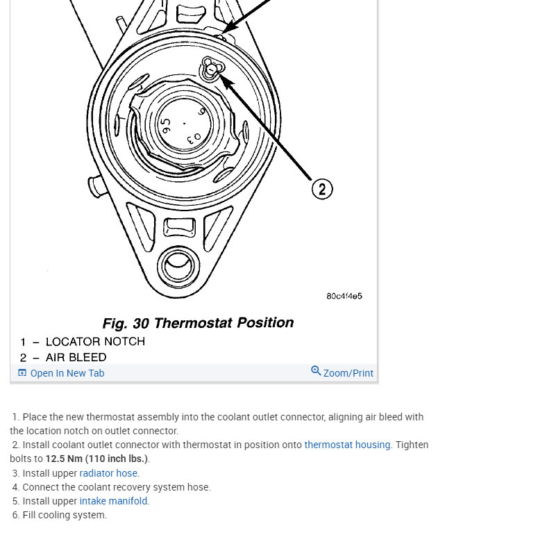

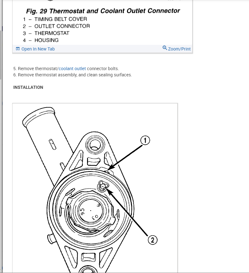

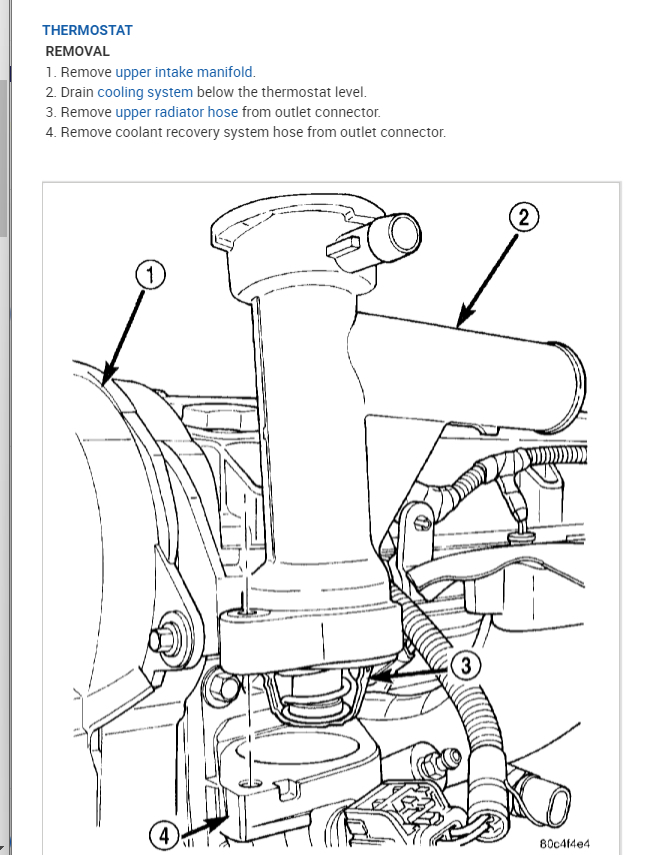

The next thing we need to do is use a laser temp gauge to find out if we have higher temp before the thermostat then after. If you do then the thermostat is stuck closed and it does need to be replaced.
https://www.2carpros.com/articles/how-to-use-an-infrared-temperature-meter
If this is what you find then here is a guide that will help with this.
