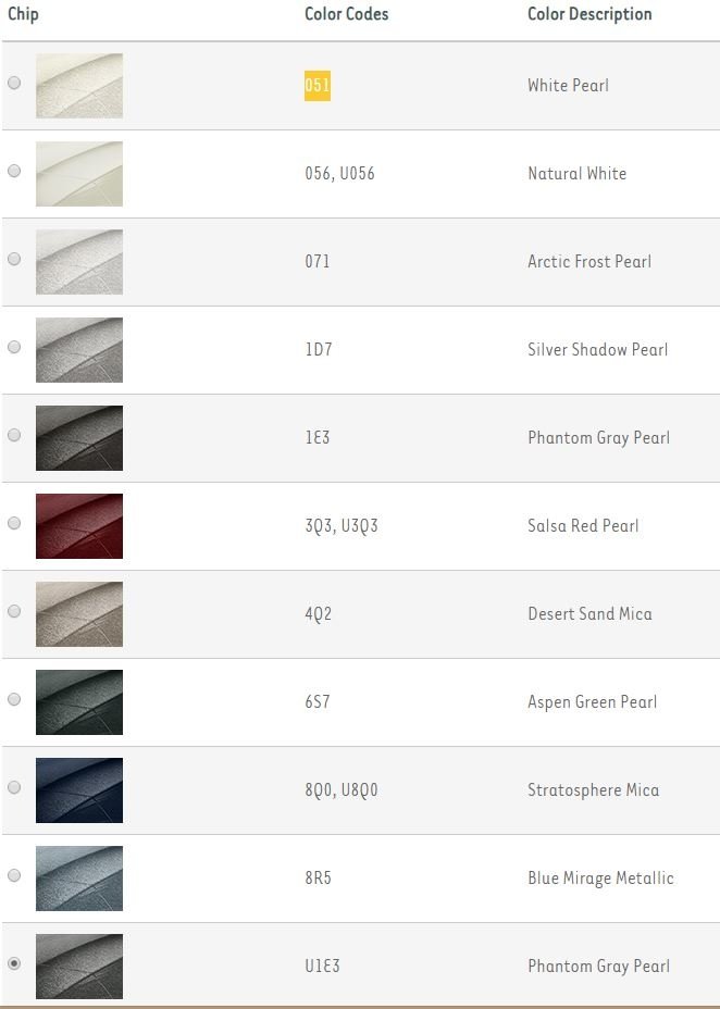

How can I tell the original color of the vehicle? The color code is 08C7V. Now, it doesn't necessarily mean that the color the car has now is the factory color. If I have to fix rust spots, I would like to match the color of the car exactly.

I do not find that as an exterior color on the Sienna, It should be a 3 or 4 digit code like shown in the image. The code is on the data plate on the door, the first three or four are the exterior color the other code is the interior color.

Thanks. I found it it's the IE3 Phantom Gray Pearl. So I would have to purchase the paint and have a professional like yourself see if it's a match.

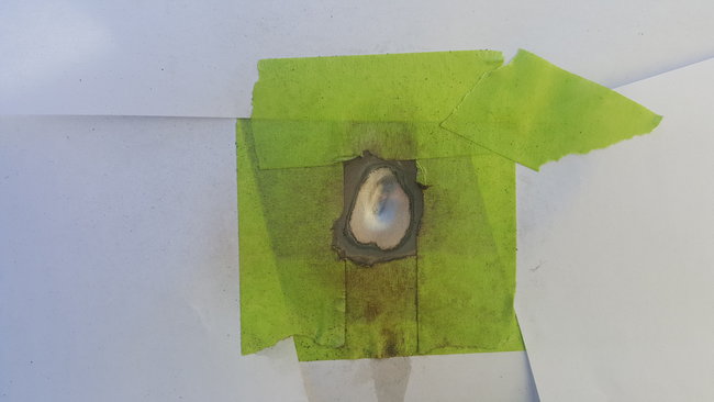

I was able to clean the rust of the dent.
2 questions. Can I leave the area exposed without filler and primer and just covered with automotive masking tape for a day?
2nd. Question: How do I fill in the dent in the area to be painted. It's about 1/4" deep or a little less but there is no hole opening. You really can't see the depth of the dent in the picture.

Could you take a wider picture please? Hard to tell where that is to determine how to repair it and if it's a panel that is easy to get behind. You will also need to go farther out with the sanding and clean the area. As for filling it, It depends on the dent. Ideally you don't want filler very thick as it can crack. You can leave it that way for a while it will not really hurt it, just rust or corrode a bit. In a shop it depends on who is doing the work. If the panel it accessible from behind I'd probably go in with a shrinking hammer and dolly to see if I could take most of the ding out. Then rough it up good and apply a thin coat of a good filler, scuff it and apply another, then sand off as much as needed to get the surface back to original. Then epoxy prime it. Sand that and shoot the color and clear. The problem is that it depends on what panel that is and where the ding is as to how much it will show.

It's on towards the edge of the hood and is right by the indentation design the hood has on both sides. Underneath the hood is another layer of sheet metal that's welded covering the underneath of the hood with the issue.
I guess I can apply filler, thin layer, let it dry (harden), then keep applying thin layers of filler until the dent levels out with the rest of the hood and prime it, paint it, clear coated, wait 48 hours and apply rubbing compound.

Good luck, it sounds like you have a plan. That area is a pain to repair without a stud gun or similar because of the double layers. As for how long it will last, that all depends on how well it is prepped and how good the materials used are, I have seen rush jobs that lasted a month and others where they actually cared and used good materials last 10 or more years.
For filler to stick you want a roughened surface, I generally apply filler over an 80 grit scratch. Then you want to sand between the layers of filler to remove the chemicals that will rise as it hardens. Once you get it to a good shape then start with 120 and get it close. Now apply a guide coat, basically a very thin, like a hardly sprayed spritz of cheap black lacquer spray paint. For a DIY job the black duplicolor can stuff works okay. Then sand it to final shape and contour. The guide coat will show you if it's low or smooth. Blow it off and sand with 200 grit. Apply a coat of primer, let it cure and sand again. Now if at all possible let it set for a couple days with just a coat of primer. That lets the filler shrink if it's going to and then give it a final sanding and spray on the color and then clear. Now let it set for at least a couple days before you do anything else. You will likely need to wet sand the clear to get it even and smooth. Then you can compound it.
