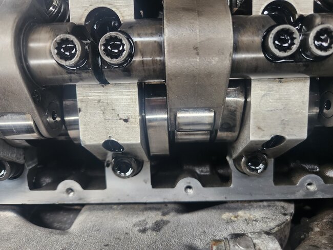

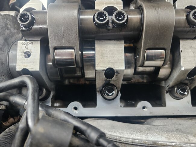

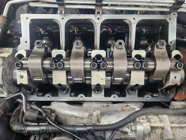

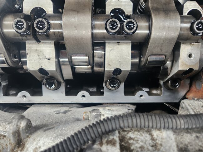

Upon rapid acceleration the vehicle blows black smoke until the throttle is let off. Initially the RPMs jump about 1000 so I'm assuming the turbo is working. I checked the vacuum at the pump, and it was about 30 inHg and at the turbo actuator where it was 24 inHg. I had an experienced VW mechanic listen to it and he thought it sounded like a misfire. Possibly a bad injector. I don't have a VAG-COM to aid in diagnosis. I removed the valve cover to inspect the cam and lifters and have included pictures of their condition. I was unable to remove the timing belt cover so I could rotate the cam to fully inspect the lobes and lifters but there does appear to be some wear and ridging on at least one lobe. I will inspect them more fully when I get the cover off. Then I can also adjust the clearance on the injectors. How do I know if each injector is working? It's not like I can check for a pulse since they are inside the valve cover. I'm new to this type of engine and any advice would be appreciated. The car is drivable, it just doesn't have the power it should.

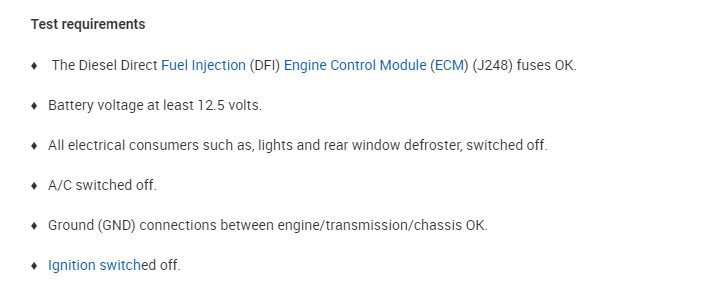

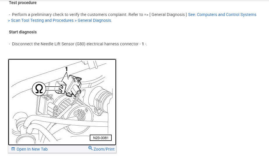

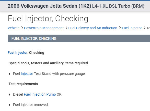

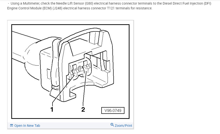

Black smoke is an indicator of a rich fuel mixture. It can be caused by a few things such as a faulty coolant temp sensor or a faulty fuel pressure regulator. Also, a bad injector can cause it. Make sure there is nothing restricting the airflow to the engine.

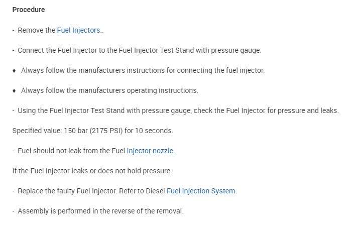

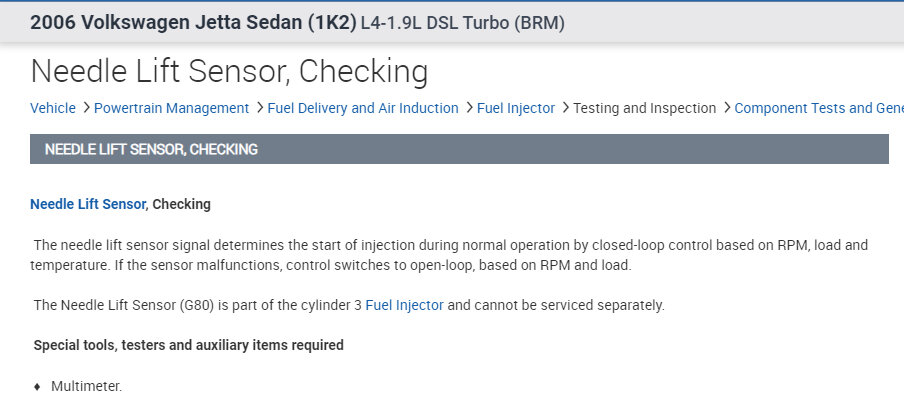

To test the injectors requires their removal and a test stand/pressure gauge. I attached the directions below. (Pics 1 and 2)

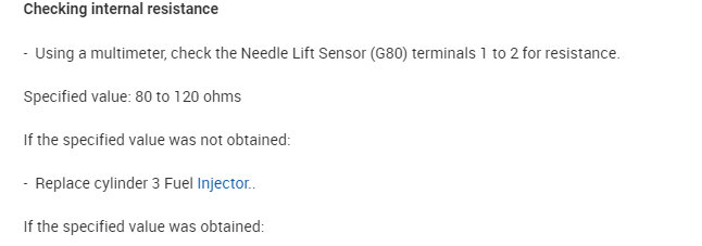

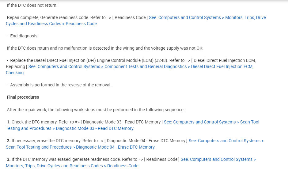

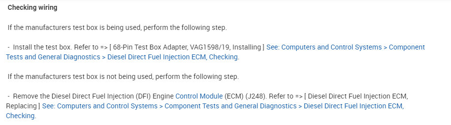

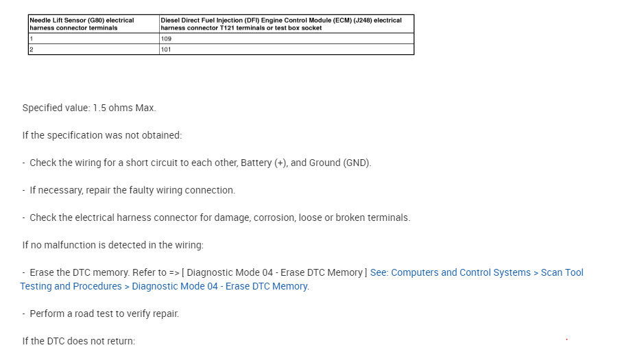

Also, consider checking the needle lift sensor integral on injector 3. The remaining pics below are the diagnostics for that as well.
Let me know if this helps.

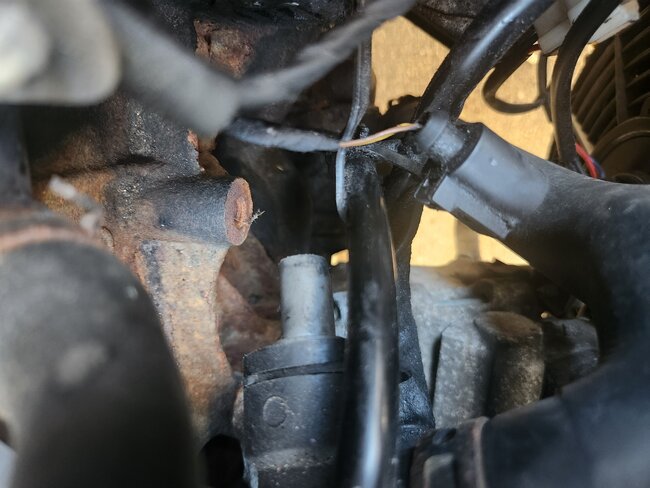

Did you look at the photos of the cam lobes? There is a coolant temperature sensor that isn't connected because the connector doesn't fit the sensor. However, the temperature gauge remains at 190 and the fans don't run but have been direct wired to a toggle switch. Lots to sort out with this car. I don't have access to any of the test equipment you described.

From the pics, the cam lobes look fine. It's really hard to tell in a picture. I hope you understand. Which pic are you seeing a disconnected temperature sensor?

I thought they looked okay also but the camshaft/valvetrain is making a lot of noise and the engine is lacking power and misfiring. I plugged the sensor back in and it actually ran worse. I'll include a picture of the sensor which now I can't get the connector back off.

It runs actually very well once it shifts out of 1st and 2nd. It has trouble getting going and the valve train makes a horrendous noise. I let off the accelerator and allow it to shift into 2nd. It emits a tremendous black cloud so thick that cars behind me slow down or even switch lanes. It reminds me of an old van we drove and disconnected a vacuum line and put it in a bottle of transmission fluid. What a glorious cloud of smoke that created. People thought we blew our engine. Oh the good old days of tomfoolery. The Jetta will be parked until I replace the cam and lifters. I don't know why I'm getting a zero ohms reading. It's certainly not the first time I've checked injectors?
