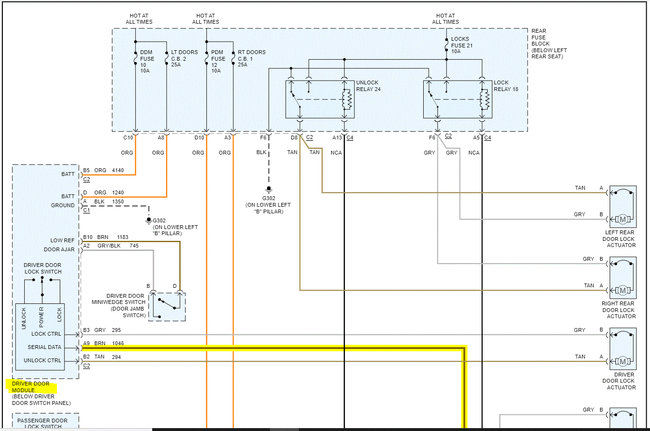

Vehicle is in good condition. DDM not working snap Shows com 2 No Data. Transmission drives in 2 Wheel only Same Com 2 No Data. No lights on in cluster.
May 21, 2022 at 5:08 PM
  • 110,240 POSTS

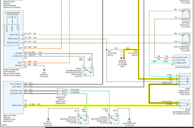

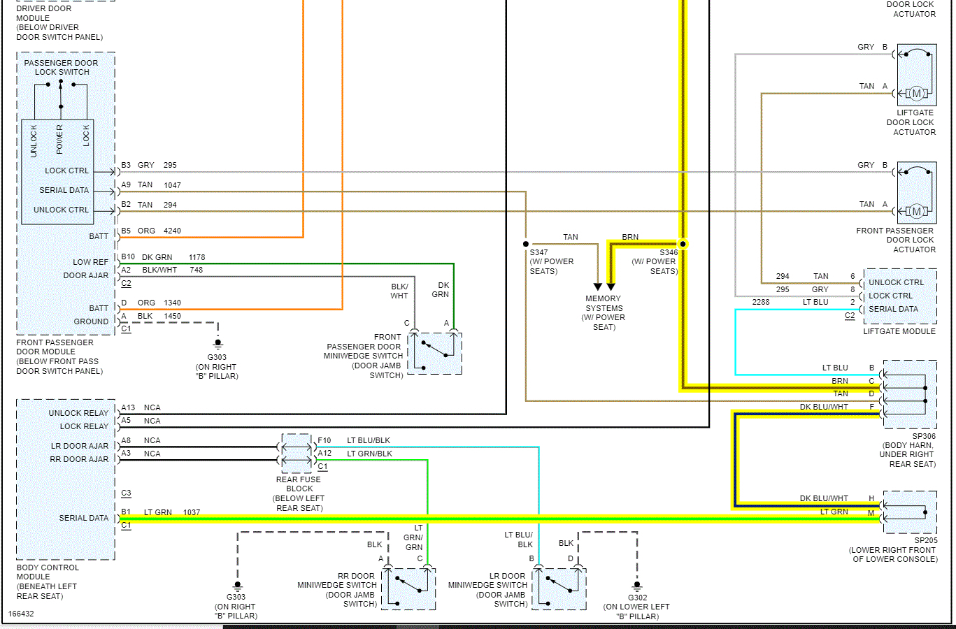

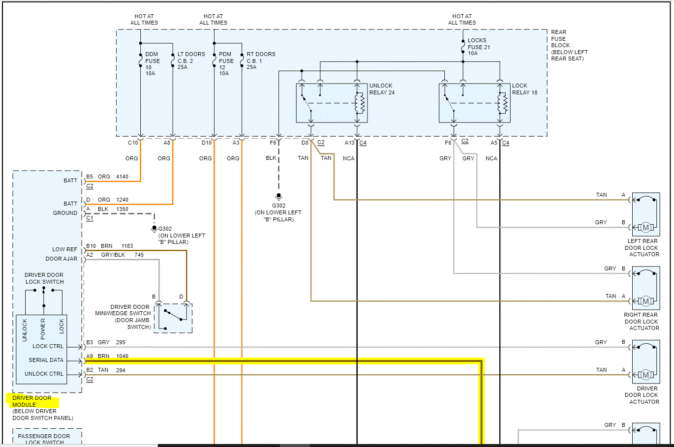

The only serial data line related to the DDM is from the body control module. I attached the wiring schematic below that shows how they are joined. I highlighted the wiring.
What I noticed is there is a splice under the right rear seat that may have been damaged or disconnected. This is where I would suggest checking. If the connection is good, disconnect the battery and check for continuity in the wiring.
See pics below. Note: It was one page long. I had to cut it in half to make it readable, but I did overlap the two so you can follow from one to the next.

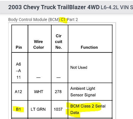

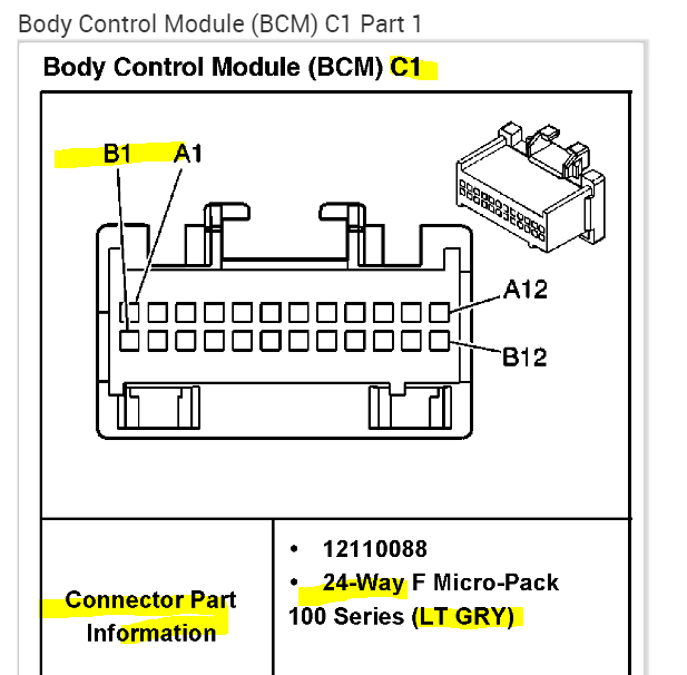

I'm still trying i have problems to identify the correct green data wire in the body control module plug. There are a few green wires. I have two plugs in the body control module and your diagram. regards
Aug 8, 2022 at 11:18 AM
  • 110,240 POSTS
The one you are looking for should be solid light green. I is pin B-1 in connector 1. The connector will be gray in color.
Take a look at the pics below and let me know if it helps.
