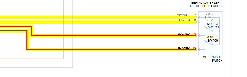

The vehicle information display control buttons do not work at all. I have check fuse number 19 and it is in good condition. I actually removed it and all it did was turn off the radio, need help please.
Jul 19, 2020 at 6:25 AM

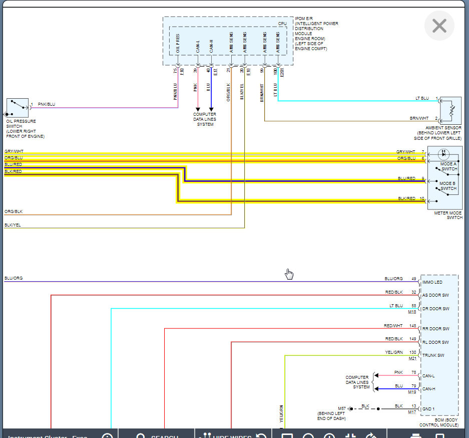

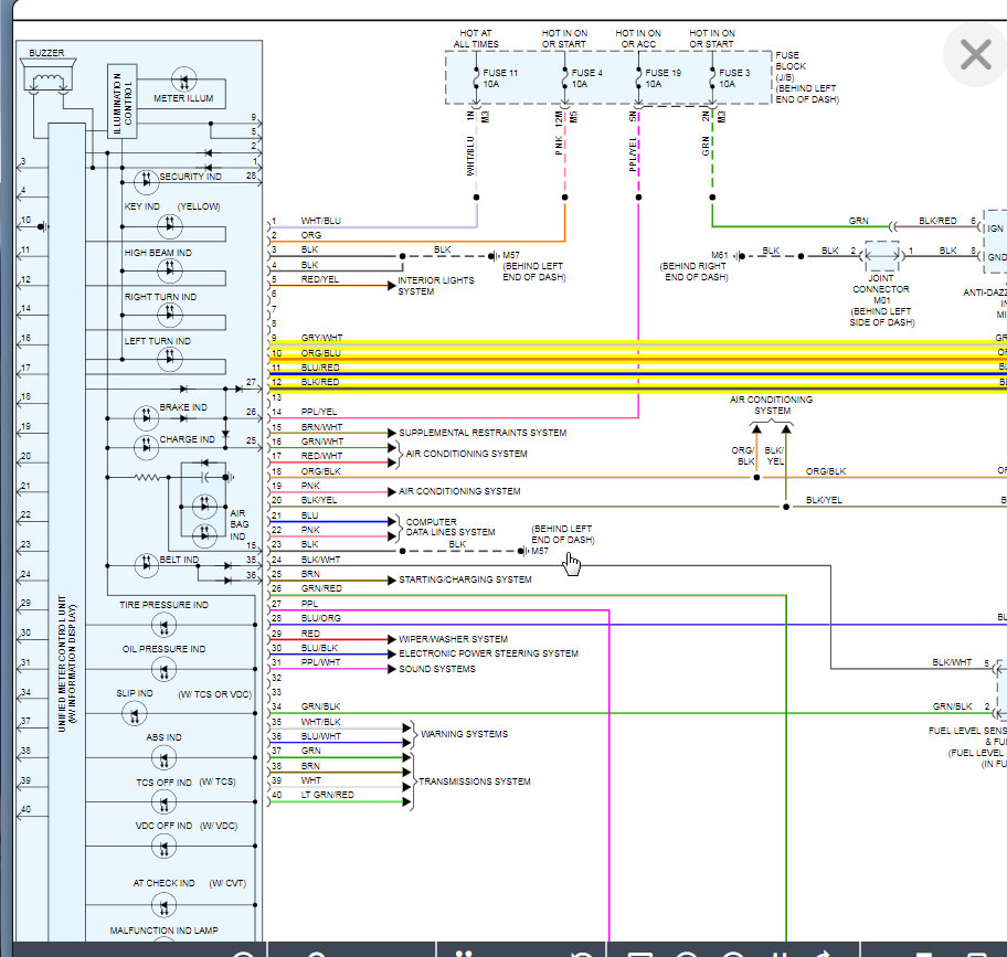

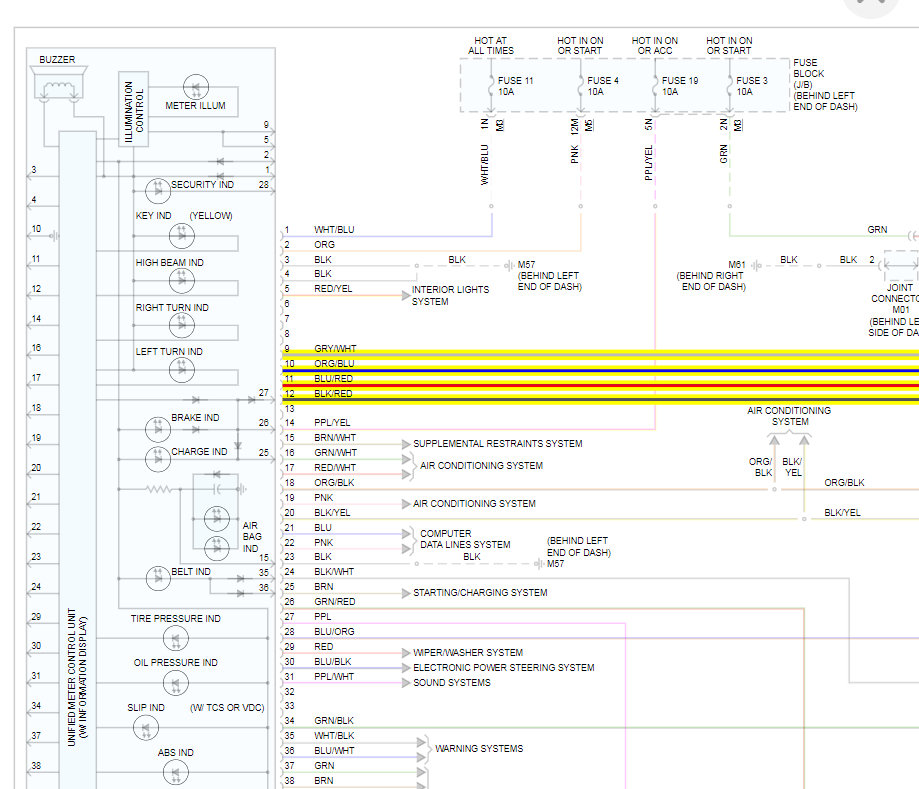

When you say the display buttons, I assume you are meaning the mode buttons that flip through the information display. If that is the case, I attached the wiring diagram and that shows that these buttons are direct feeds to the cluster. So that means either the buttons or cluster are the issue. The way to check this is to measure voltage coming from the buttons when you are pressing them. If you have no voltage then the buttons have failed. If you do then most likely the cluster is the issue.
Unfortunately there are no easy ways to tell. Does everything else in the cluster work?
Jul 19, 2020 at 9:18 AM
NUNYO YOUNG
Yes, everything works correctly in the cluster except i can't change the vid with the buttons.
