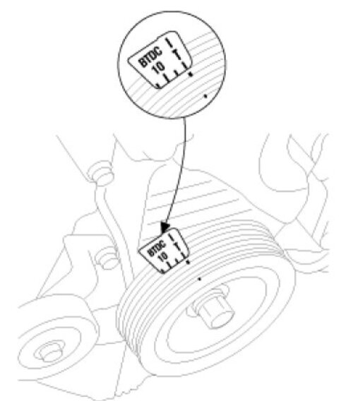

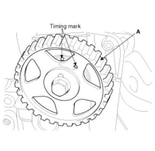

The vehicle was parked, the following morning. It could not start but it is cranking. The fuel pump is functioning and supplying fuel, there is spark from the ignition coil. The fuses are intact. The timing belt was check, it didn't cut.
could you provide a diagram to check the timing belt if it has not jumped some teeth?
Aug 12, 2025 at 5:39 AM
  • 55,423 POSTS
Yep, I got you covered, if the engine sounds funny when cranking the timing belt may be broken or jumped. I would go over this video as well:
https://www.youtube.com/watch?v=lXLJbuAZ4CE&t
Please upload a video in your response from under the hood so I can hear it can confirm the timing belt issue. Check out the images (below).
