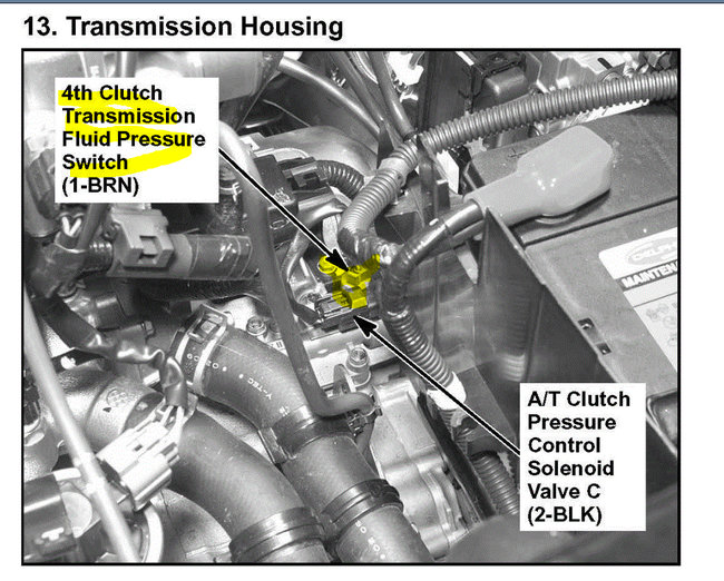

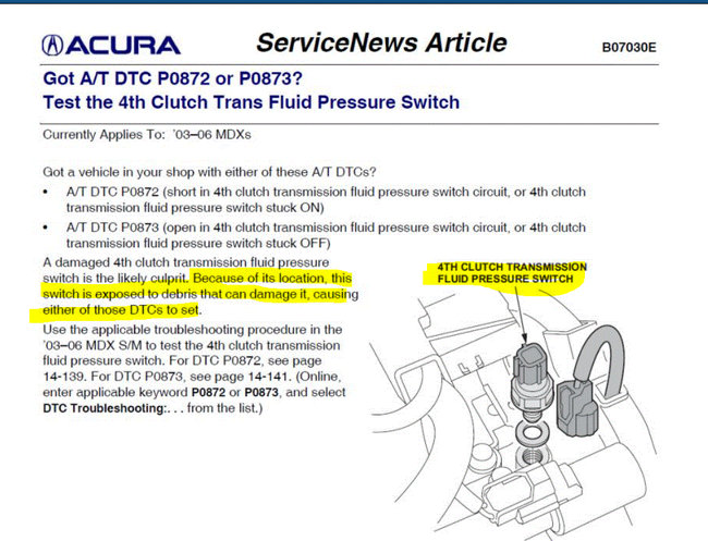

Because of the 4th clutch transmission fluid pressure sensor's location, it isn't uncommon for them to fail. If you lose pressure, it can feel like it goes into neutral as you described.
Take a look at pic 1 below. It is from Acura and indicates the potential issue. I would like you to locate and inspect the sensor, wiring, and connector to it. Pic 2 shows its location.
As far as the codes you provided, they are identified for this year and model. It would be a great idea if you could get your hands on a scan tool and see what is there presently.
Let me know if this helps, what you find, and if you have other questions.
