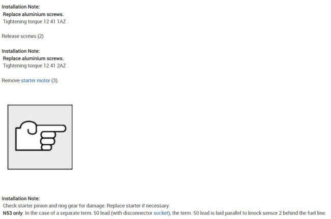

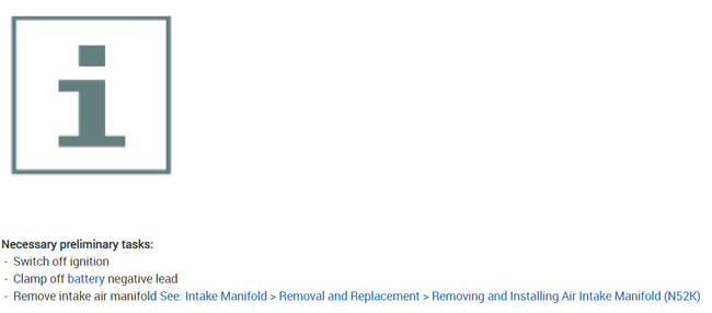

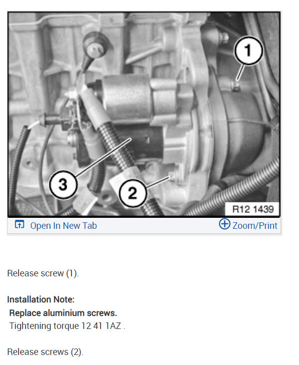

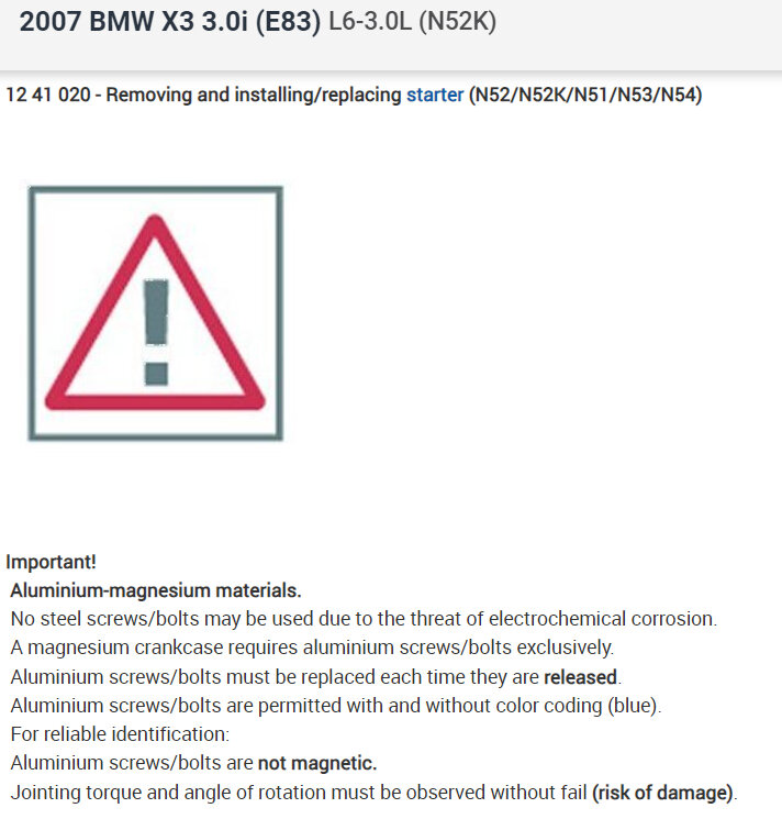

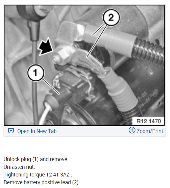

Yep, this happens when the starter motor goes out, to be sure test for power at the trigger wire of the starter solenoid. This guide can help, and I have included the location of the starter and how to change it out in the images below.
If you have power at the trigger wire and the engine is not cranking over the starter motor is bad. Check out the images (below). Please upload pictures or videos in your response of any problems so we can see what to help you with.
