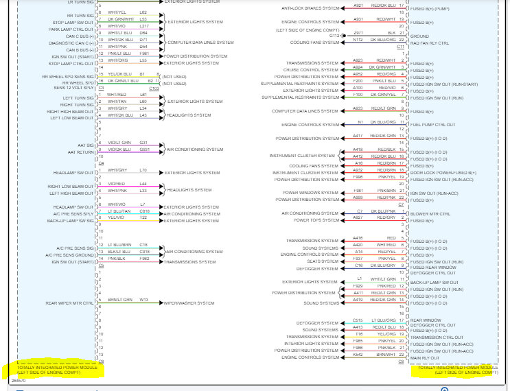

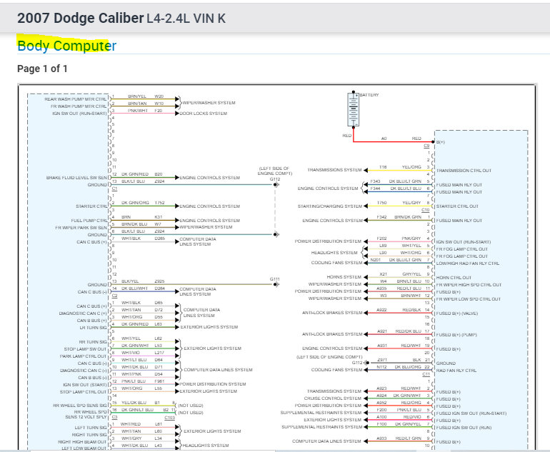

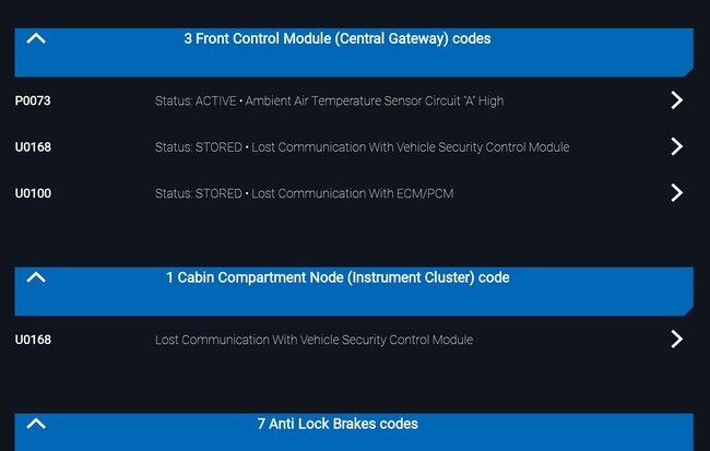

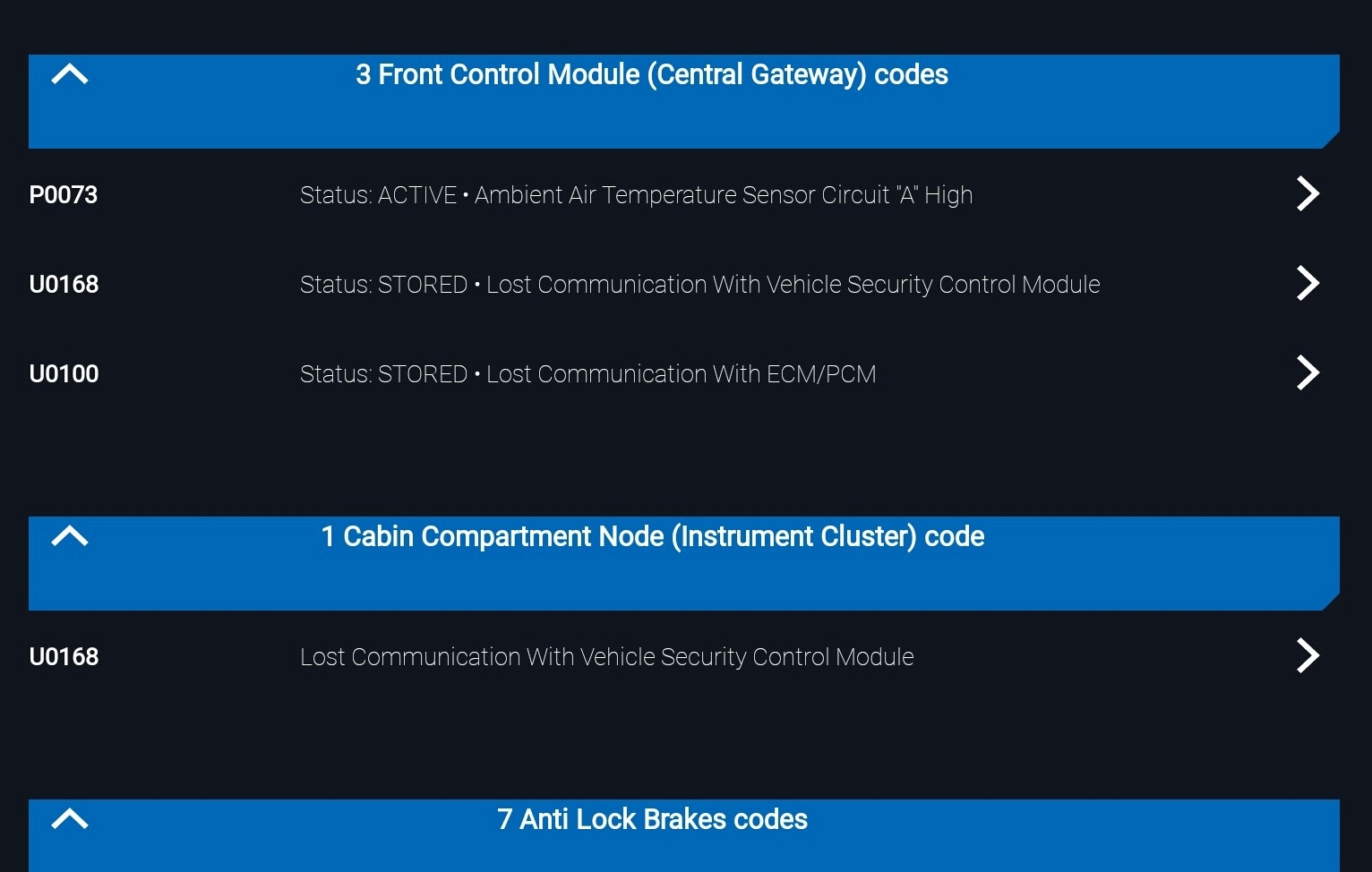

This vehicle does not crank from key after engine replacement. Then i diagonize it and detected code under frontal control module: u0100: lost communication with ECM/PCM and under cabin node (instrument cluster) u0168: lost communication with security control module.

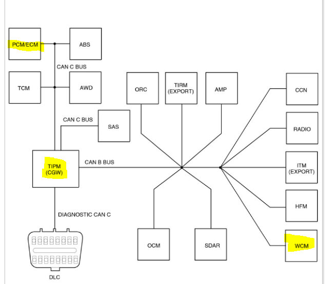

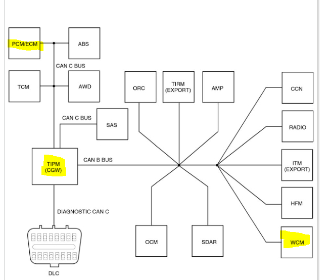

Can i have the communication diagram on how communication line started from dlc down to last module? I attached the screenshot of diagnostic result.

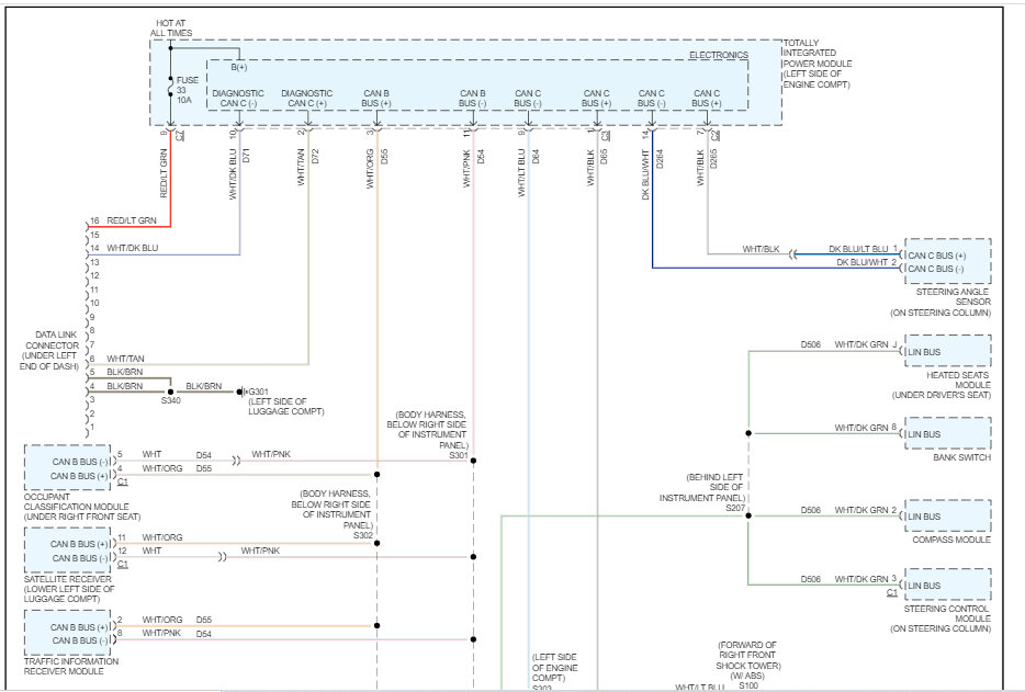

The first thing that I think of is the totally integrated power module. The pins in the connectors are often an issue. If you had things disconnected, that is where I would check first. Make sure we don't have a bent, corroded, or pushed-in pin.

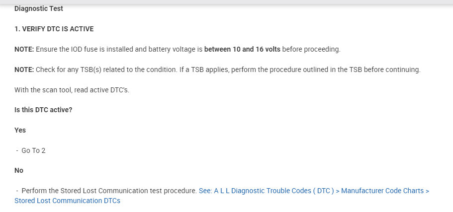

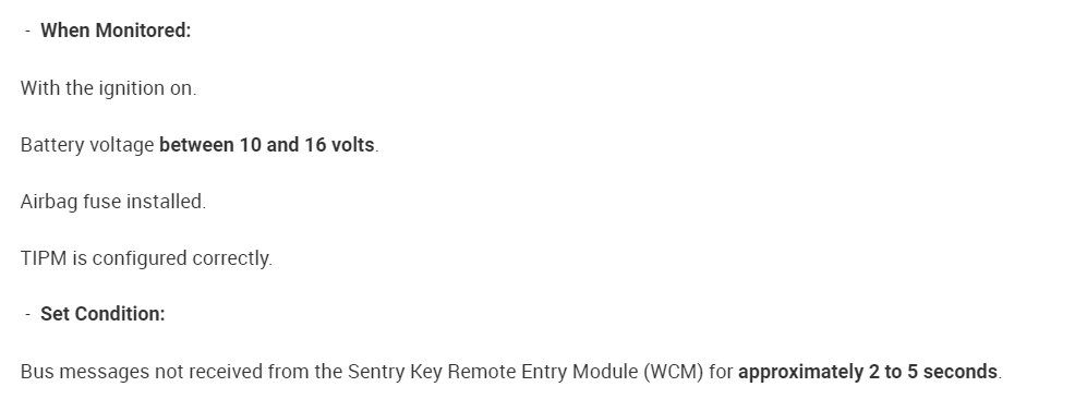

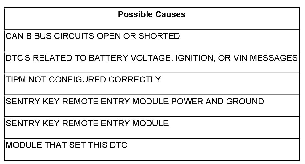

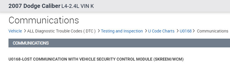

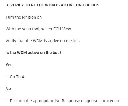

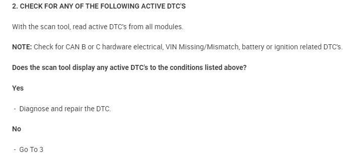

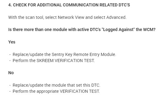

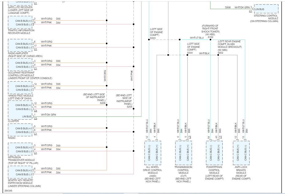

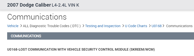

As far as the schematics are concerned, I attached the communication data line schematic below. See pics 1 and 2. The remaining pics are specific to the U0168. I'm somewhat confident that is where the problem lies.
When you look through the diagnostics, note that the communication from the WCM is done over the can B circuit. The PCM is connected to the can C circuit via the TIPM. That is why I'm suggesting starting there.
Additionally, I attached the diagnostics specific to this code as well.
Let me know if this helps and what you find.

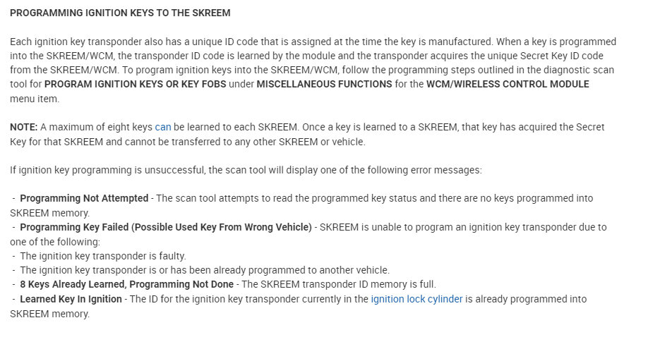

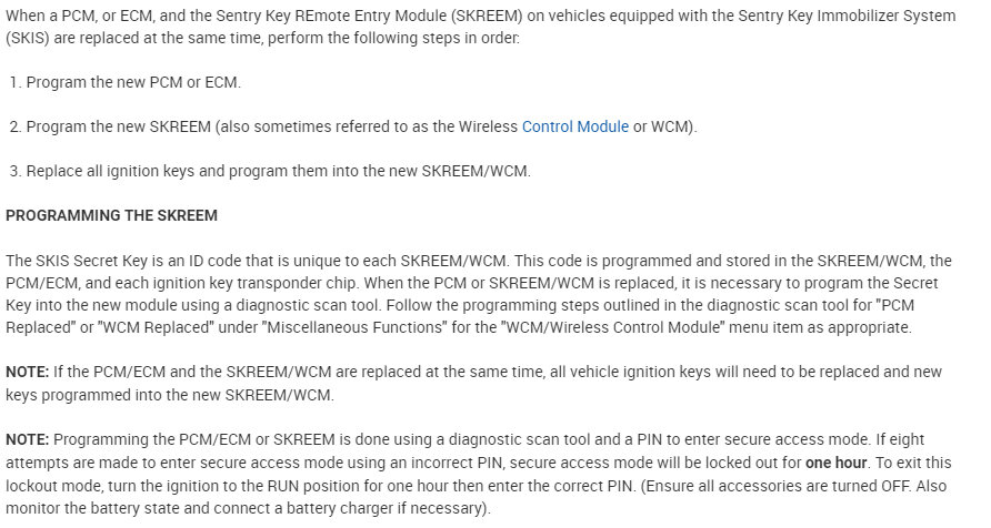

I have come to tell you that I noticed another thing. WCM stored this code B2204: ECU configuration mismatched. I have taken time to review the diagnostic report and it all recorded there as many times as I diagnose. So how do I update the WCM (SKREEM or Immobilizer) for the VIN to transfer from PCM to Immobilizer?
Nov 27, 2022 at 2:27 PM
  • 110,244 POSTS

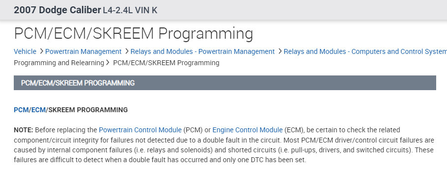

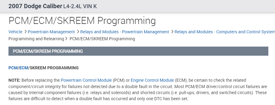

The VIN needs to be the same in the WCM and the PCM/ECM. If you look below, I attached the directions for matching the VIN between the two. Also, the directions include programming the keys to the WCM. In this case, as well, you need a 4-digit PIN to access the secure access mode.
Let me know if this helps.
