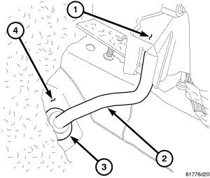

Ok let me know what you find on the coolant. I would also like you to check the A/C drain on the passenger side of the car at the bottom of the firewall. It will look like a rubber hose coming out of the firewall it will be best seen from under the car should look sort of like the pic below and be in about the same location. Put a screwdriver up in the drain and see if there is any debris in it. It may be that all the condensation is not able to drain when you use the A/C or defrost.

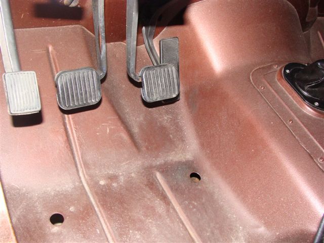

When you have a "real vehicle" it comes factory ready for this type of event. Drain holes in the floorboards!

Pull back the floor carpet to gain access to the condensation drain tube located on the left side of the vehicle at the right side of the foot well. You're going to see the tube go through the floor panel leading outside. If possible, go under the car where the drain tube would be sticking out from and use compressed air to blow into the hose, this should unclog the tube and the water should start draining freely.
