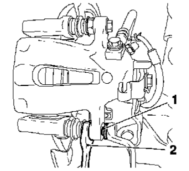

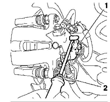

4. Detach the parking brake cable from the brake calliper (see illustration below).

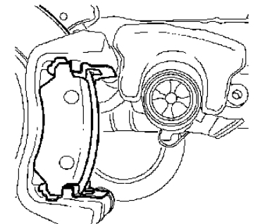

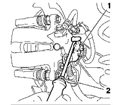

5.Loosen the lower retaining bolt holding the brake calliper ( see illustration)
6. Fold the brake calliper upwards (see illustration).
7. Remove the brake pads.

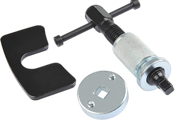

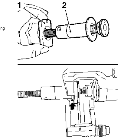

8.Wind back the piston using special tool (see Illustrations).
