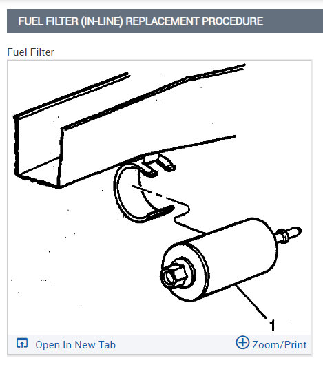

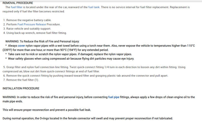

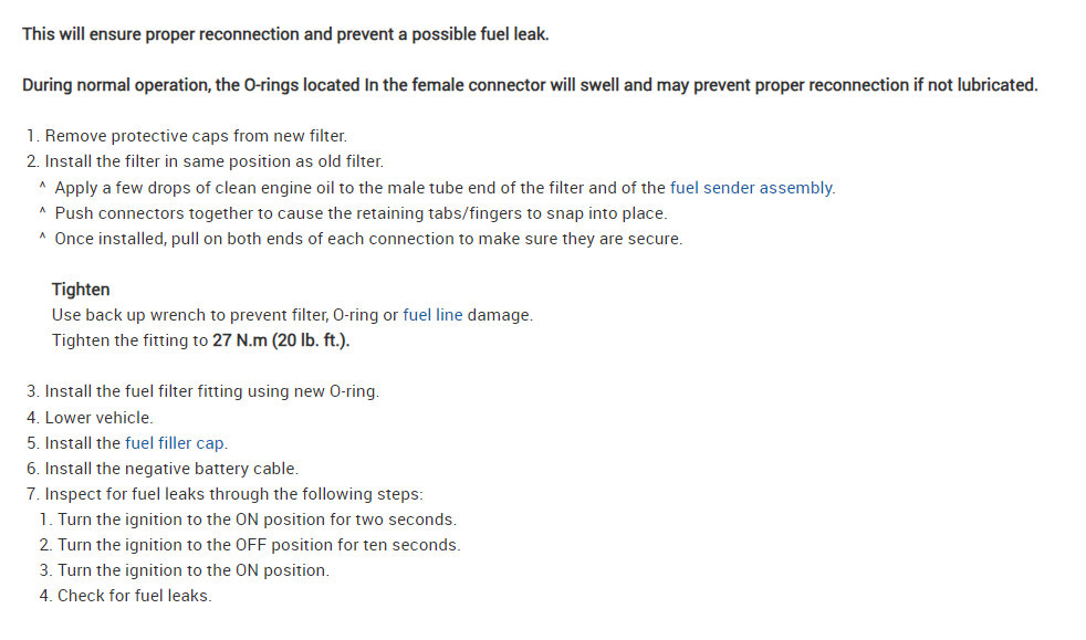

Yep, that can help but to me it sounds like the fuel filter is plugged or you have a clogged catalytic converter. This guide can help and I have included the location of the fuel filter so you can change it out which should be done as a regular service anyway.
https://www.2carpros.com/articles/engine-has-low-power-output
Check out the images (Below). Please let us know what happens.
