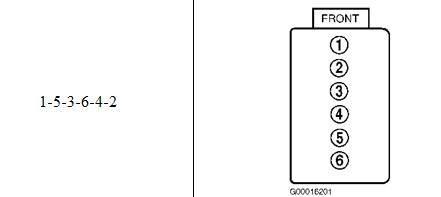

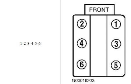

Could you tell me the firing the firing order of a 3.2 v6 24valve engine and what order the HT leads go in as we have searched the web to no availand are desperate thank you
Mar 12, 2010 at 8:19 AM
DAVE H
  • 13,384 POSTS
Basically this is an isuzu trooper in disguise .. so you can use a trooper repair manual ! they made a straight 6 3.2L and a V6 .. have included both diagrams .. I do not have the HT lead diagram it may be worth your while to contact the dealer !
