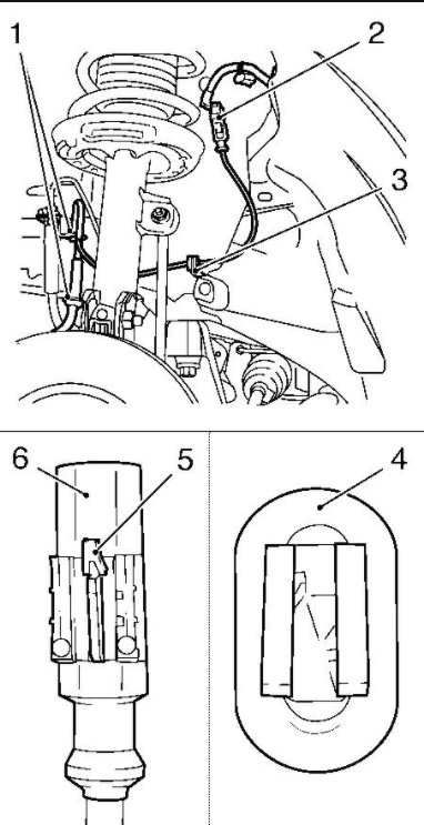

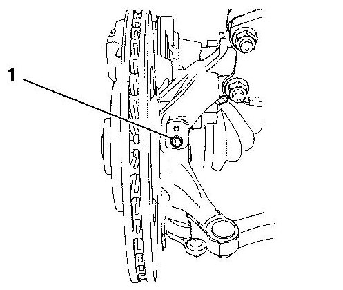

front wheel speed sensor.
2002 VAUXHALL CORSA
54,000 MILES • 4 CYL • 2WD • MANUAL
EMMA-LOU
iv had a ABS light on telling me I need a new right front wheel speed sensor.
Jul 17, 2010 at 12:29 AM
BORIS K
  • 836 POSTS
I would suggest to first check the ABS system using a diagnostic scan tool. Any relevant fault codes could then be properly addressed.
To replace a wheel speed sensor please see the below link.
https://www.2carpros.com/articles/how-to-replace-an-abs-wheel-speed-sensor
And how to test a wheel speed sensor.
https://www.2carpros.com/articles/abs-wheel-speed-sensor-test
I would suggest that you inspect the wiring from the wheel speed sensor to the ABS module. Often the wiring is damaged by the tyre if it is not correctly routed. Please see images below for sensor location and wiring routing.
Please let us know how you get along.
Cheers, Boris
