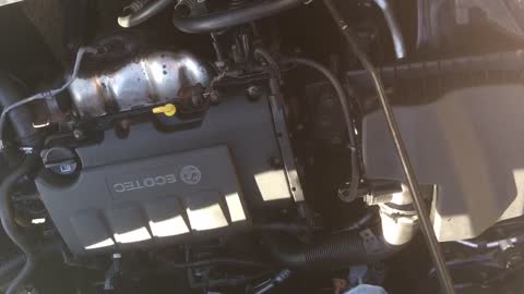

It starts sometimes but then shuts off out randomly and won’t start again. I’ve had the crankshaft sensor replaced and still not fixed. It cranks but doesn’t start.

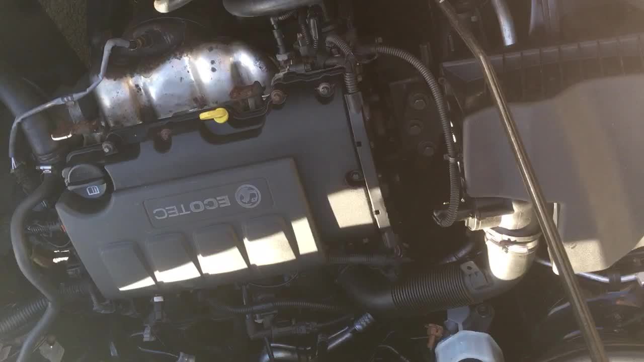

Hi mate, starter fluid does not make it start when it isn’t working. I’m going to attach a video of the engine running and being revved. I believe it could be something to do with the timing.

Okay. It could be a timing issue but I don't necessarily hear a timing issue in that video but that doesn't mean it is not.
So let's do the next step. When it is not starting, let's pull a spark plug and connect it back to the ignition and then hold the plug against the engine block and see if there is spark. If there is spark and starter fluid doesn't help then we need to dig further into a timing issue. Basically at that point we can assume it is getting spark at the wrong time and so it is not starting.
Have you been able to check for codes and see if there are any related to this?
