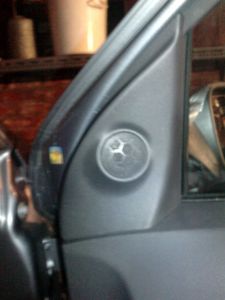

I have purchased a new Drivers Side mirror to replace the damaged one. Does the small triangular door panel just pull off to expose the mirror fixing bolts. I do not want to do any damage.
Many thanks[img:1c5cd28655]http://www.2carpros.com/forum/automotive_pictures/490438_Door_Panel_to_side_mirror_2.jpg[/img:1c5cd28655]

yes it just pills off/unclips .. it is usually easier to remove the inner door panel first before trying to remove mirror cover
