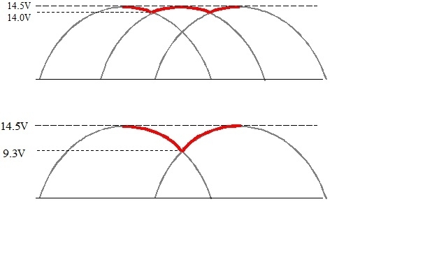

All AC generators, (aka "alternator), develop three-phase output, as shown in the top waveform below. Three-phase is very efficient, but it has some "ripple" voltage. In the top waveform, ripple voltage is only half a volt, the difference between 14.0 volts and 14.5 volts. It's the battery's job to smooth that out to a steady, roughly, 14.3 volts. The voltage regulator is the other half of the team. It holds system voltage to a safe level, and the battery is needed to help it do that.

Charging systems can fail in a number of ways. One way is the failure of one of its six "diodes". Those are one-way valves for electrical current flow. When one fails, you lose exactly two thirds of the generator's current-producing capacity. Your generator is rated at 110 amps. With one failed diode, the most it can develop is less than 40 amps. That may not be enough to meet the demands of the entire electrical system under all conditions. The battery has to make up the difference as it slowly runs down over days or weeks. With the misguided test of removing a battery cable on an older car, the engine would keep on running, even though the generator is defective.

Full-load output current should be within a few amps of your generator's rated current, 110 amps. Ripple voltage is usually just shown as "low" or "high" with a series of flashing lights. We want that to be "low". When it is "high", it points to the failed diode. That's also when full-load output current will be way too low, as in less than 40 amps.
