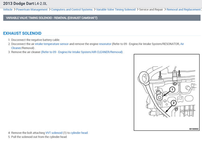

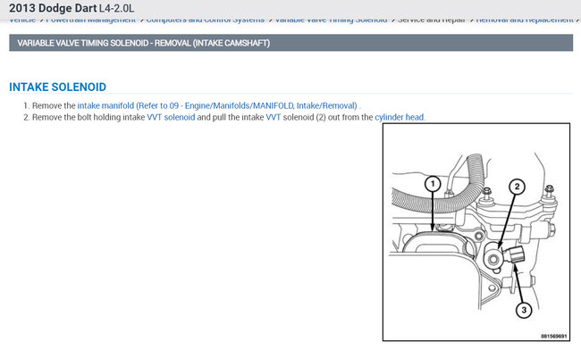

Where is the Variable valve timing solenoid located, replacement?
114,000 MILES • 2.0L • 4 CYL • 2WD • AUTOMATIC
LZTRUJIL
Can't seam where to find the location of the variable valve timing solenoid. Just need some guidance.
Apr 20, 2023 at 2:59 PM
  • 55,710 POSTS
There are two of them, one on either side of the cylinder head near the front of the engine. Check out the images (below). Please let us know if you need anything else to get the problem fixed.
