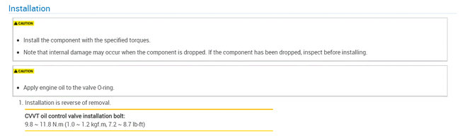

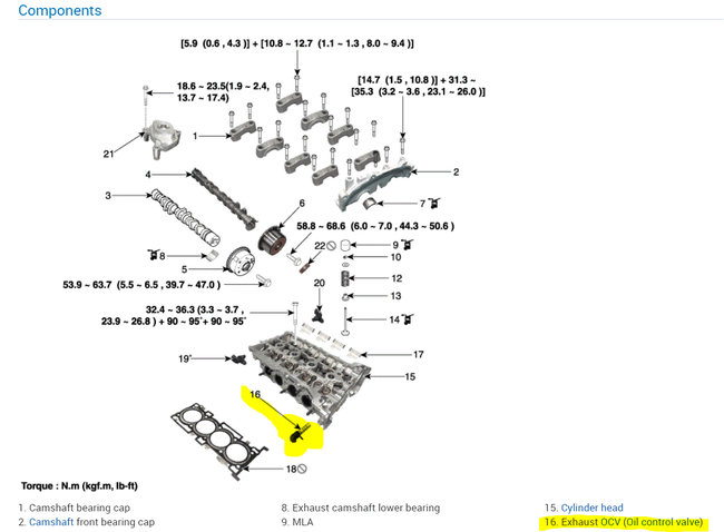

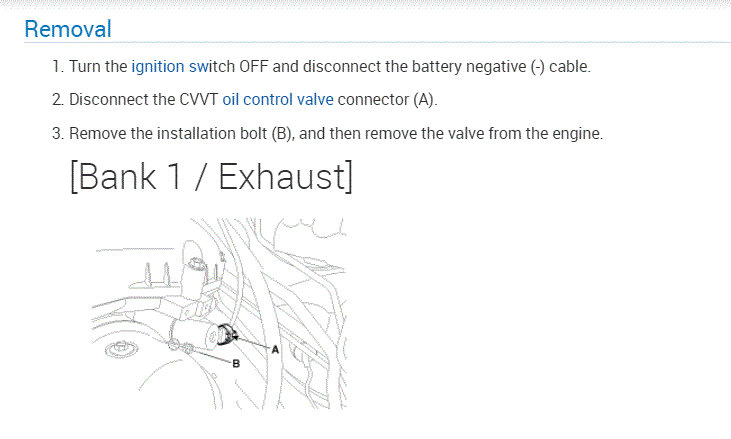

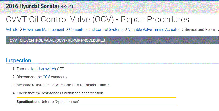

Variable valve timing solenoid Between 60 and 120, loss of power shifting abnormal check engine light is on. replaced cam shaft position sensor, replaced exhaust VVT sensor solenoid. would like to know the location of oil control VVT solenoid.
Apr 15, 2022 at 1:24 AM
  • 110,248 POSTS
The ol control valve is in the cylinder head. See pic 1 below.
As far as replacement, I attached the directions below. Take a look through them and let me know if you have any questions.
