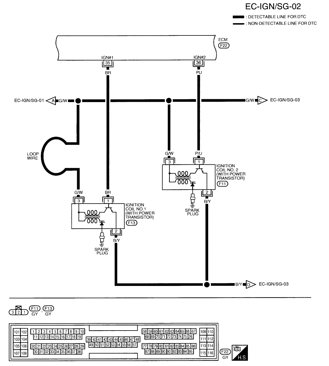

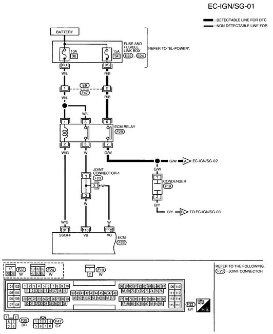

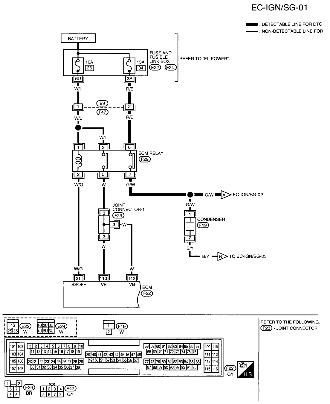

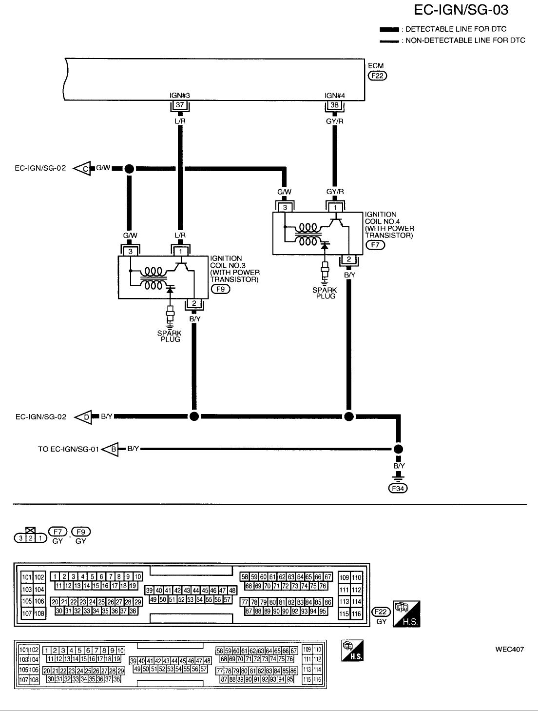

REDGITTL
looking for the color of the three wires for coil 1,2,3,4. do you have that? Changed the ECM but need this before I connect temperature sensor. Thanks in advance.
Aug 26, 2017 at 4:35 PM
STEVE W.
  • 15,378 POSTS
This is the ignition wiring.
