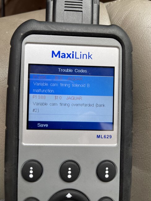

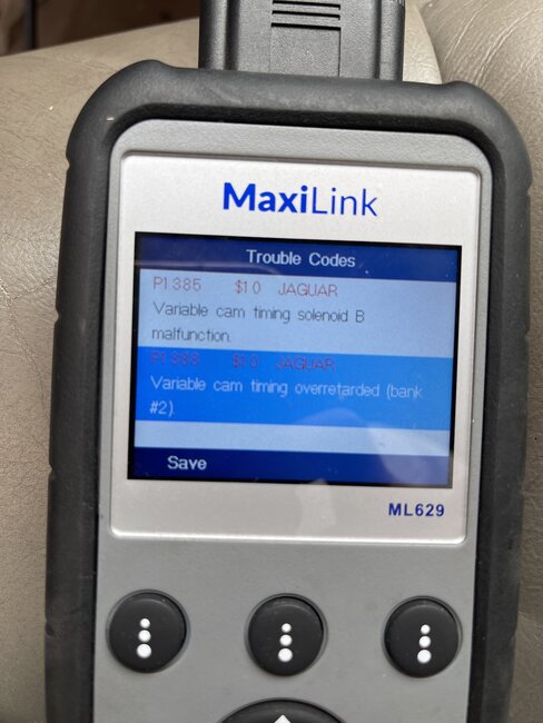

Variable cam codes p1385 and p1388?
2000 JAGUAR S-TYPE
98,000 MILES • V6 • 2WD • AUTOMATIC
BHAMDOC1973
  • 2,007 POSTS
No symptoms. These 2 codes popped up.

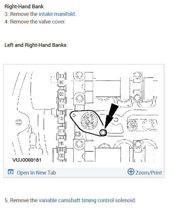

So, with these codes the first code will cause the second code. I would make sure the engine oil is clean and full, and if so, I would change out the camshaft oil control valve.
P1385: Variable Camshaft Timing (VCT) Solenoid B Circuit Malfunction (Bank 2)
P1388: Variable Camshaft Timing (VCT) Over-Retarded (Bank 2)
Here is the location. Bank 2 is the left side of the engine. Check out the images (below). Please upload pictures or videos in your response of any problems so we can see what to help you with.

Oil looks good but i think its overfilled. I will suck some of it lit and clean the valve first. Left side, you mean on the passenger side? Is the valve under the valve cover is what you saying? The one on top?
Sep 29, 2024 at 4:49 AM
  • 55,433 POSTS
Yes, bank 2 is on the left side of the engine. The valve should be sticking out of the valve code. The valve might have a clogged oil screen you may be able to clean.
