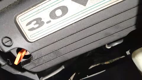

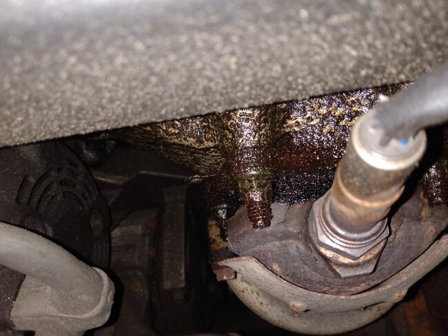

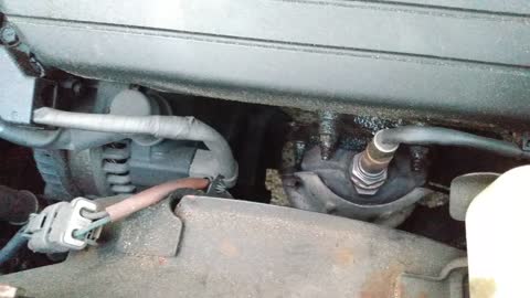

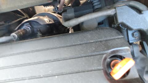

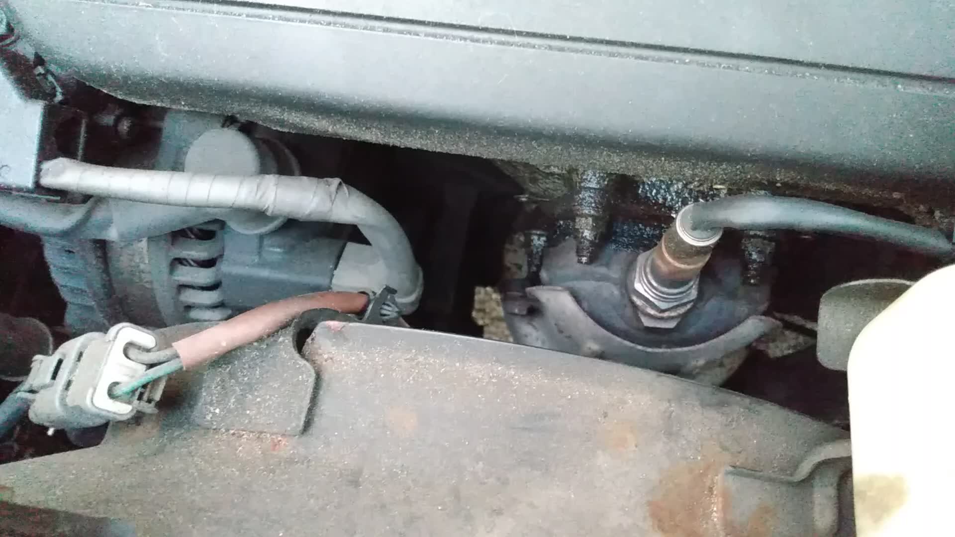

When it comes to cars, I know how to drive and that's about it so please forgive my ignorance.

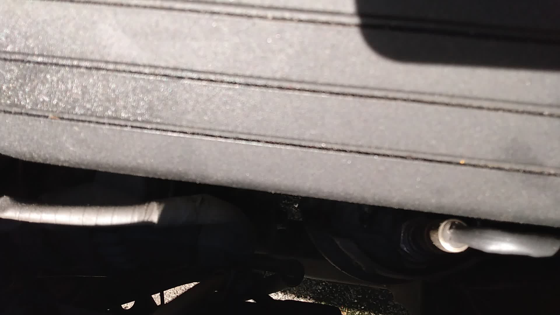

I noticed there is white smoke under the hood, which seems to be coming from somewhere near the valve cover. I can't see the vapor with the hood down, and there is oily residue coating the surface facing front. I thought it might be the head gasket (see my previous posts). However: There doesn't seem to be any oil loss and the color is fine. The coolant level and color in the overflow tank has been the same (perfect) every week. The exhaust from the tailpipe is fine. Can't test compression, but acceleration is great. I ran the engine with the radiator cap off- zero bubbles, looks perfect. Temperature gauge perfect forever, no variation. No visible leaks of any kind making it to the ground. Considering age and mileage, car is driving great.
I am including a photo of the oily buildup and three videos of the smoking in action. Thanks in advance.
Dean

There is an oil leak that is getting on the catalytic converter and exhaust. That is smoke from the oil burning off.
Have you checked to see if the engine oil or transmission fluid is low?

Both the oil and transmission fluid levels are reading full. Also, the transmission seems to be shifting fine. I am only putting 15-20 miles per week on the car.

We need to determine what fluid is on the exhaust. Is the power steering fluid full? Is the engine coolant low? Something is leaking. Based on the location, I would have thought a valve cover was leaking oil onto the exhaust.

Valve cover gasket sounds right to me. I think it's a very slow oil leak from a very lightly driven car. Even though the stick reads full, it easily could have been more full just after my latest oil change last Nov.
I fed the same info I initially gave you (including the pic and several stills from my vids) to GBT-4o, and asked for its most probable cause... It replied valve cover gasket. If an expert mechanic and cutting edge AI agree, that's good enough for me.
Do you think it's safe to run a few errands before I bring it in for repair next week?

If that is what is leaking, it should be okay to drive. Just remember, oil can burn, so don't run it very hard. You don't want it to get really hot if the oil is reaching the exhaust manifold.

Just wanted to let you know I brought my accord in to my mechanic- it was the valve cover gasket. Had both of them replaced; $438 + tax.
