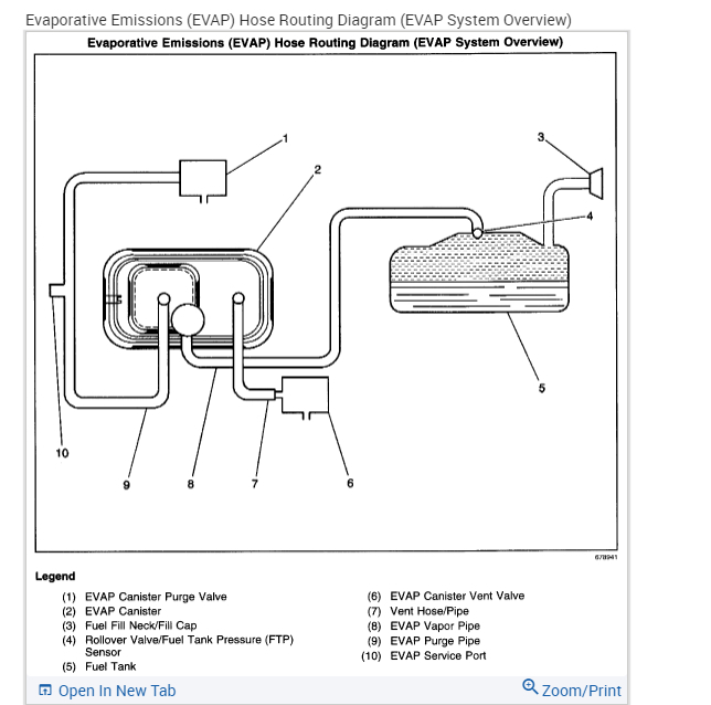

I want to change the hoses to the vapor canister and I need to know the size (diam), type and length to get.
May 18, 2020 at 6:01 AM
I attached a link to a popular parts website that shows your various hoses. I also attached a diagram of the system. If it were me, I would pull the lines off that you want to replace and then just go to the parts store and get bulk hose in that size and then you can get the correct length as well.
https://www.rockauto.com/en/catalog/gmc,2002,sonoma,4.3l+v6,1386042,exhaust+&+emission,vapor+canister+vent+hose,22172
I looked it up and the manual doesn't list these hoses individually so I can't send you each part number but again, you just need to use a vacuum hose to connect the lines so I would just use the bulk hose at the parts stores.

MIMI VEE
  • 11 POSTS
well this is a twist. I'll briefly give you the full story: on 5/5 the engine lite came on, on 5/6 I replaced the 3 vac hoses on the driver's side up near the firewall (improved performance but light still on)5/12 had diagnostic checked at AutoZone indicating 'small leak' in vacuum can so, instead of jumping into a high cost purchase/repair I decided to go the conservative route and replace the hoses to it however (here's the twist) yesterday I went to Walmart (light on) but on the way out of Walmart no engine light. I made several stops and still no light so go figure. maybe the vacuum pressure built up after the hoses were replaced (they were in really bad shape and one had two holes in it) also on Tuesday I removed the gas cap, cleaned it and put Vaseline on and around the o-ring and on the neck of the fuel fill. it would seem I have a mystery car on my hands! for now I guess it's fixed. fingers crossed.
May 22, 2020 at 1:33 AM
Haha. That is great. If your issue was a small evap leak then yes, the gas cap is the most likely cause. Either way, it doesn't matter at this point. Good work. Glad it is working out for you.
If it comes back on, pull the code again and let me know what it is and we can work through it. Thanks

The code that initially came up on the scanner was PO-442. I plan on using the truck today so here's hoping your feeling is spot-on and that the issue is automotive history! I'll let you know when I'm done driving for the day.
May 24, 2020 at 12:05 AM
Got it. Thanks for that. Keep us posted because I am feeling positive on this one.
May 24, 2020 at 1:05 AM
MIMI VEE
  • 11 POSTS
And the good news is, with all the off/on driving the lite never stayed on. Problem solved, but mystery remains. Was it the hose replacement or the gas cap trick? But bottom line is it only cost $5.00. And change for one length of hose which i tri-sected (they were all connected by a 3-way t-connector). Your positive feeling was not wasted. But now i do have to ask if you're a mechanic or someone who knows his way around cars? Regardless, you hung in and it's appreciated.

I was a mechanic and now I am an automotive service engineer with a US auto company. Basically that just means when mechanics at dealership can't fix a vehicle I talk them through it via either email, phone, or visit the dealer on the really hard ones. So doing this just fits right in with my career.
My money is on the gas cap. So if it ever does come back on with this code, I would go to the gas cap first.
