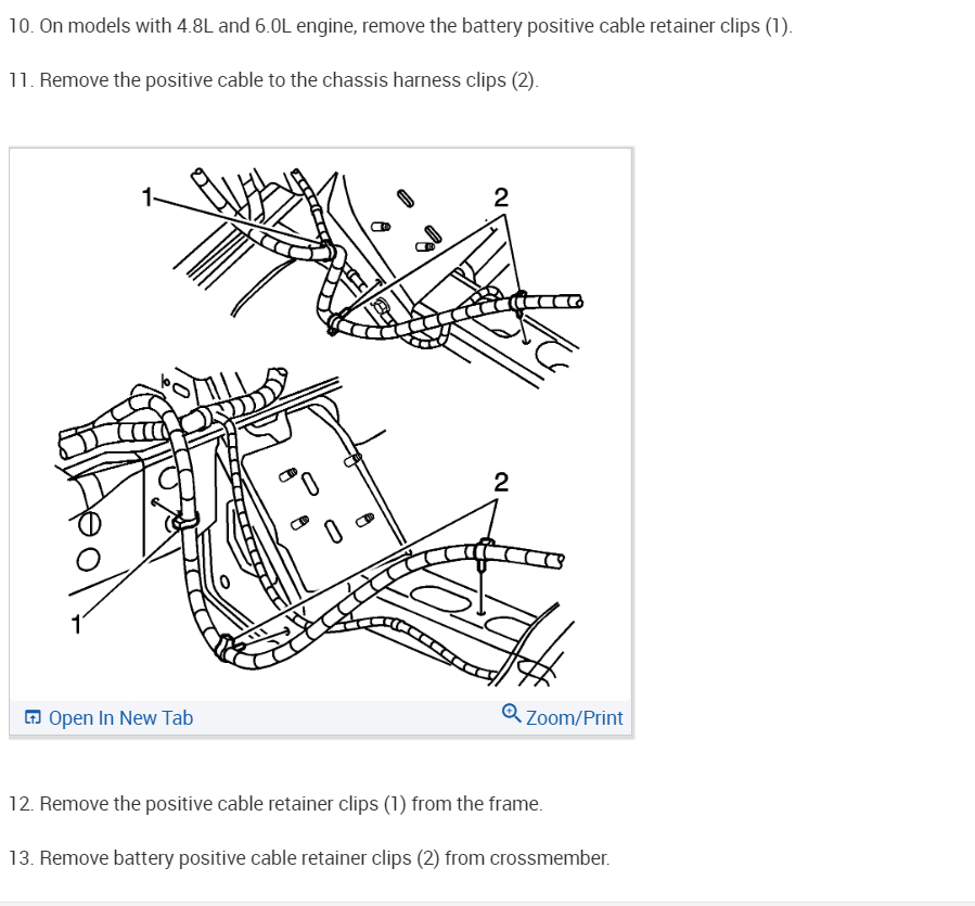

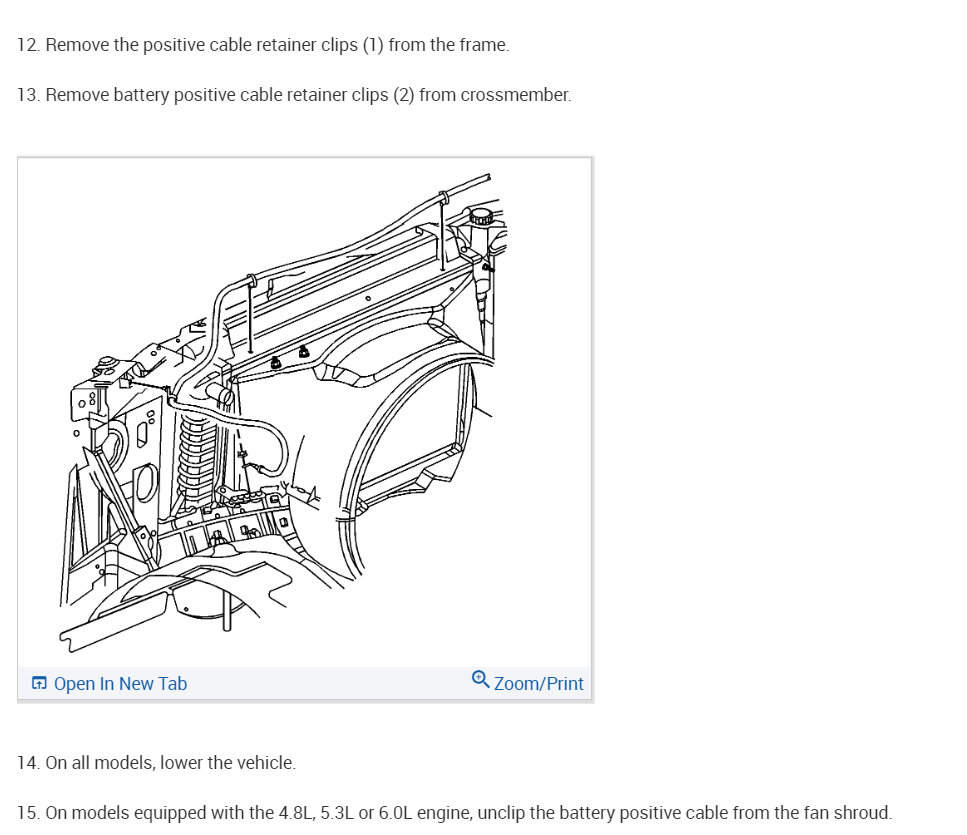

When trying to start the van the dash lights will come on but when I turn the key forward i hear a click and they go blank. Battery is one year old and starter just replaced. All connections are tight and clean.
Sep 27, 2022 at 8:18 AM
  • 55,433 POSTS

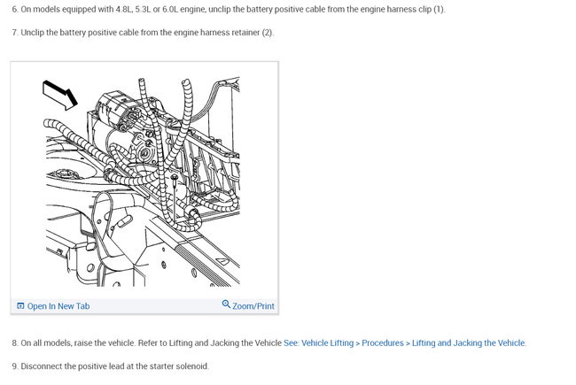

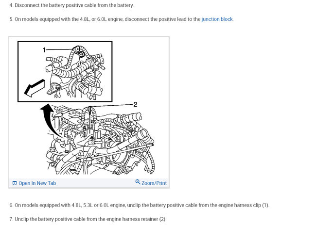

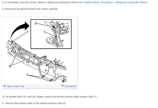

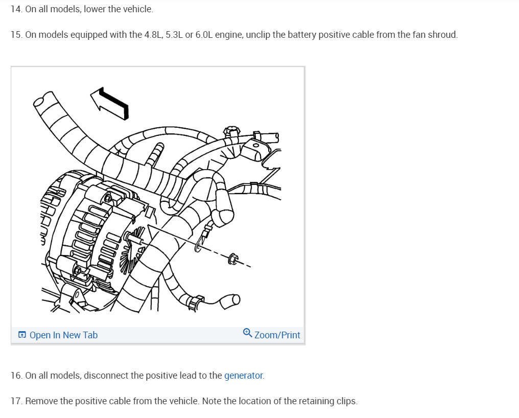

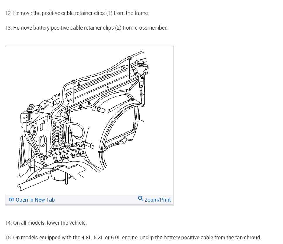

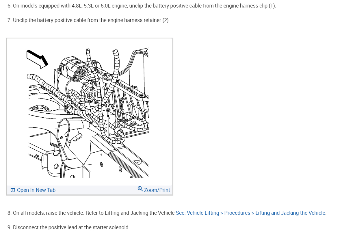

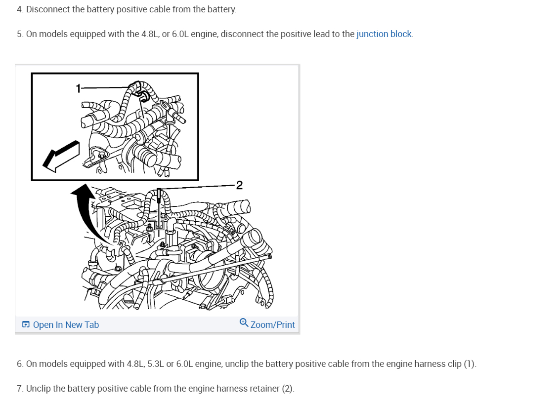

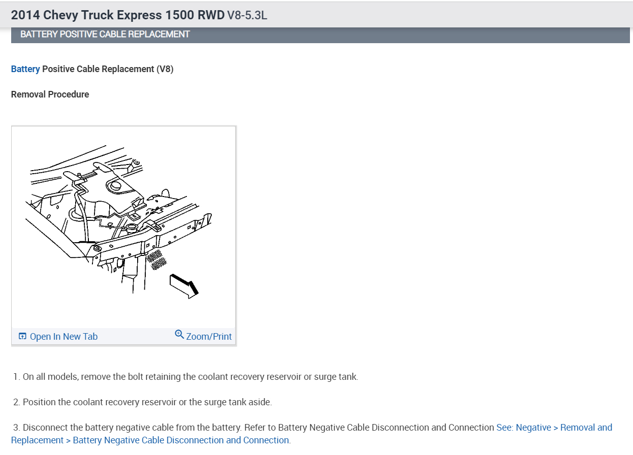

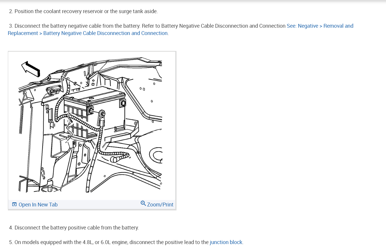

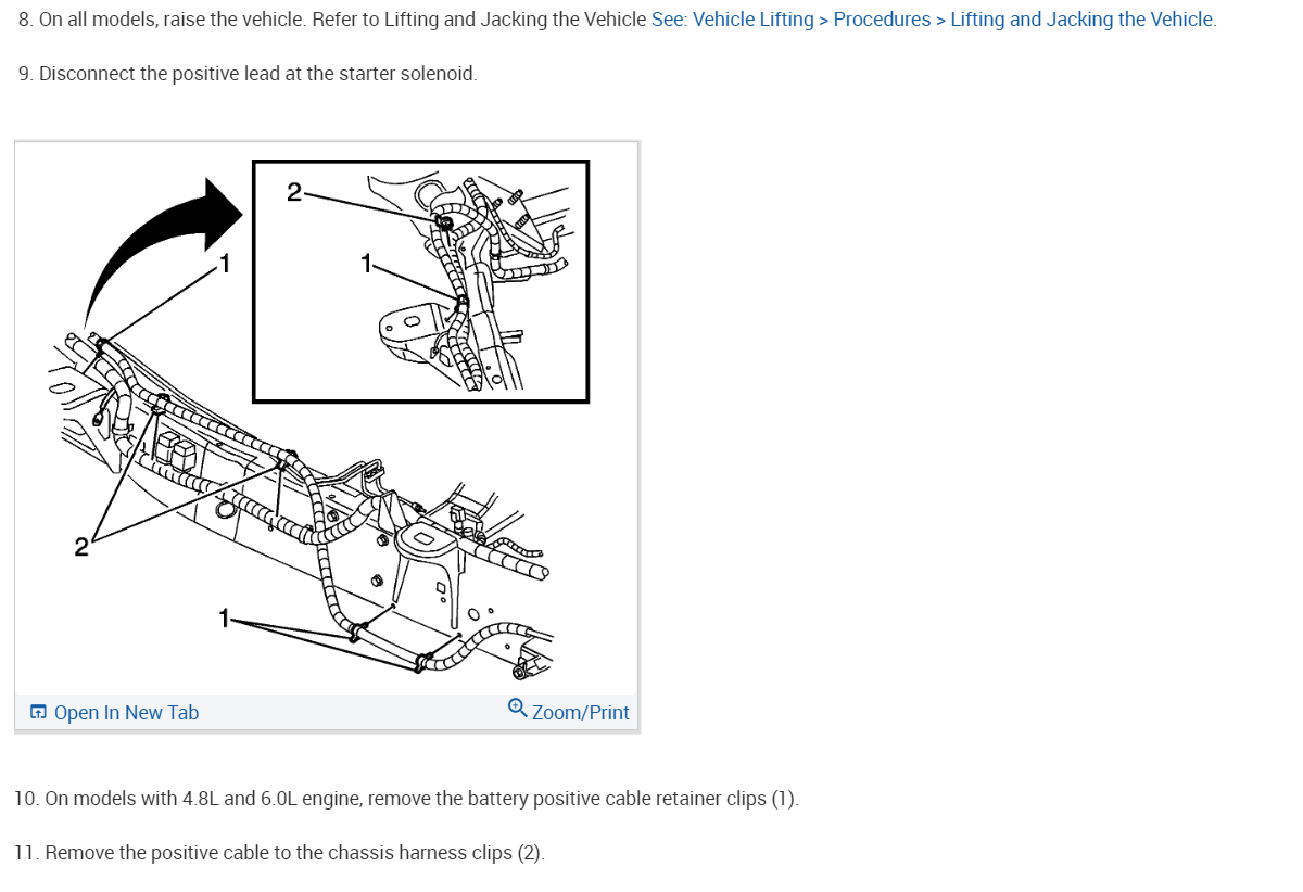

It sounds like you are losing connection at the positive battery cable. Here is how to change it out to fix the problem. This guide can help as well:
and
Check out the images (below). Let us know what happens and please upload pictures or videos of the problem.
