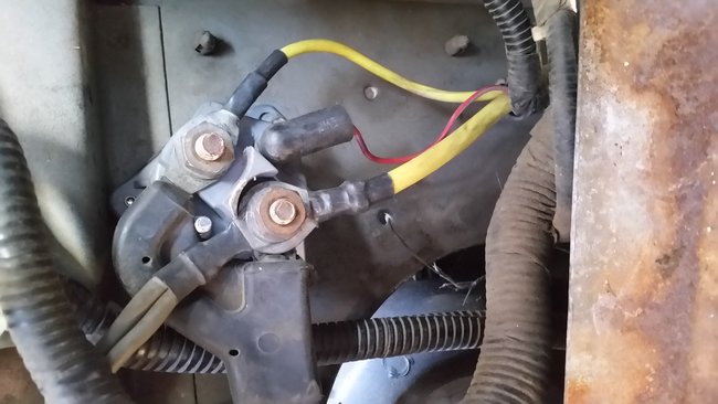

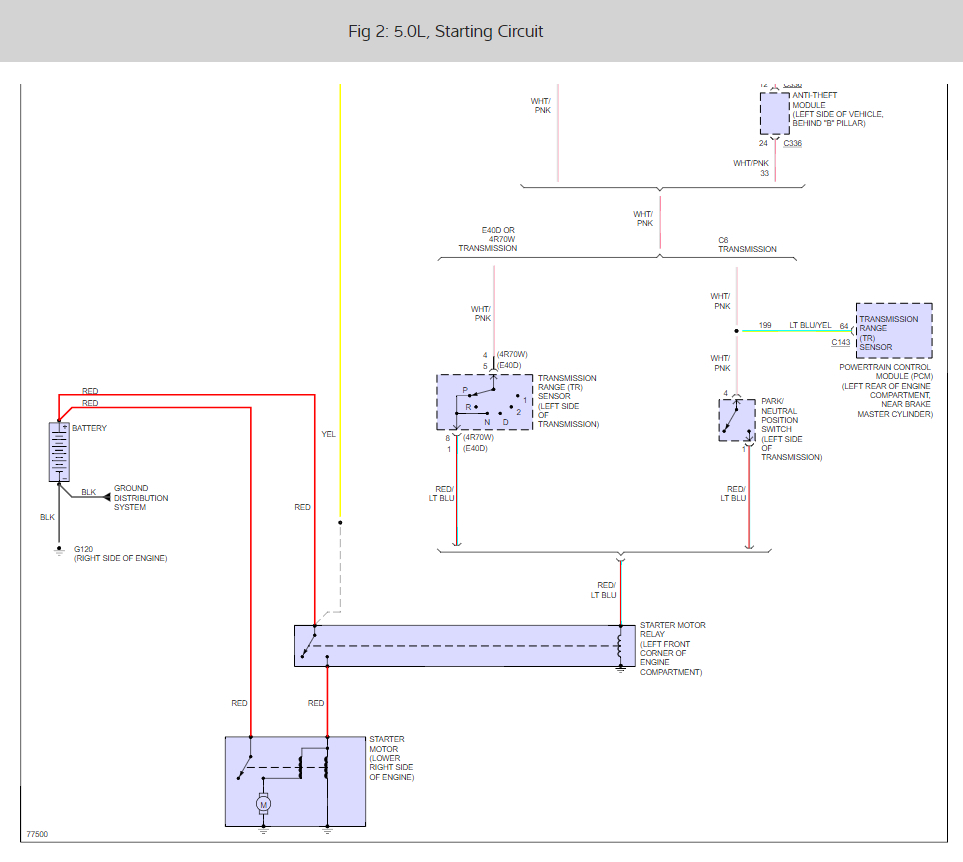

Had this vehicle for some time, but never used it. Installed new battery and tried to start it. First four to five times the starter solenoid clicked but did not turn over, then it did. seemed like it was starting (very rough as expected from lack of use), shut off and from then on, it would just click but nothing. Replaced solenoid next to battery, reconnected cables to original positions on solenoid, reinstalled battery (positive cable first), turned the key, got one click and then nothing from then on.
Disconnected negative battery cable and pulled, tested and cleaned blades of all the fuses in the power dist box, as well as tested all the fuses under the dash.

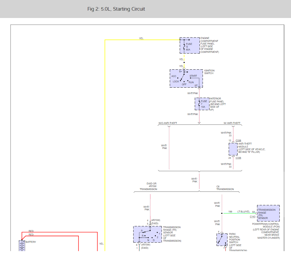

It sounds like you have a starter motor or battery cables that are going out. To be sure use a test light on the power wire down to the starter to see if you have power when the key is being cranked over. If power is there then I would replace the starter motor.

Below are some wiring diagrams to help us do additional testing to figure out the problem.

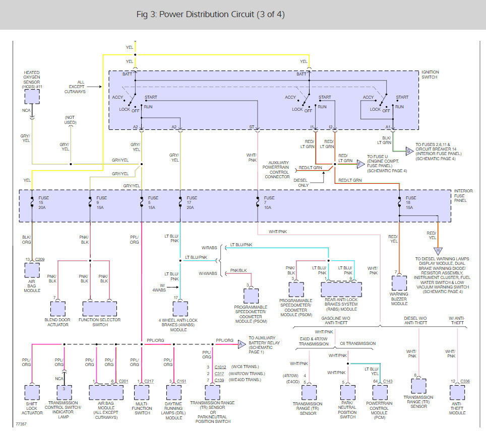

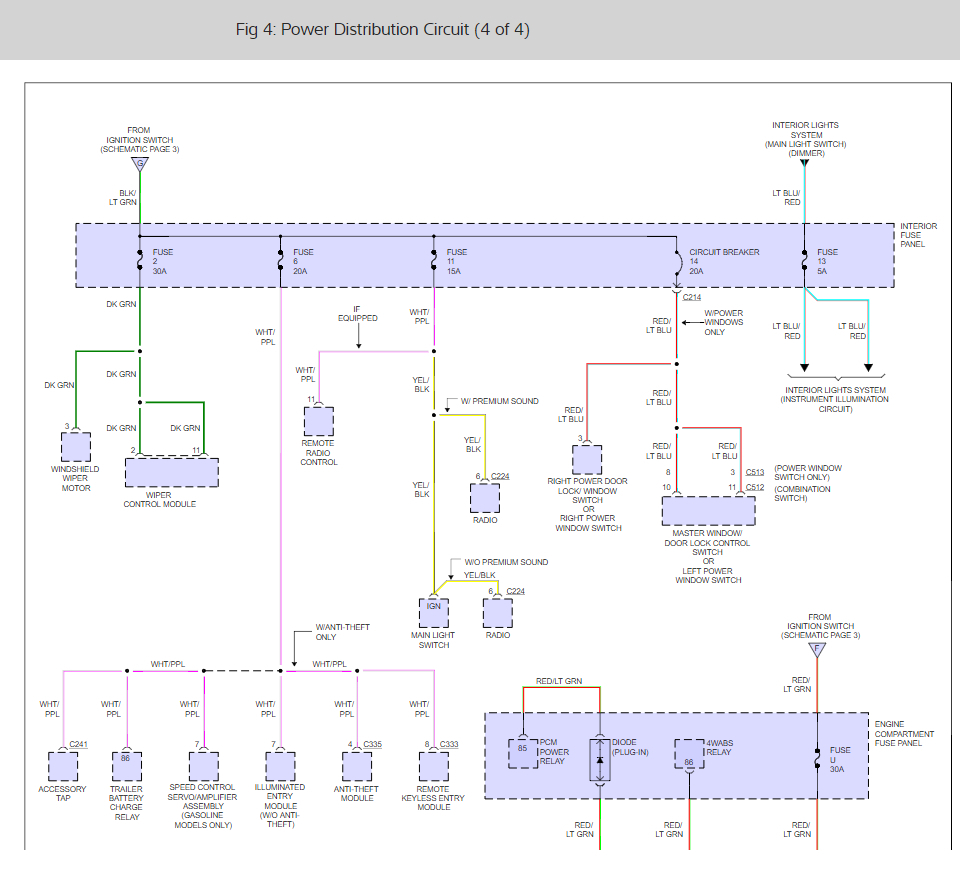

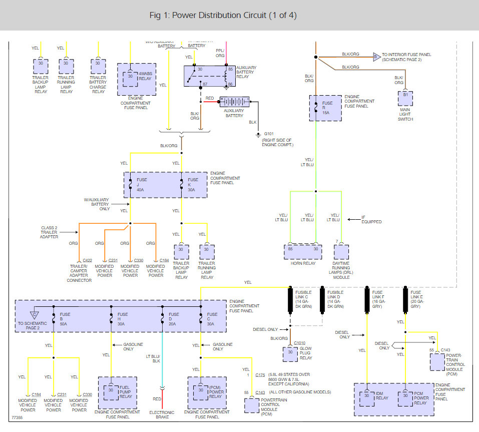

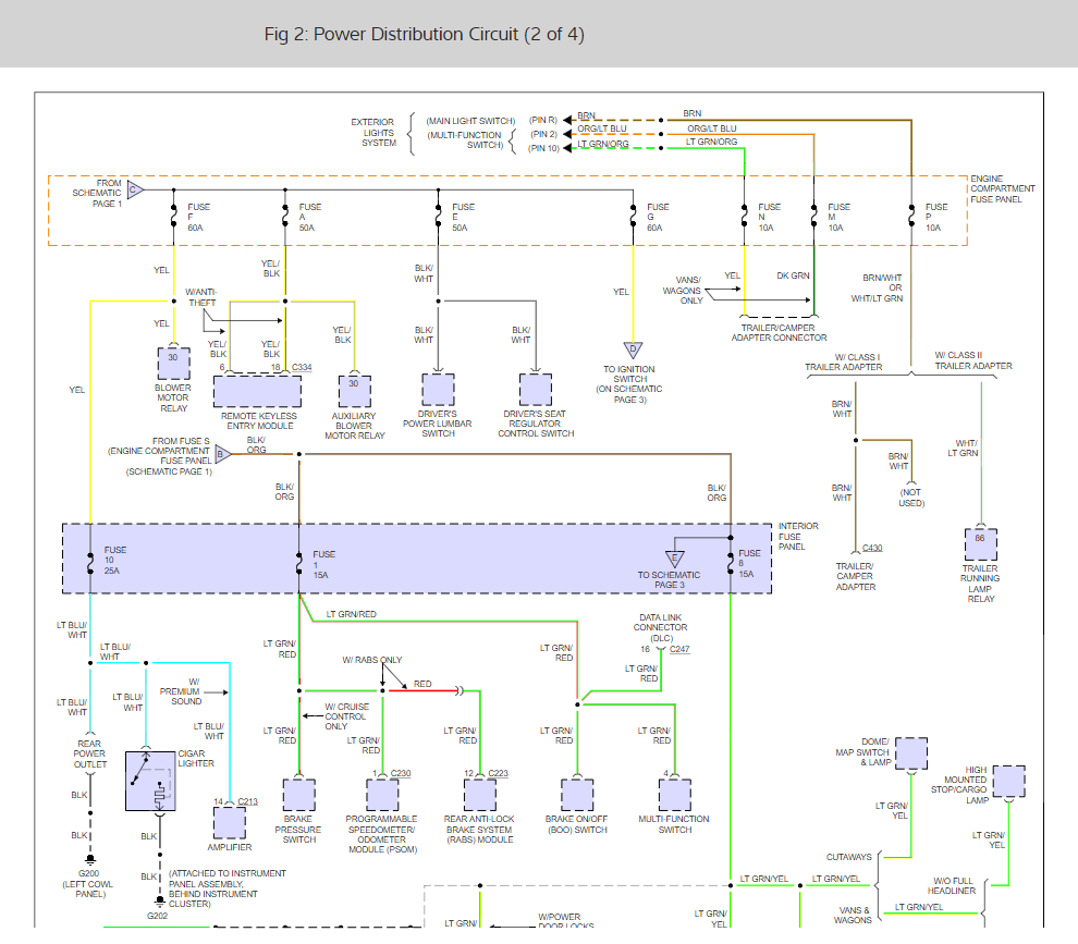

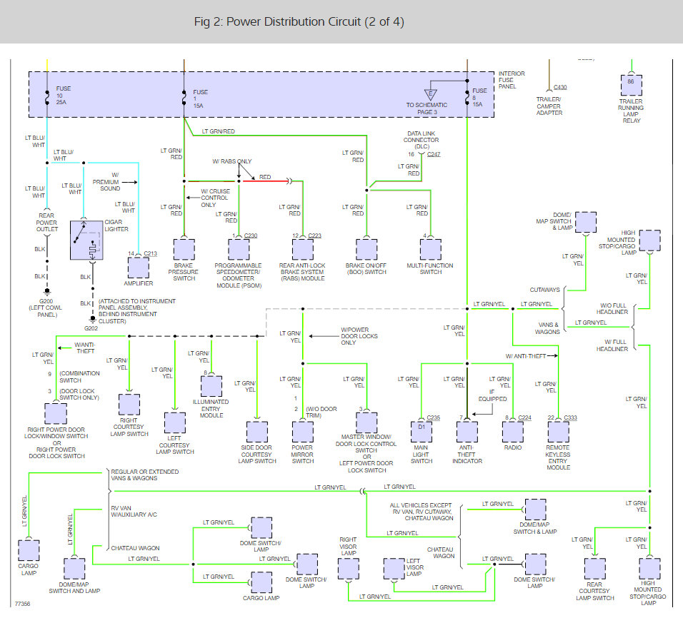

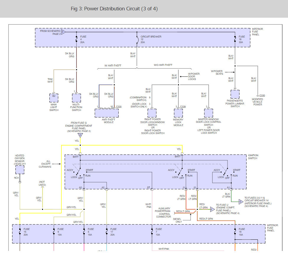

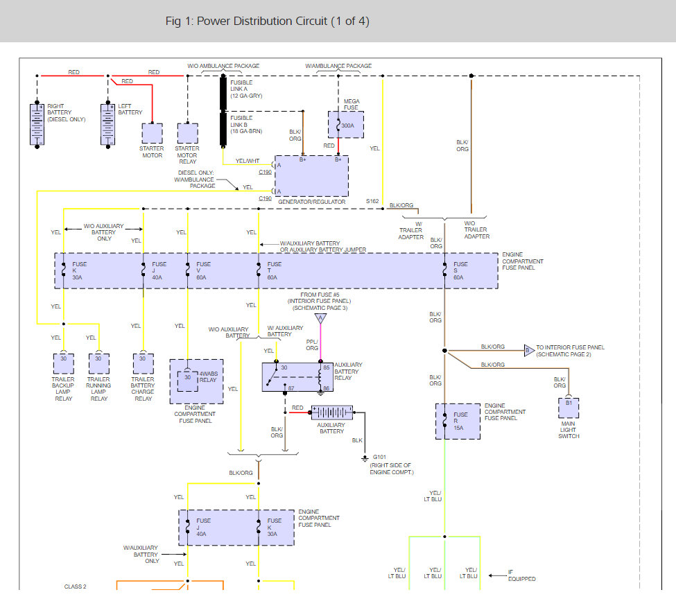

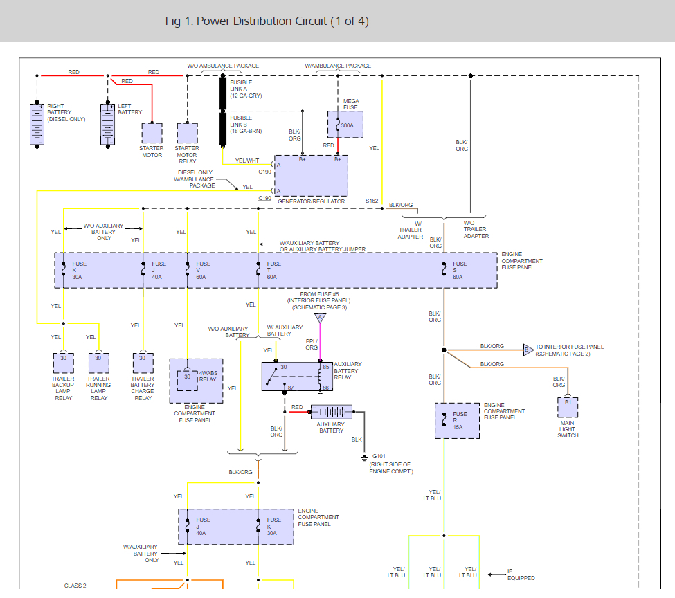

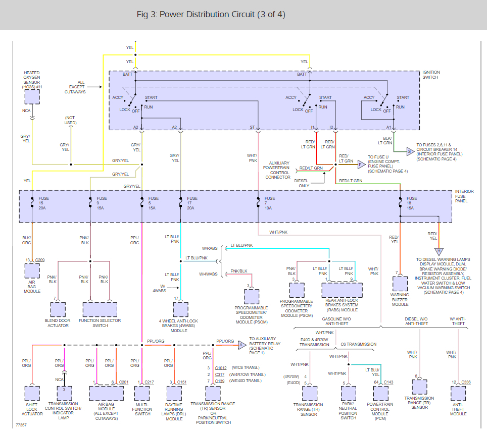

Thanks Ken, Think this one may to be a little more complicated. The starter turns fine when I jump power to the output side of the solenoid. What I have determined is there is no power to most of the fuses in the Power Dist panel. Using a test meter, I checked both sides of all the fuses, and only a couple showed power. The G fuse for the Ign. switch is dead, as are the others that are not ignition switch dependent. The horn, lights, etc, work.
Is there a fusible link before the PD panel or something of that nature? Trying to get access to the PD panel to debug is near impossible. I've ordered the Factory Wiring Diagrams manual for the vehicle but it is a few days out.
Thanks,
Todd
Oct 2, 2017 at 3:28 PM
  • 55,676 POSTS
I have all the wiring diagrams you need.
Here are the power distribution diagrams to get you started.
It sounds like you have as fusible link that is out.
Please let us know what happens and upload pictures or videos of the problem.

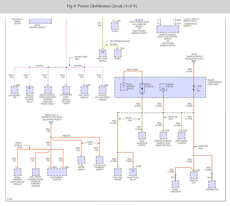

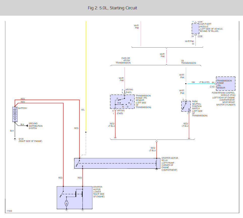

Well, got the engine running, but now none of the lights, horn, or other components that are serviced by the PD panel fuses S, T and V (not worrying about the trailer circuits at this point). These circuits get energized when I move the small yellow wire on the Starter relay to the side with the battery cable. Of course the starter also wants to engage when I do.
Thanks,
Todd
Oct 4, 2017 at 6:26 AM
TCROSIER
I made a mistake, the little yellow wire needed to go to the battery side of the relay. The only wire on the starter side of the relay is the red wire side of the Y connector. All fixed. Thanks for providing the PD diagrams, they helped.
