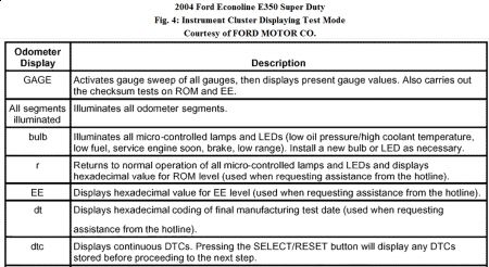

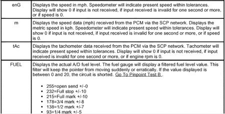

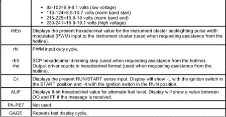

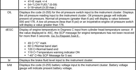

Could be the GEM, or the cluster itself, try this dealer test mode, write down any and all codes displayed. INSTRUMENT CLUSTER DEALER TEST MODE To enter the Instrument Cluster Dealer Test Mode, press and hold the instrument cluster SELECT/RESET button and then turn the ignition switch to the RUN position. Continue pressing the SELECT/RESET button (five seconds) until test is displayed in the odometer. The SELECT/RESET button must be released within three seconds of the odometer displaying TEST to begin the dealer test mode. Depress the SELECT/RESET button to advance through the following steps until DTC is displayed. Depressing the SELECT/RESET button will display any continuous DTCs stored before proceeding to the next step.

The Dealer mode test didn't work: the odometer doesn't have power so nothing even lights up.
