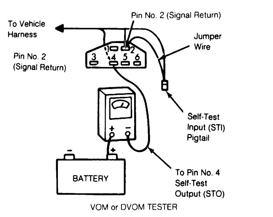

My van quit on me when I was backing into the driveway. I checked it it had no spark coming out of the coil. I replaced the coil from a video I saw still did not start. so I went and got another coil and it still would not start. everything works on the van it just will not run.
Jul 23, 2017 at 6:16 AM
HMAC300
  • 48,601 POSTS

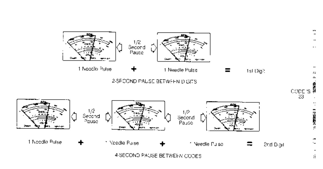

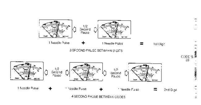

Scan for codes first and if any show up get back to us with the code. Use a volt meter service engine light may flash as well. See pictures on how to do it. Second picture shows a code 23 what it looks like on a volt meter.
