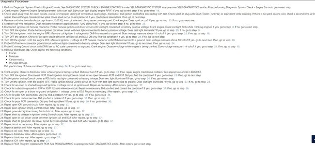

PATENTED_REPAIR_PRO
  • 1,853 POSTS
No, the coil is not usually replaced when doing a tune-up, only if it's bad. I have to ask, cause I have seen it, did you forget to install a rotor?
Did this problem happen immediately after the tune-up?
I am assuming the coil is inside the distributor cap? If it was, there would be no secondary coil wire. You may have a faulty ignition coil or maybe even a faulty ignition control module. First though confirm that the pink wire has voltage to it with the key on run/ engine off that check the coil.
Here are some tests and note the ignition control module can usually be tested at an autoparts store once you remove it and take it in.
