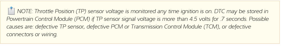

I have a Grand Voyager that cranks but wont start. no spark on two and five. Only codes is a PO123. I have replaced the crank sensor, cam sensor, throttle body, fuel pump, plugs and wires, and the coil pack. What could be the problem? Any and all help will be greatly appreciated.

the code may have been stored in computer so see picture for what causes are. for the no start try resetting security system as that may be the problem see link.
