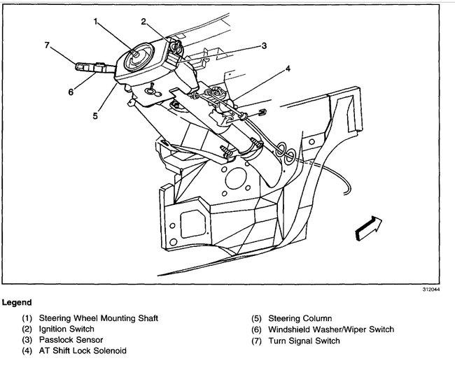

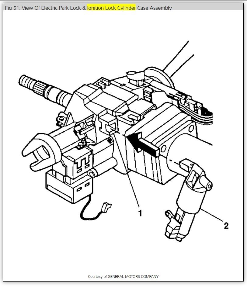

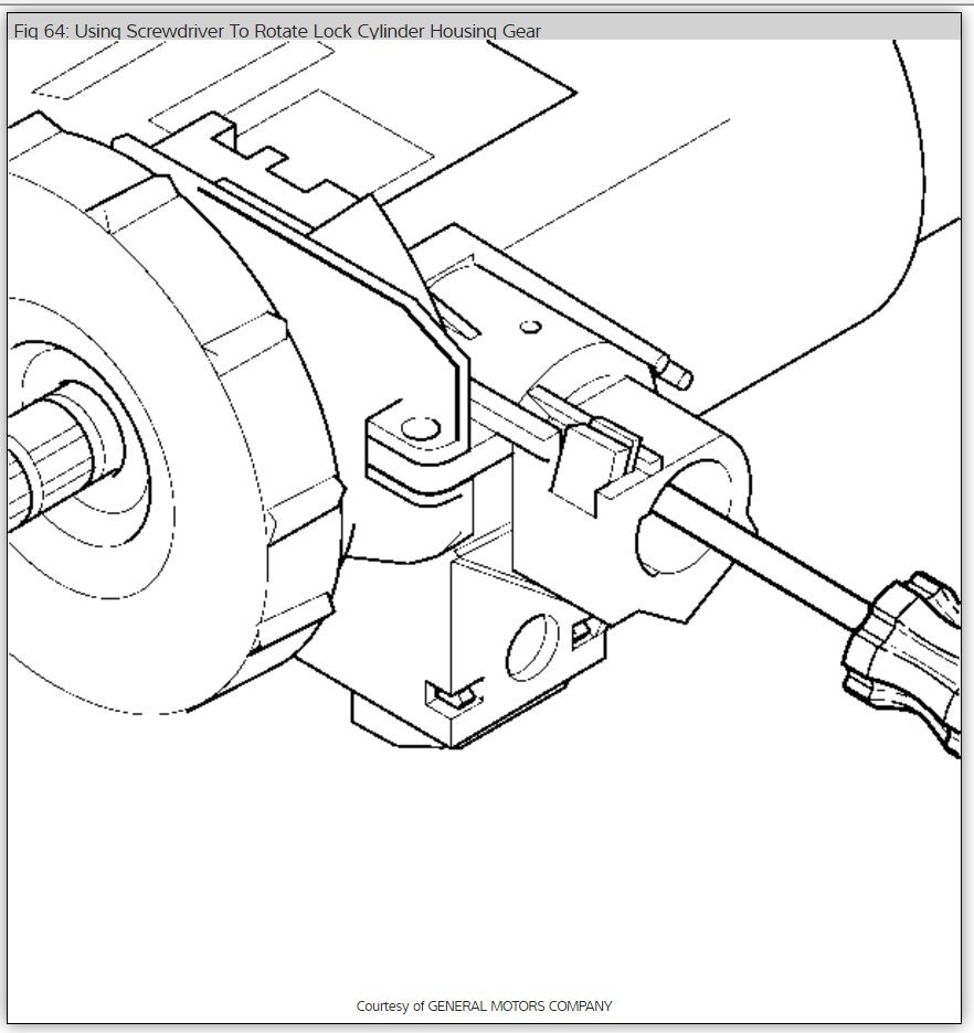

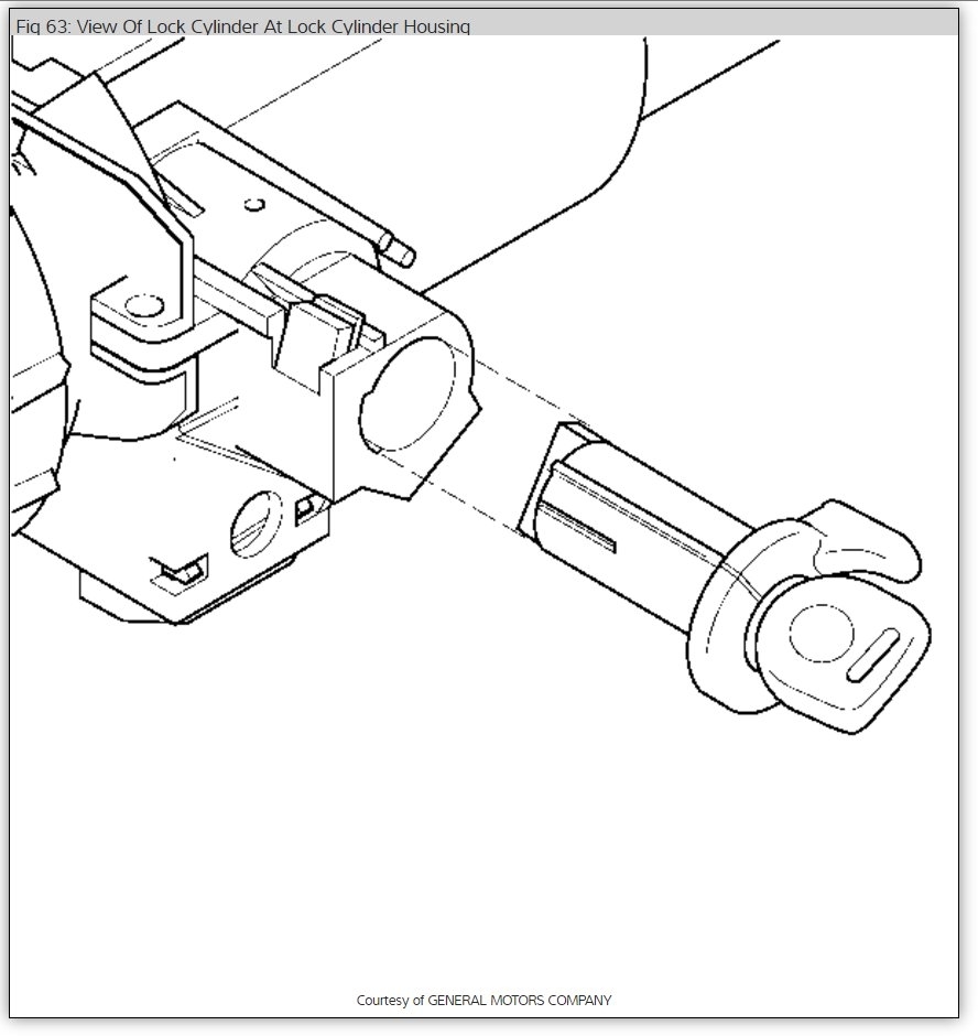

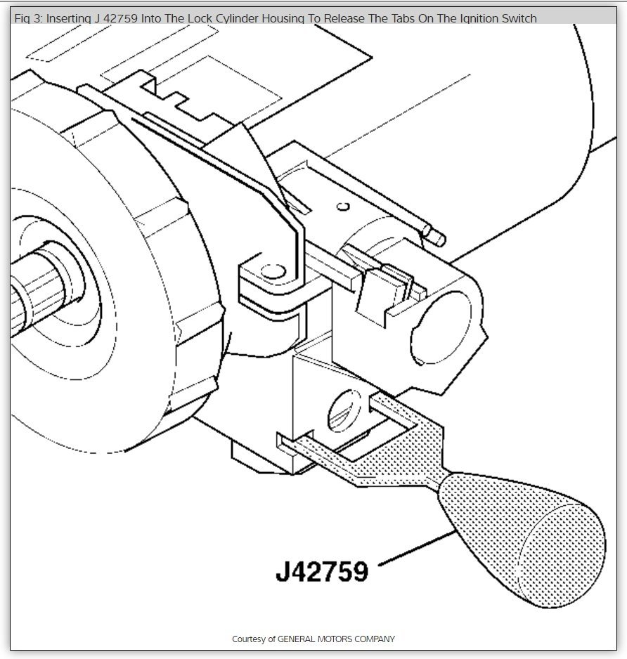

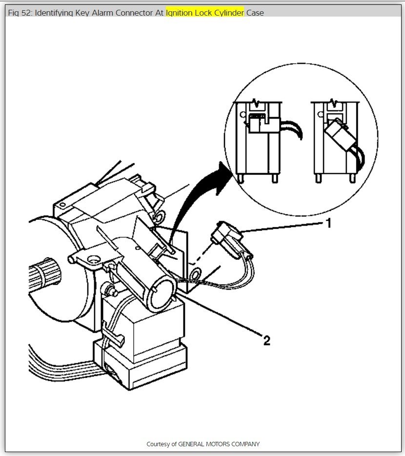

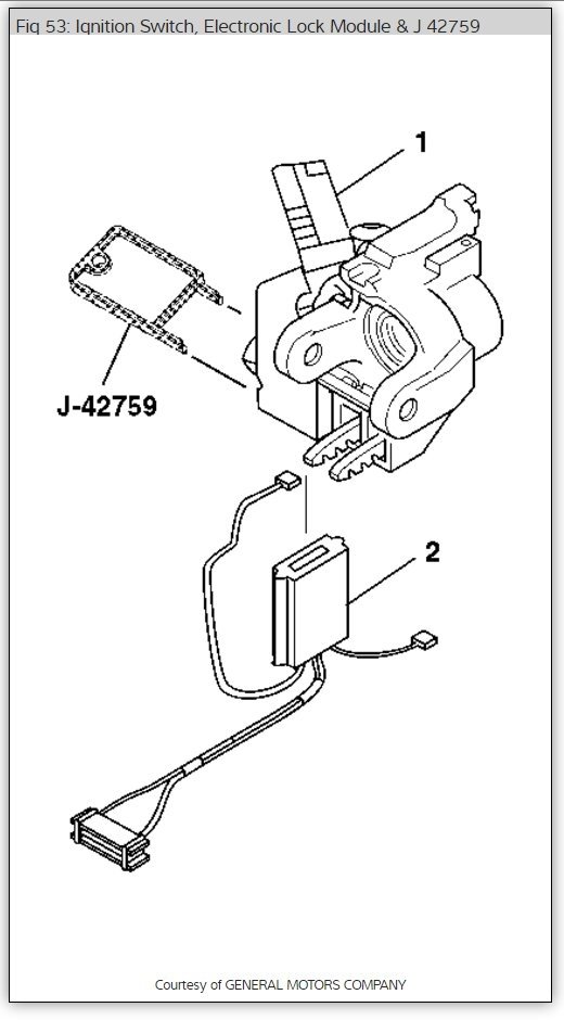

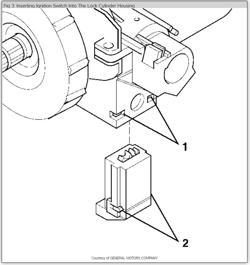

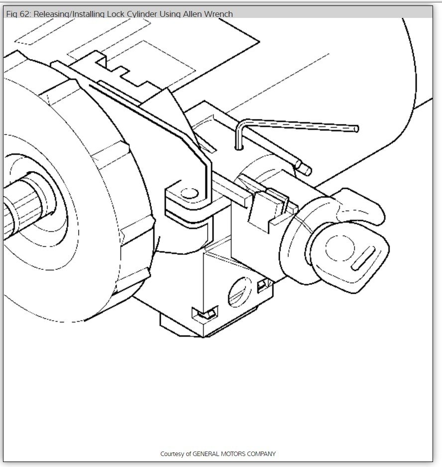

It sounds like someone has taken the tumbler apart so the lock does not work. You will need to replace the ignition tumbler to fix it.
Here is a guide on what you are in for when doing the job (below).
You may need to get the new key coded by a shop or the dealer to complete the job.
Please let us know what happens and upload pictures or videos of the problem.

Okay, that makes sense. I am planning to work on it tomorrow and will let you know. Thanks for the diagrams, that helps! :)

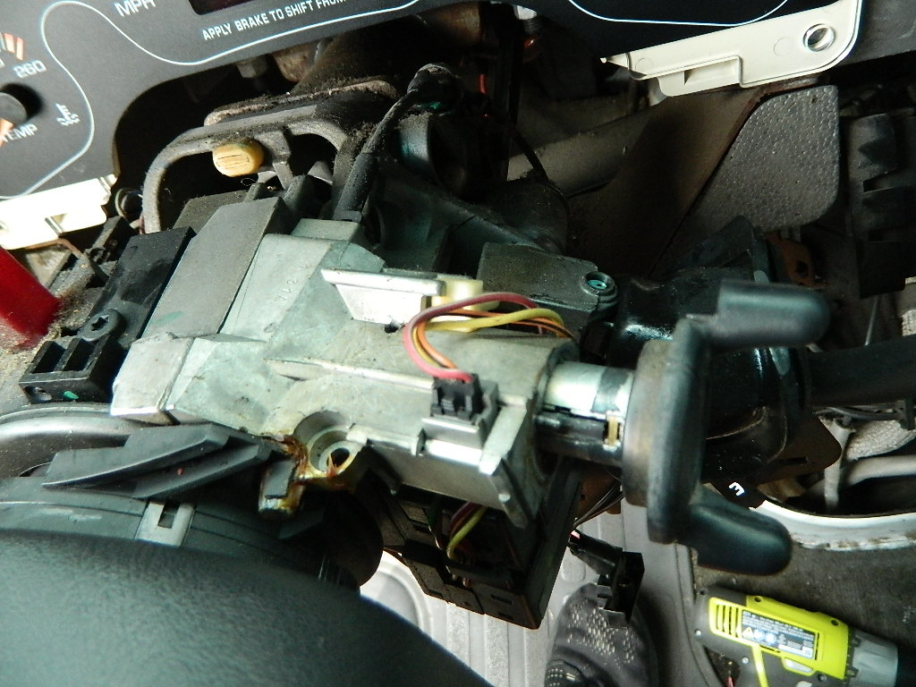

Hi Ken, thanks for your help on this; Today, I replaced the lock cylinder (it didn't look too bad, no broken pieces) and the van starts up and runs, shifts normally; however, when I turn the key off, I still cant turn it past the ACC position (3)with Odometer light on, but now I can't take the key out at all...still have the issue of shifting without the brake pedal.
There are 5 positions for the key (according to owners manual): (1) ACC-A, (2)Off/Lock, (3)ACC, (4) Run, (5)Start; the van only starts in Park and Neutral, so i don't think its the Park/Neutral switch or loose cable.
I'm thinking the problem might be the BTSI solenoid keeping the key magnetized somehow, but not quite sure. Could it be the ignition switch? Is there anyway to test these? I did not perform the 'key re-learn' procedure since the van started up with not problem - not sure if that is necesary.
Thanks so much!
Kevin
Oct 3, 2017 at 2:45 PM
  • 54,837 POSTS

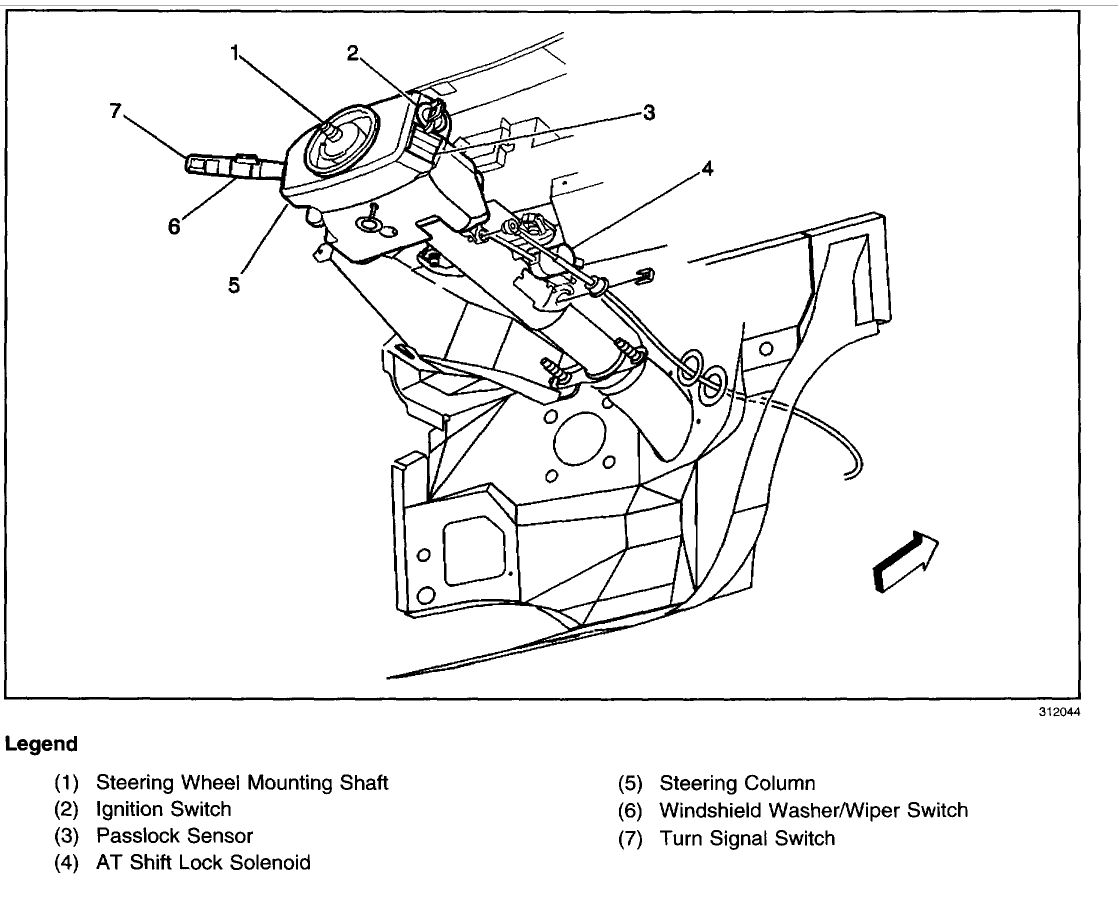

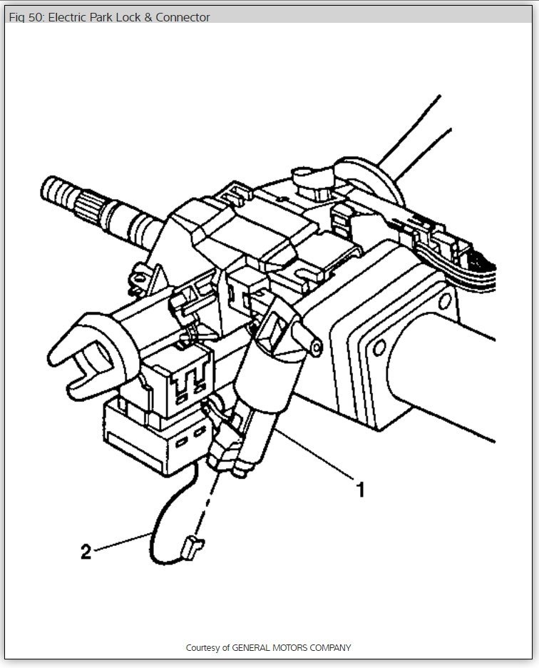

Nice work thanks for the pic, there is a shift interlock cable that sound like it not moving like it should. Try to disconnect it and see if that fixes the problem then we can go from there to get it fixed. Here is a diagram of what we are talking about

Well, Ken, as I was about to disconnect the shift interlock cable, I started moving the gear handle up and down very slowly, watching everything operate. As I put it in park, Shazaam!, the arm somehow locked and I coulndn't move it at all - I was able to move the key to the off and Acc position! And remove the key - i tested it a few times and what I found is when the shifter arm is in park, the arm needs to be pushed forward just a bit, where it will stay; that little move apparently locks the gear handle, unlocks the cylinder and key can be turned and removed. Go figure!
I actually have a 01 Suburban with the exact same ignition system, but this movement happens automatically so I never noticed it - there must be a spring(or something) in place somewhere that is missing on the van.
Whew! That saved me a lot of time and money trying to figure that out - i was getting pretty frustrated! I was about to go out and buy a new ignition switch - LOL!
Do you have any clue about that spring? Any diagrams?
Thanks so much for the help!
