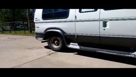

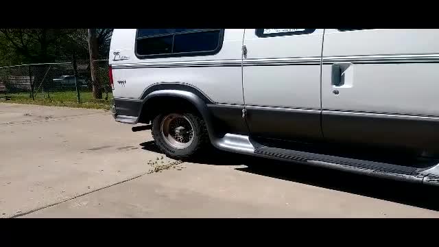

Okay, guys my van is acting up again.. my van is jerking when you drive forward and it makes this sound at idle as well. so far there are no error codes. I think it maybe the fuel filter or the fuel pump or both myself. The fuel filter has been replaced in 2018 but the fuel pump has never been replaced since i bought it. The sound i wanted you guys to hear is at the beginning of the video and close to the end of the video. I just wanted to know what you guys think before i start buying parts again etc. Hope to hear from you guys soon like always etc. :-)

the engine is hesitating (ranging of the RPM).... And it just does it at idle and going forward. For example you can put it in drive and then it will start doing it (not pressing the gas at all). But you press the gas it doesn't do it at all then (so far no error codes either) at any speed, at least not yet anyway (praise the Lord). When going in reverse it operates just fine too.

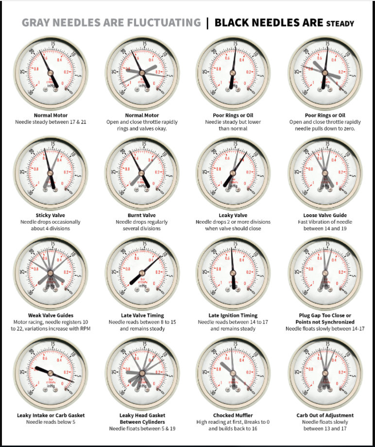

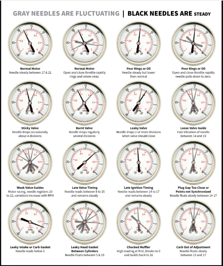

Here is the guide again but I would suggest stopping by a parts store and getting a vacuum gauge and hook it up to the motor through a vacuum line.
It may not be an external leak. It could be intake valves hanging open causing the leak. A gauge is the only way to show this. Attached is a diagram of common issues that are shown from the gauge.

April 24th, 2021 Update: Well, i took my van in and they repaired it. Turns out it was a leak under the intake manifold. Unlike last time i forgot to ask what the vacuum gauge read this time. But i do have a question though. Is it normal to fix a vacuum leak under the intake manifold so fast (under 2 hours)? Thank the Lord it runs good now and it doesn't make that sound like it did the video clip. Here is the break down on what i was charged just so if someone needs to know or want to know etc: Test and repaired vacuum 1. Whatever that meant charge was zero. Vacuum hose 1 of those was $2.00. And the labor is what gets me every time. But i have to pay it because i can't reach it (wheelchair) etc. Anyway, labor was $100.00. Total was $103.00. That includes taxable amount ($2.00) and sales tax (0.18).
