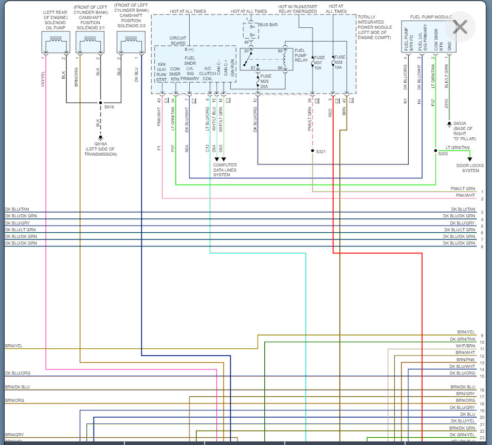

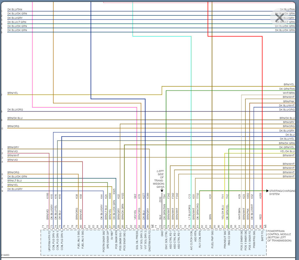

Let's start with the basics so we don't get too far down a rabbit hole.
Let's check the battery and make sure it is able to hold a proper charge because on this vehicle when the battery is weak all sorts of things can happen like this. Here is a guide that will help with the type of test we need to do. Most parts stores can do this.
I am thinking we could have an issue with the TIPM, but the most likely thing is a battery voltage issue, causing the TIPM to malfunction.
I am attaching the wiring diagram below that we will need to use to test this, but we will need to get it to act up.
Is this relatively easy to get to act up?

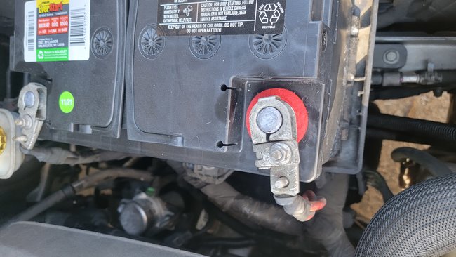

I did notice that the connectors to the battery do not sit tight on its tight on the battery. I've tried tightening them, but they are in all the way.

Can you get some pictures of the battery cables? You are correct that this is not the battery itself, but it still sounds like a battery related issue so that cable is something that we need to investigate.
Basically, there isn't one known thing outside a battery, a TIPM issue that would cause this, so we need to dig further.
This means we need to see if these cables are the issue.
When you are trying to tighten these and they are fully tight, can you still remove them without loosening the nut?

As the video shows a small amount of force is needed to remove the cable. However, the cable is snugged enough that it will not come off the battery. The pads are new just added when I did load test. Besides taking the vehicle to a shop how can I test the TIPM?
Feb 14, 2022 at 12:28 PM
Okay. Just to be clear. Is that with them fully tight? We need to tighten them down so that you cannot move them with your hand.
Basically, what can happen is as you are driving the vibration will cause them to move and interrupt the ground path for a split second and you can lose power at random times.
I would suggest making sure those terminals are tight so that you cannot remove them like that and then see if this blacks out again.
If it does, the way we need to test the TIPM is to monitor voltage coming out of it on the effected circuits. I suspect we will have voltage dropouts when the radio blacks out which means the circuit board on the TIPM is the issue. This is a common thing on these TIPMs
However, I would not do that until you confirm this still happens after you tighten then terminals to the point that they don't come off by hand.

I've replaced the (+) battery lead. I've had no problem as of today with sporadic power failure. I waited until today to see if running the heater would bring the problem back. No problem there, I still get sputtering problems when trying to get up to speed and the vehicle lurches when moving from a complete stop. Thanks for the help.
Feb 17, 2022 at 10:57 PM
Okay. Progress is a good thing.
