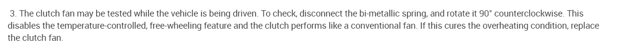

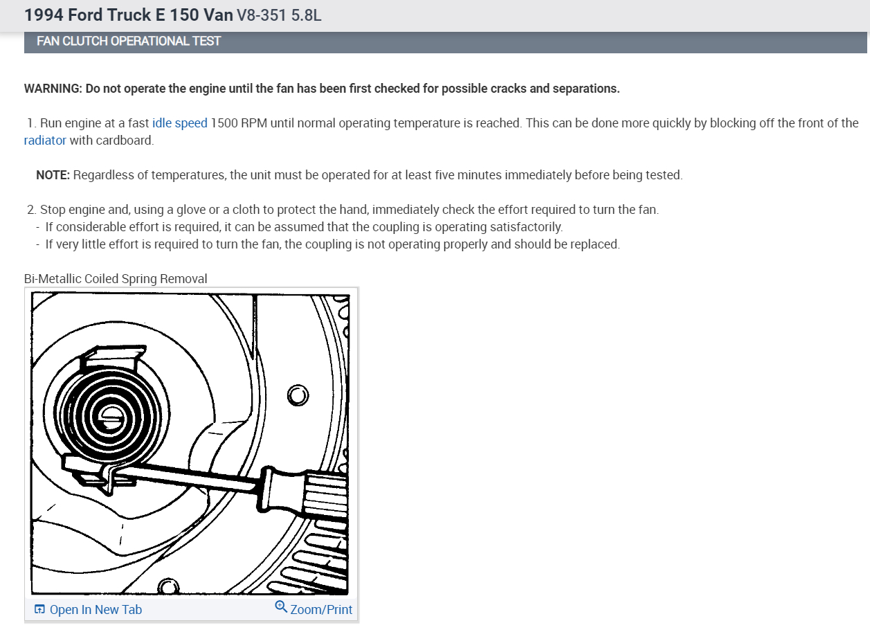

Our van, 1993 Ford E-150 Econoline, is only overheating on the highway when the air conditioner is going. If the heater is on it does fine. Thermostat has checked out fine. We flushed the radiator; spark plugs have been replaced along with some hoses. Could the air conditioner be bad? It doesn’t seem to turn off at all (constantly running when on).

When the engine is overheating can you hear the fan clutch engaged? If not, this is your problem, here is a guide that can help as well, and I have included how to change the fan clutch out in the diagrams below:
https://www.2carpros.com/articles/engine-overheating-or-running-hot
and
https://www.2carpros.com/articles/fan-clutch-removal

Make sure to use a high-quality replacement part. Check out the diagrams (below). Please let us know what happens.
