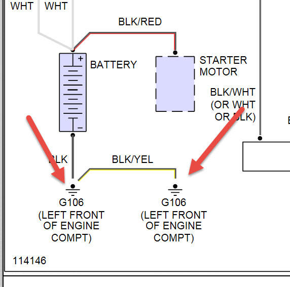

Hello Again, I asked the below question yesterday. The person that answered it asked about any engine codes. The Van does not show any engine codes. The SERVICE ENGINE LIGHT works like it should. When I first started having the below trouble, I took the Van to my local garage repairman. He looked the van over, but then told me that unless the onboard computer gives a engine code (WHICH IT'S NOT DOING) there is nothing he can do. He told me that if I wanted too, I could leave the Van for a few days, but it would be a hit and miss as to him being able to find the problem and fix it, not counting what it might cost me. PLEASE HELP.
Hello, I have a 2000 Mercury Villager Mini Van 3.3L. The problem I have is that every day I use the A/C the next morning when I try to start the van, the Radiator Fan turns on (THE VAN HAS SIT ALL NIGHT) and the van will not start. I have to keep turning the key on and off until the fan stop. Then when I try to start the van, the van won't start. The motor turns over real good, but it will not start. Sometimes it smells like the engine is flooded. If I wait a little while (LIKE A HOUR OR SO) the van will finally start. I do not have this problem, if I do not use the A/C. The problem started just a few weeks ago. I have the van for two(2) years now, up until now the van has run real good.

I answered this once but as I've pondered this for awhile the only thing that is logical to me is the ground to the battery/body and or engine is corroded as well as pcm ground wire is the same . it has to be that unless this vehicle was in a flood and if that is the case all bets are off.

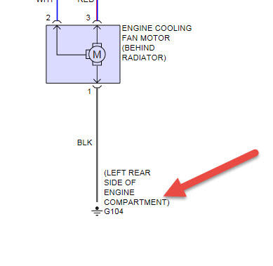

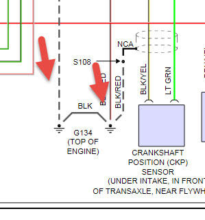

what it sounds like is something isn't grounding out and normally the cause is a ground wire broken,corroded, etc. check the grounds in the 3 places shown in pics. I really can't think of much more on this at all. if they are corroded just clean them with a wire brush put some dielectric compound on them and make sure they are tight not loose.
