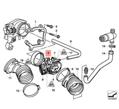

How does the engine run now? If okay, there was no damage done. The limp mode tells me the throttle actuator probably needs service. Here is a generic guide that will help you see what to do with specific instructions in the diagrams below for your car:
https://www.2carpros.com/articles/how-a-throttle-body-works
