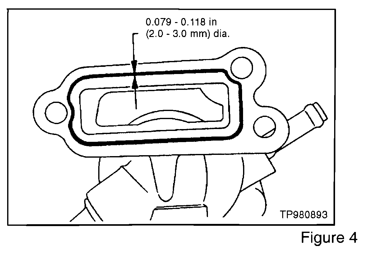

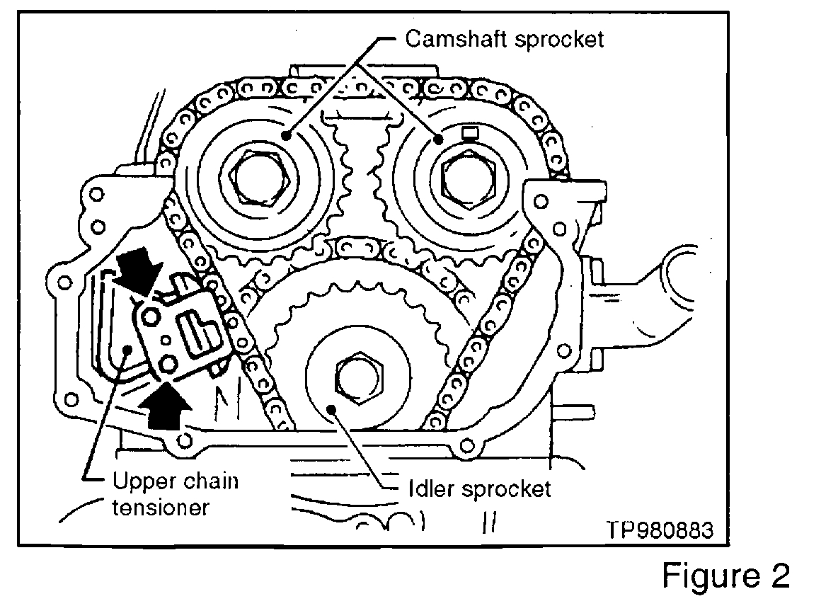

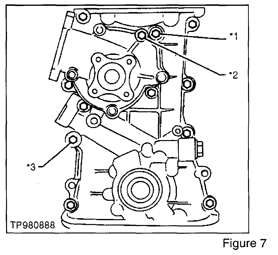

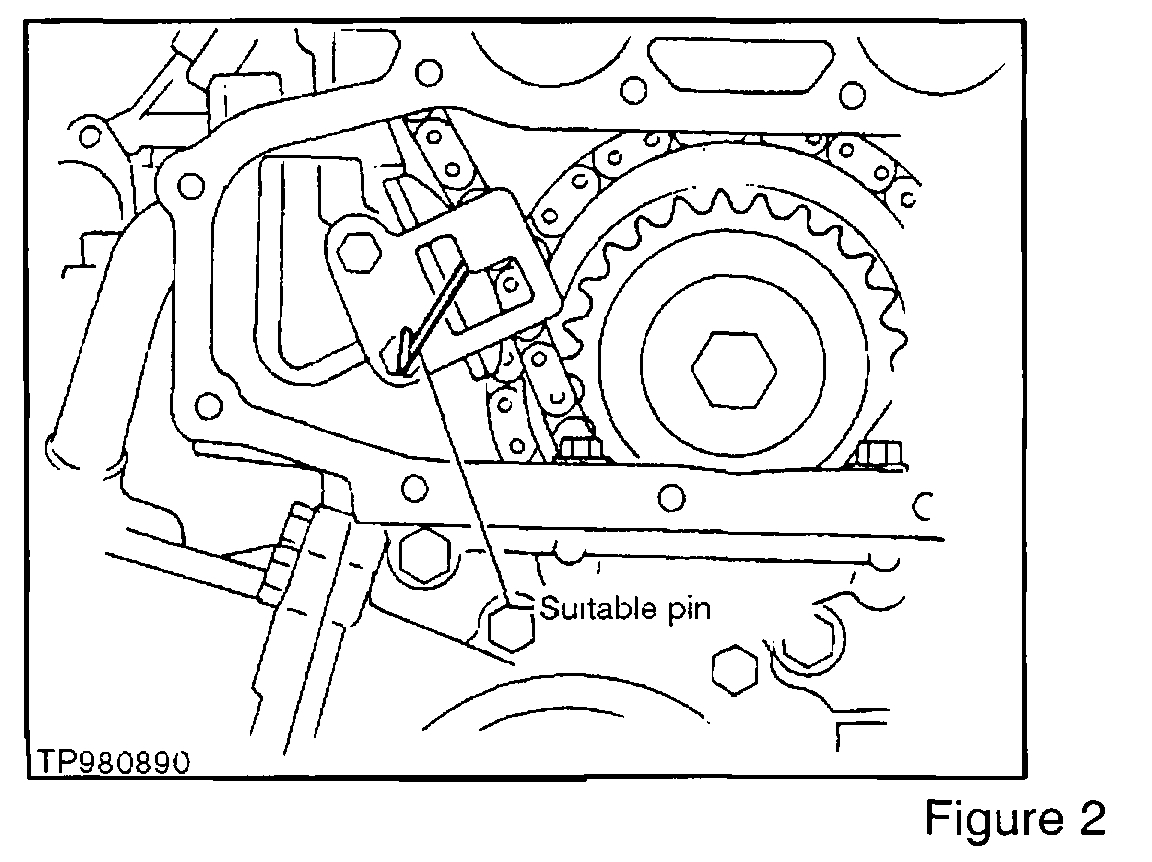

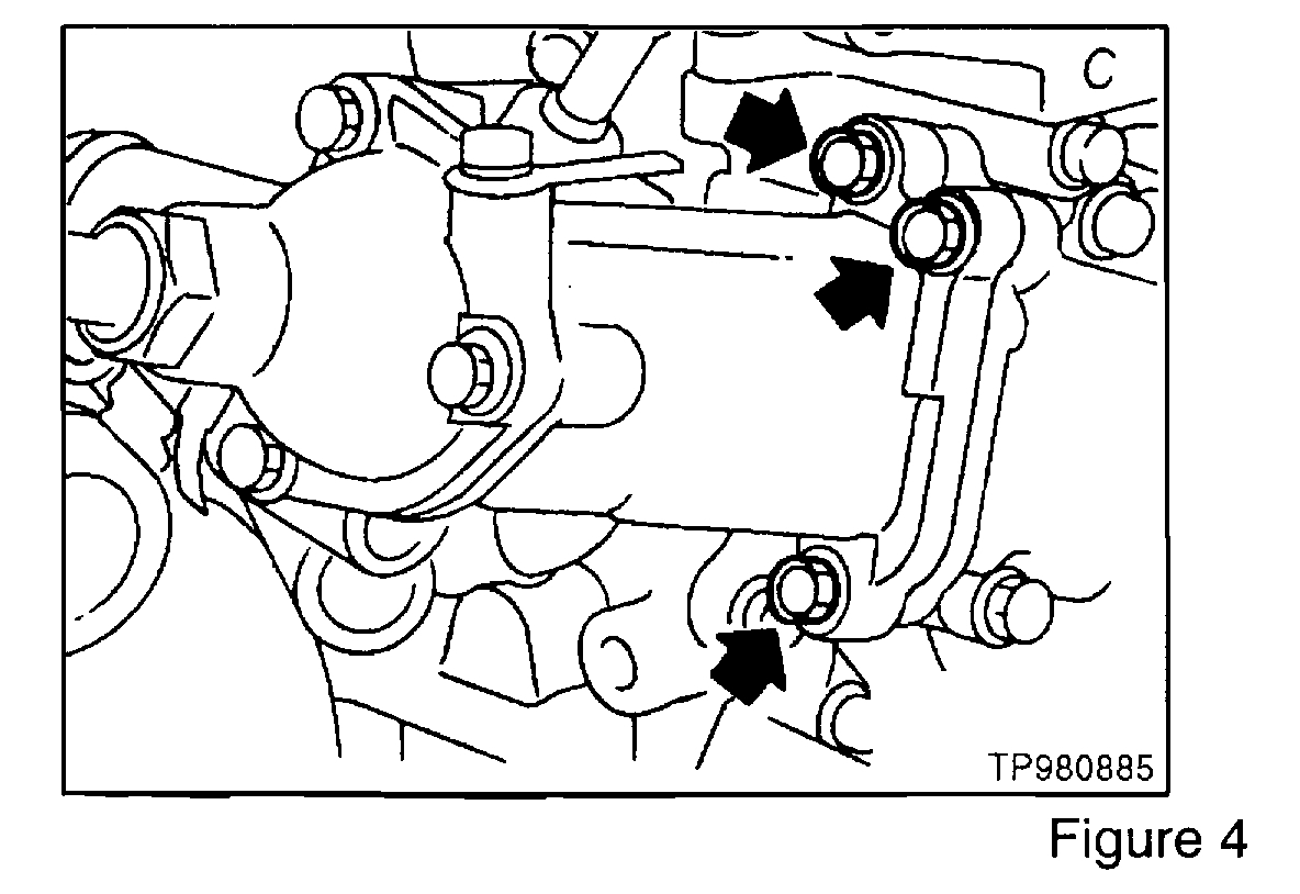

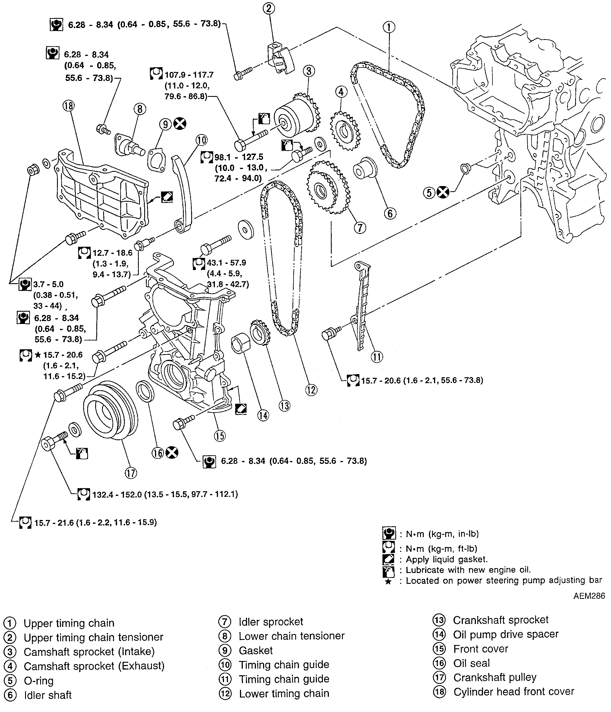

I do not know if you need it, but I figured I would give you the removal and replacement directions for the timing chain. First will be removal directions followed by replacement. All attached pictures correlate with these directions.

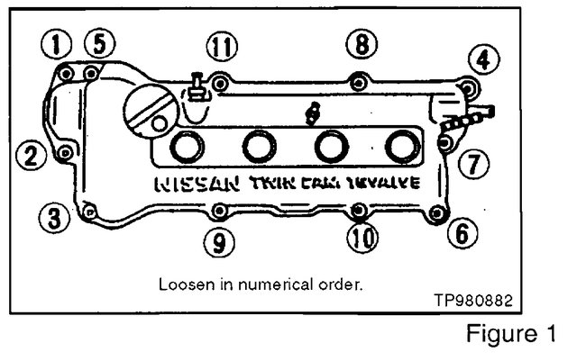

3. Remove the rocker cover (see figure 1). 4.Remove the coolant reservoir tank with bracket and reposition it for clearance.

9. Remove the upper chain tensioner (see figure 2).

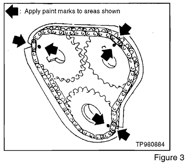

10. Wipe off the links of the upper timing chain next to the timing marks on the sprockets. Put paint marks on the timing chain, matching them with the timing marks on the cam sprockets and idler sprocket (see image 3)

19. Remove the thermostat housing (See figure 4).

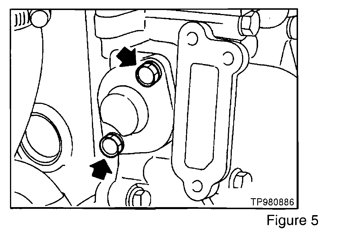

20. Remove the lower chain tensioner (see figure 5).

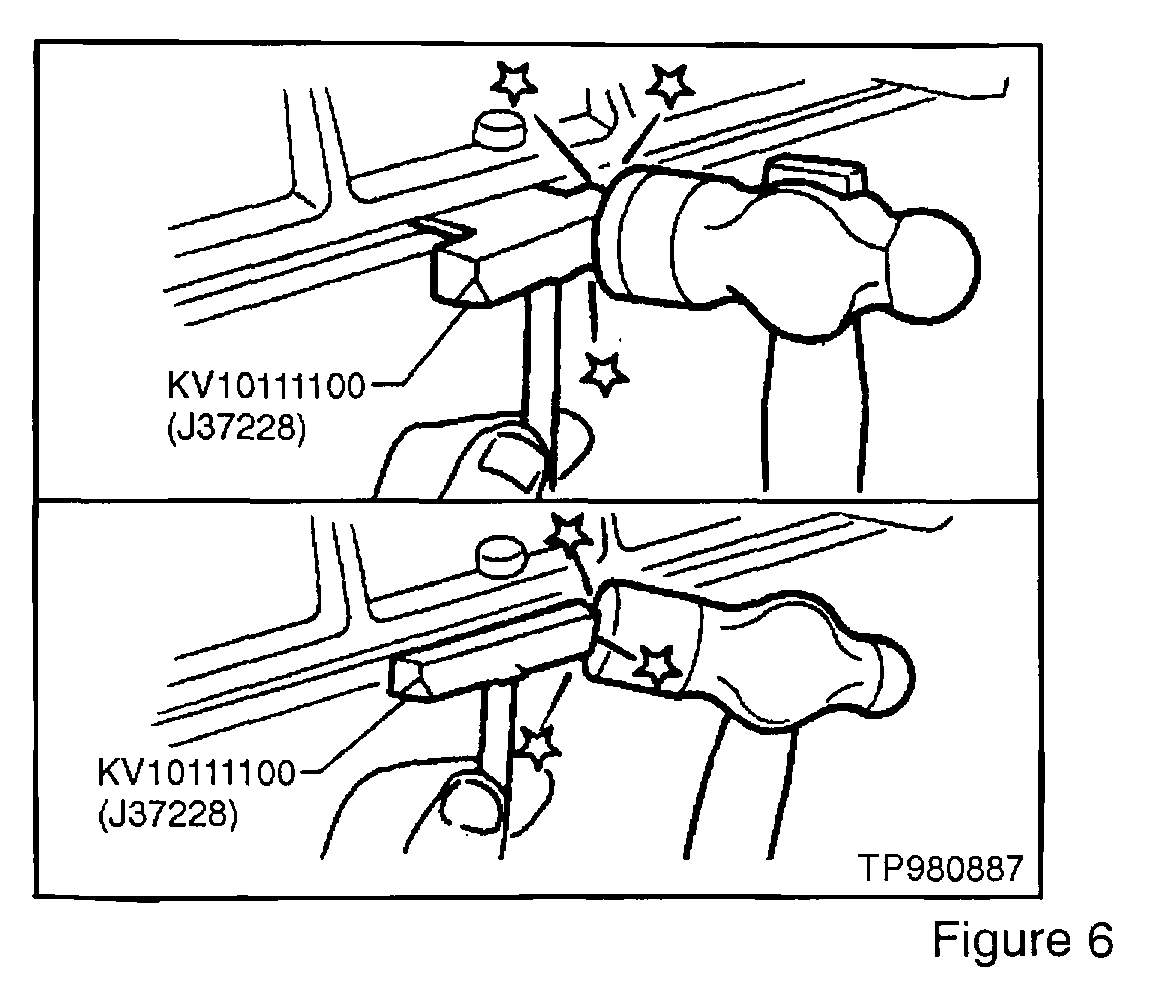

23. Remove the oil pan (see figure 6).
a. Insert the tool between the cylinder block and oil pan.
CAUTION:
Be careful not to damage the aluminum mating face. Do not insert a screwdriver, or the oil pan flange will become damaged.
b. Slide the tool by tapping it on the side of the tool with a hammer.

27. Remove the front cover bolts and front cover.
CAUTION:
One bolt is located on the water pump (see figure 7).
*1: Located on engine front mounting bracket.
*2: Located on the water pump.
*3: Located on the power steering oil pump adjusting bar.

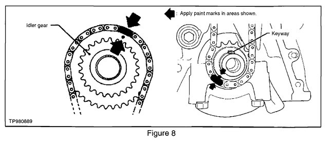

29. Wipe off the links of the lower timing chain next to the timing marks on the sprockets. Put paint marks on the timing chain, matching them with the timing marks on the idler sprocket and crankshaft sprocket (see image 8).

Replacement:
1. Install the crankshaft sprocket, making sure the mating marks face the front of the engine.
2. Install the idler sprocket and lower timing chain using the mating marks and the paint marks made during the removal process.

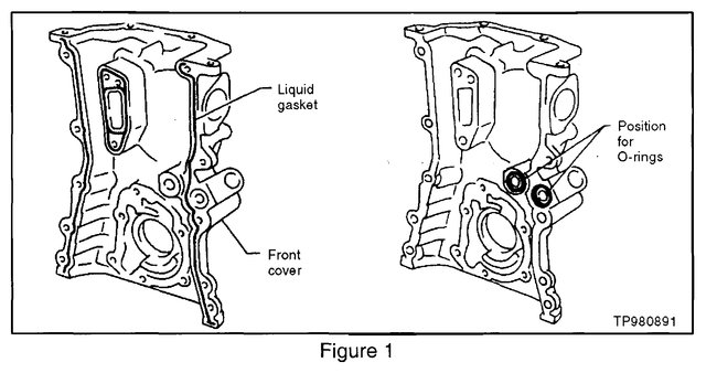

c. Install new oil passage O-rings and apply a continuous bead of RTV sealant to the front cover (see figure 1).

8. Install upper timing chain and sprockets, using the painted reference marks made during removal.
9. Install upper chain tensioner.
a. Before installing the chain tensioner, insert a suitable pin into the pin hole of the chain tensioner (see figure 2) to hold the tensioner in.
b. Once the tensioner is installed, remove the pin.

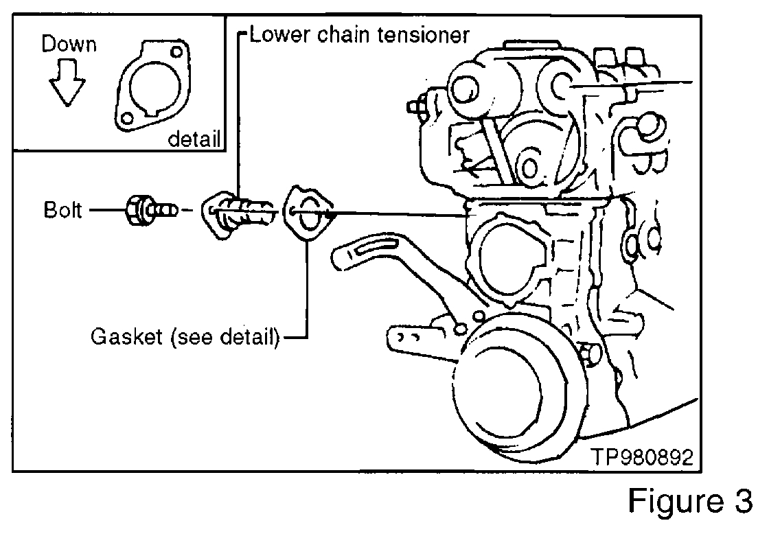

10. Install the lower chain tensioner (See figure 3).
NOTE:
Make sure the gasket is facing the proper direction before installing the tensioner.

a. Use a scraper to remove all traces of liquid gasket from the mating surfaces of the engine front cover and the thermostat housing.

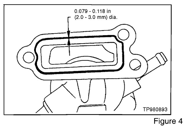

b. Apply a continuous bead of RTV sealant to the housing as shown in image 4.
NOTE: Use Genuine Nissan RTV silicone sealant P/N 999MP-A7007, Three Bond P/N TB1207D or equivalent.

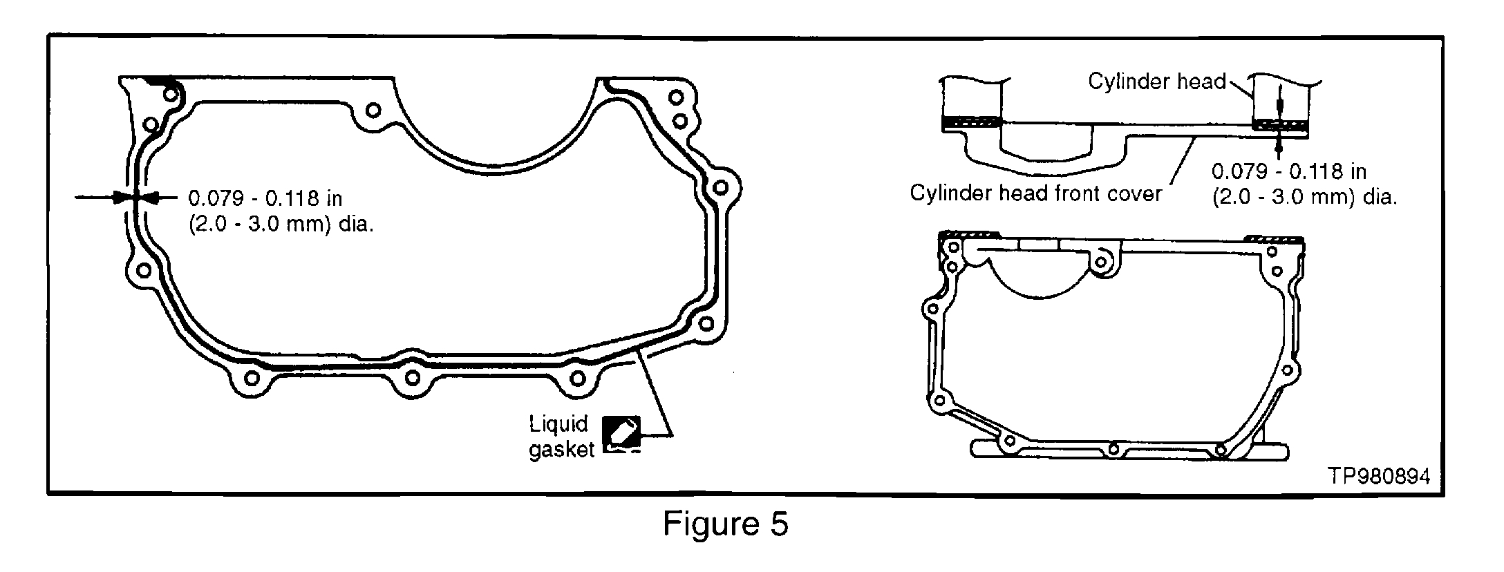

b. Apply a continuous bead of RTV sealant to the cover as shown in image 5.

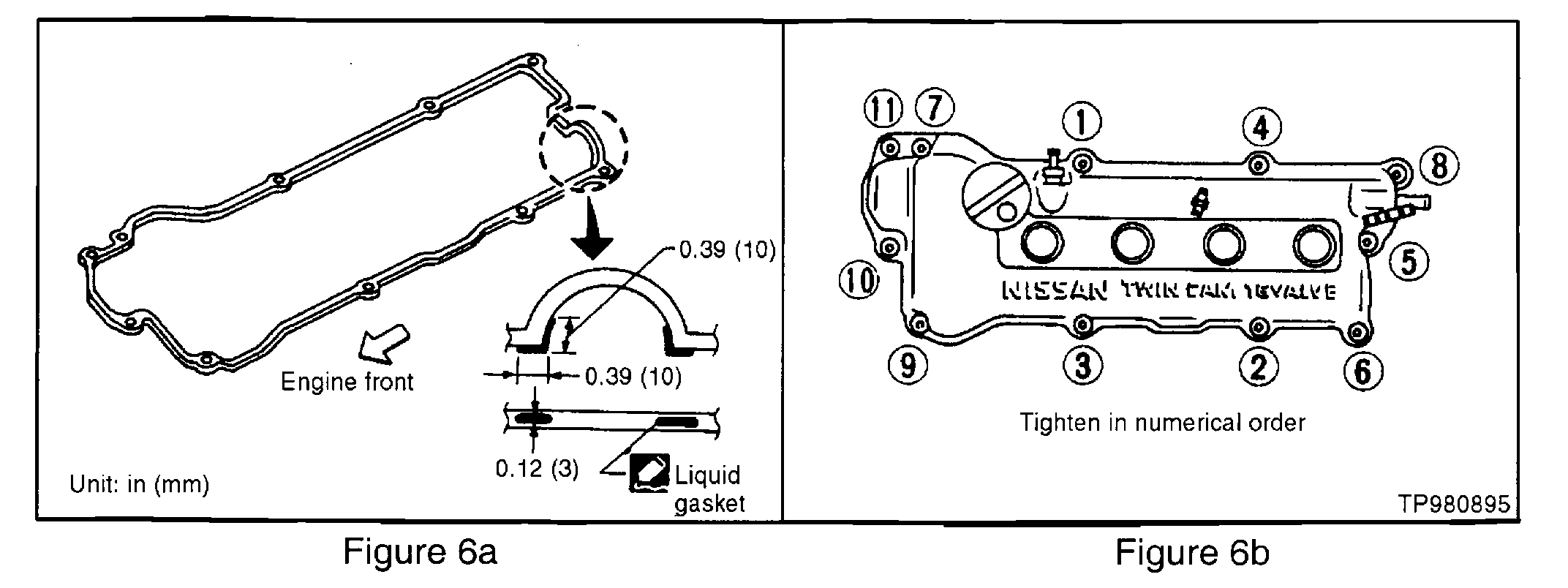

13. Apply RTV sealant to rocker cover gasket (see figure 6a) and install rocker cover, tightening the bolts as shown in figure 6b. 14.Install the following parts:
