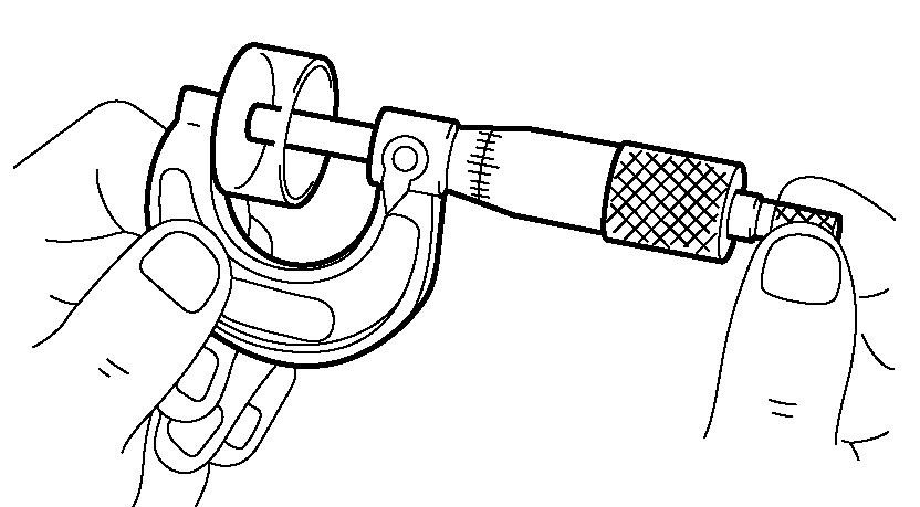

I think I may have mixed up my camshaft followers or whatever they are called
1996 SUBARU LEGACY
300,000 MILES • 2.5L • 4 CYL • 4WD • AUTOMATIC
MASTERLOWPRO
I have done everything in this build before but I've never encountered this issue. . but when my camshaft is installed one of my valves doesn't seat or seal. however, when the camshaft is not in the head the valves seat perfectly I tested with seafoam and the seal was true. I didn't think i mixed up my followers but i don't know. i have never done that before. is there a difference? I have done more rebuilds than i can count for friends and family as a side business for 13 years and never seen this before. No formal education at all. Just learned from pops.
Dec 1, 2019 at 11:45 AM
  • 110,240 POSTS
Were the followers replaced (new)? That doesn't make sense. Something it causing an issue with clearance. Are the valves new? Are the valve springs on in the correct direction?
Dec 2, 2019 at 10:22 AM
MASTERLOWPRO
The following is both thinking aloud and asking for confirmation/correction. Thank you so much for help. I've never done this part before
Okay, so i have 4 buckets that need to be switched around. They are not new. My roommate knocked them over so i have been informed and he just put them back however he felt. When the camshaft is installed properly the valves don't close when they should be all the way closed. This means there is no clearance between lobe, in any position, and bucket. The buckets are the style with a small hole on the side that squirts oil if you squeeze them. The springs and valves DID NOT leave the head during this process. Things were cleaned but not removed besides the buckets and cams. I spent the last of my money on a feeler gauge and just need the most basic instructions on how to get it set up right so my valves seat once again.
PS. All the valves seated properly when this job started and the compression was fine and that's all i am trying to get back.

The only thing it can be then is the followers are worn differently, not allowing clearance for the valve to be closed.
Take a look through this. It describes how to adjust valves. It shows how to mic thickness. I suspect when the followers were mixed up, it caused this issue. The attached pics correlate with the directions.

pic 1

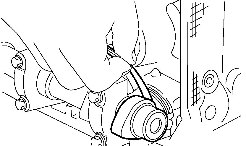

1. Measure all valve clearances.
NOTE: Record each valve clearance after it has been measured.
2. Remove the camshaft.
3. Remove the valve lifter.

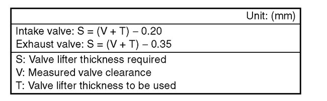

pic 2
4. Measure the thickness of valve lifter with a micrometer.

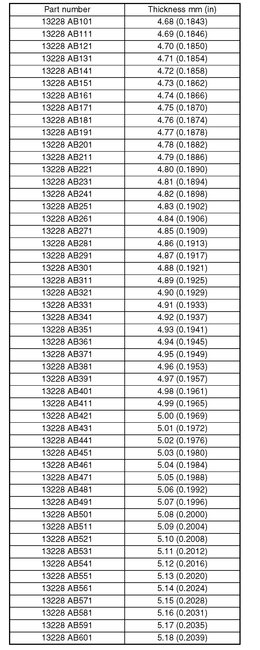

pic 3
pic 4

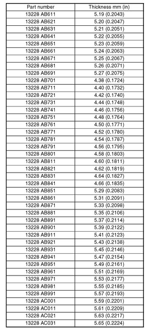

pic 5
5. Select a valve lifter of suitable thickness based on the measured valve clearance and valve lifter thickness, by referring to the following table.
6. Inspect all valves for clearance again at this stage. If the valve clearance is not correct, repeat the procedure over again from the first step.
7. After inspection, install the related parts in the reverse order of removal.
