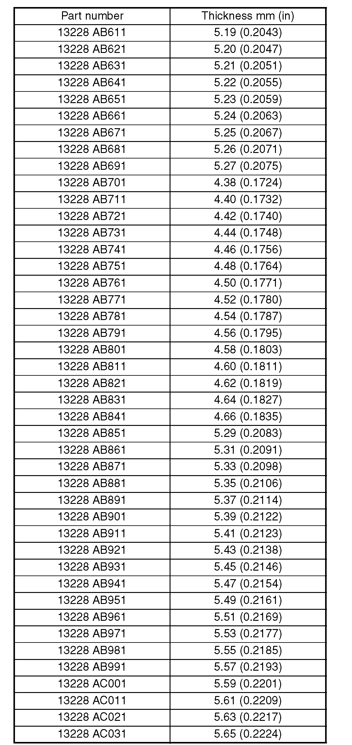

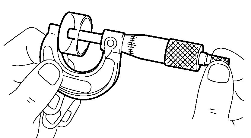

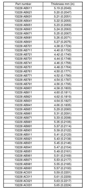

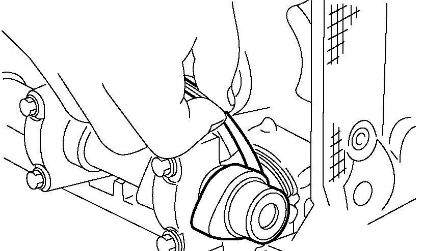

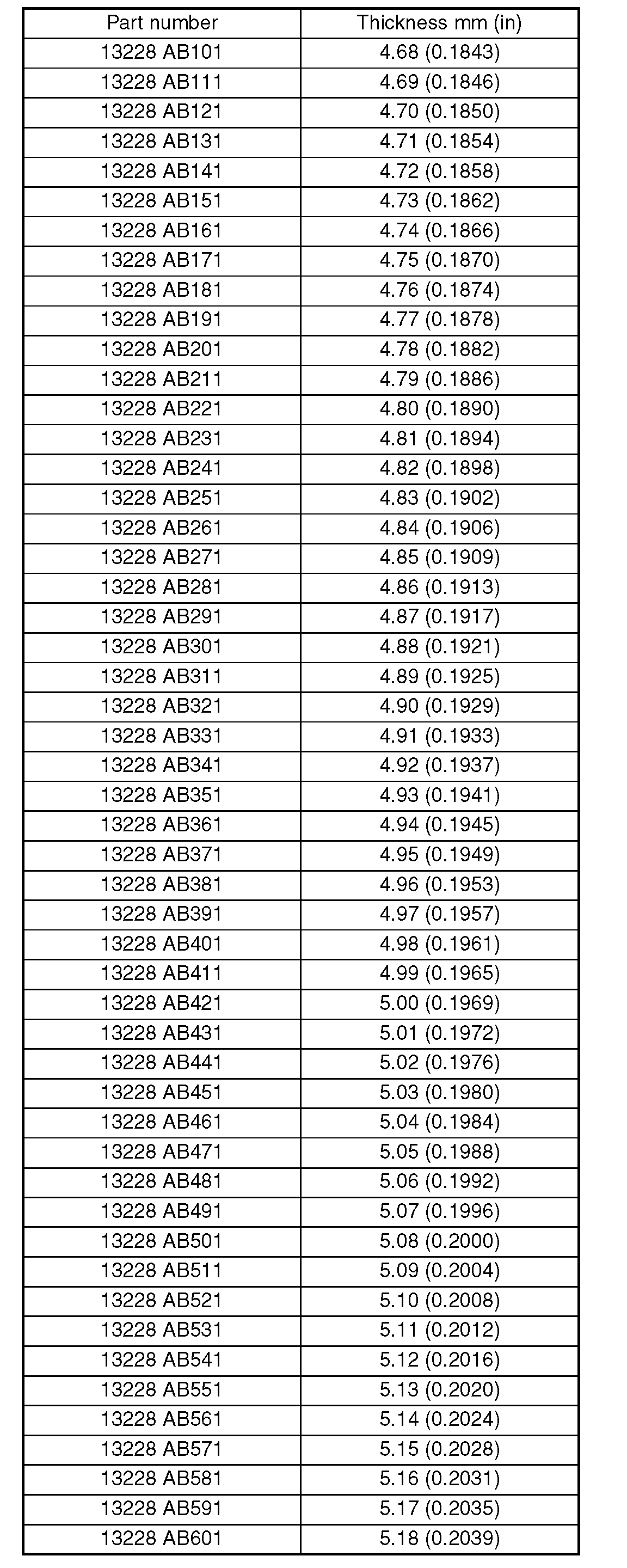

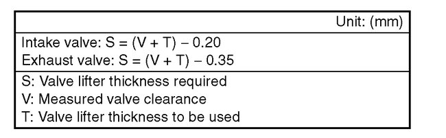

The only thing it can be then is the followers are worn differently, not allowing clearance for the valve to be closed.
Take a look through this. It describes how to adjust valves. It shows how to mic thickness. I suspect when the followers were mixed up, it caused this issue. The attached pics correlate with the directions.

4. Measure the thickness of valve lifter with a micrometer.
pic 3
pic 4
pic 5
5. Select a valve lifter of suitable thickness based on the measured valve clearance and valve lifter thickness, by referring to the following table.
6. Inspect all valves for clearance again at this stage. If the valve clearance is not correct, repeat the procedure over again from the first step.
