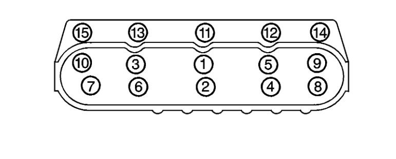

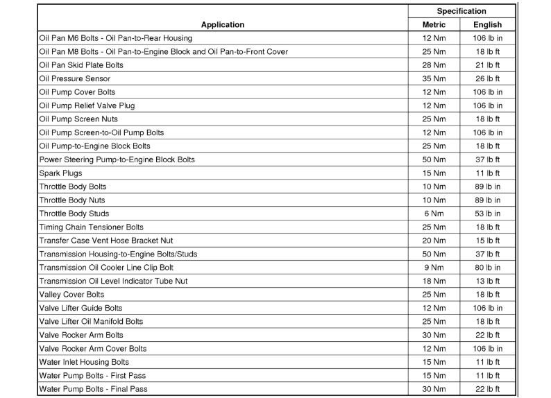

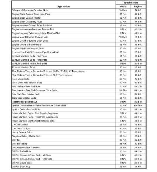

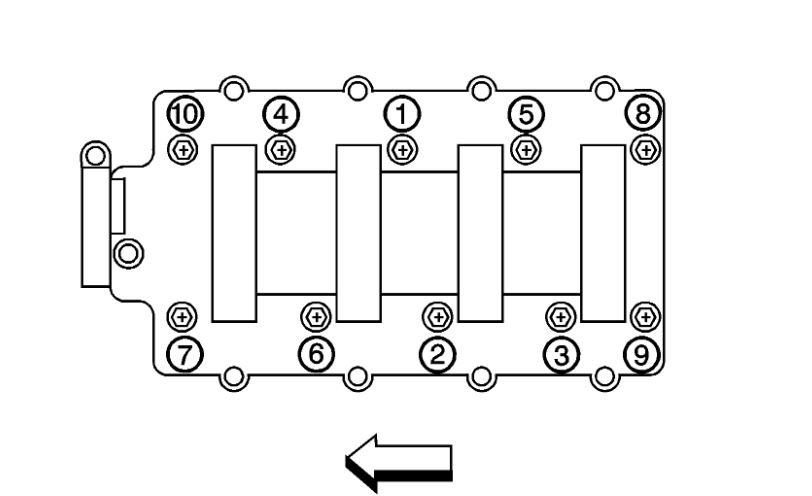

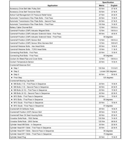

I need torque specs for the cylinder head bolts rocker arms and intake manifold bolts.
May 10, 2020 at 7:53 PM
Experienced Mechanic
52,796 POSTS
Good morning,
I attached all the torque specs for you fro the engine below.
I also attached the sequence for tightening the cylinder head and intake manifold.
Let me know if you have any other questions.
