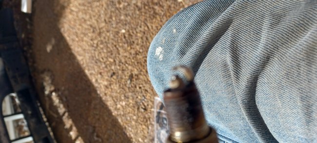

I had another question. I replaced the plugs and cleaned out the throttle body and IAC, I may have used a bit too much carburetor cleaner and it fouled plugs.
Won't start. Just turns over.
Do i need to air it out a bit and pull out all the plugs, and open the butterfly to let in air? Temporarily use the old plugs.
I'm just wondering how to get it back to starting.
Thanks
Mar 22, 2022 at 1:47 AM
HIDDEN1
  • 107 POSTS
Got it going. Had to let it air out with plugs out a quick turnover with fuel relay out. old plugs back i can i reinstall the new ones after cleaning with carburetor cleaner or did a 1-time oil on them hurt them permanently?

You should be able to clean the plugs and after they are dried out, they can be installed. It should not impact the performance. As long there was not damage to the electrode.
