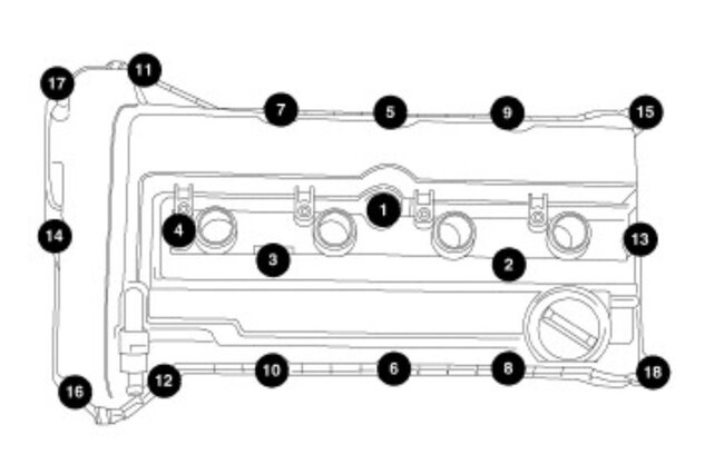

There were a couple of places online that said that the torque specs for this 2.4 L valve cover are about 106-inch pounds. I started out at around 50-inch pounds and that felt pretty snug for a valve cover.
106-inch pounds feels pretty tight for a valve cover. Am I wrong?

They are supposed to be done in 2 passes pass 1-to-55-inch pounds, pass 2-to-90-inch pounds. Using the attached pattern.

Tighten the 2.4L valve cover in two passes using the specified pattern: first to 55 inch-pounds, then to 90 inch-pounds.
Conversation Summary
The owner of a 2015 Dodge Journey asked whether about 106 inch-pounds was too tight for the 2.4L valve cover. The expert said to tighten it in two passes, first to 55 inch-pounds and then to 90 inch-pounds, following the specified pattern.
