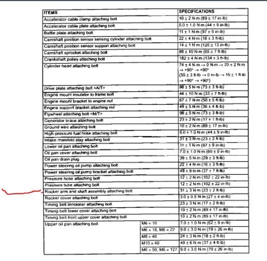

I need to know the correct torque for the valve cover I'm replacing.

Good morning,
I attached the torque specs for all the engine components for you below.
https://www.2carpros.com/articles/replace-valve-cover-gasket

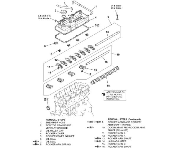

I attached a diagram of the valve cover as well.
