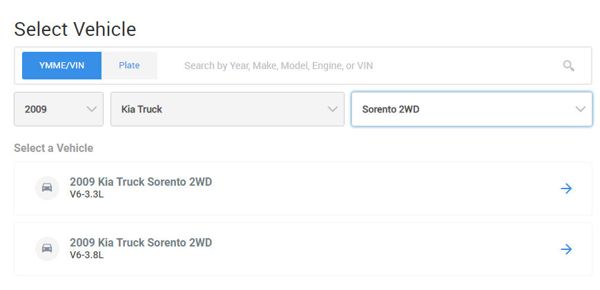

I tried to get the information for you, but they are only showing two V6 engines, a 3.3L and a 3.8L. See attached. I realize the crdi indicates a common rail direct injection and that is normally related to a diesel engine.
If that is correct, let me know. I don't believe that engine was offered in the US.
See pic below.

Hi Joe, yes that's correct, it's the 2.5 liter diesel engine .

I'm not finding information on that engine in any of my manuals. Are you located in the US?

No I'm in New Zealand.

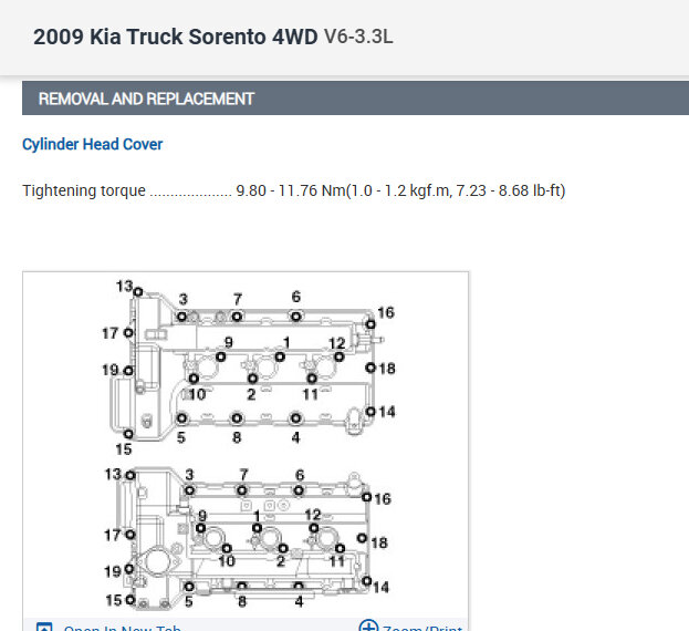

I'm sorry, but I don't have that info. The diesel wasn't offered here. That's why it isn't in any of my manuals. I'm going to ask the site owner if he has any suggestions.

If the vehicle is the same year, make, and model, I attached the torque specifications below for you. Note there is a sequence that should be followed when doing this. Tighten them in the order indicated.
The actual torque specifications are located above the valve cover pic. It is 8.68 ft.lbs. I would go an even 9 ft/lbs but make sure not to go above that.
I hope this helps. If your vehicle is a different year, make, or model, please start a new thread and give us all the specifics.
