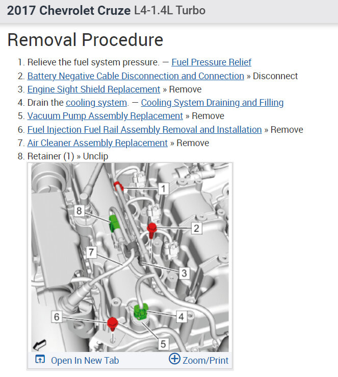

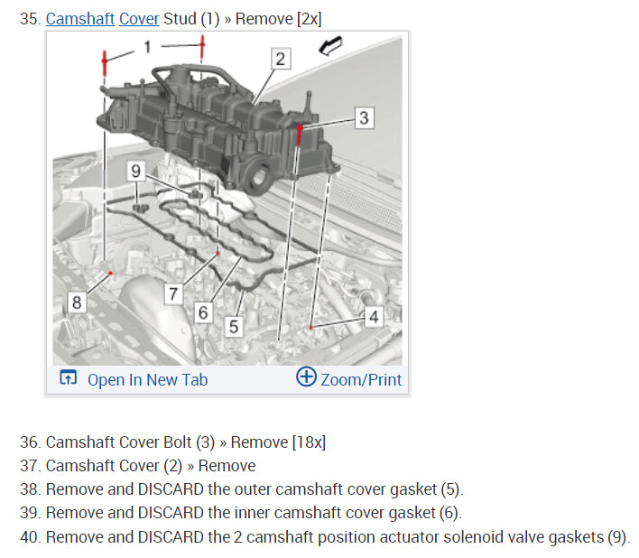

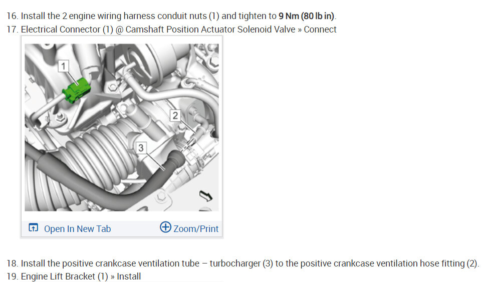

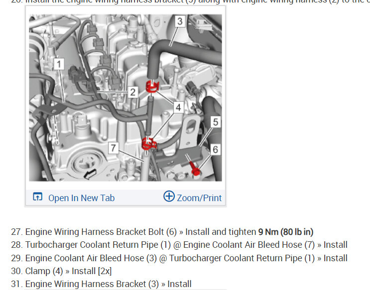

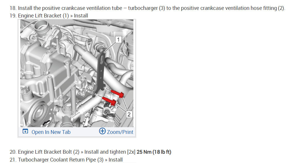

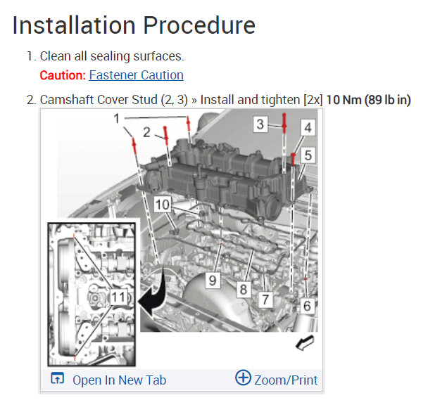

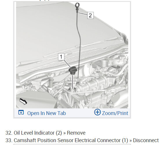

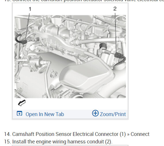

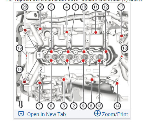

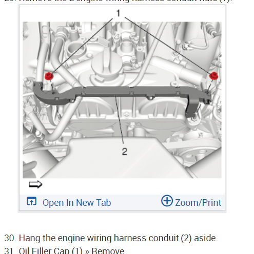

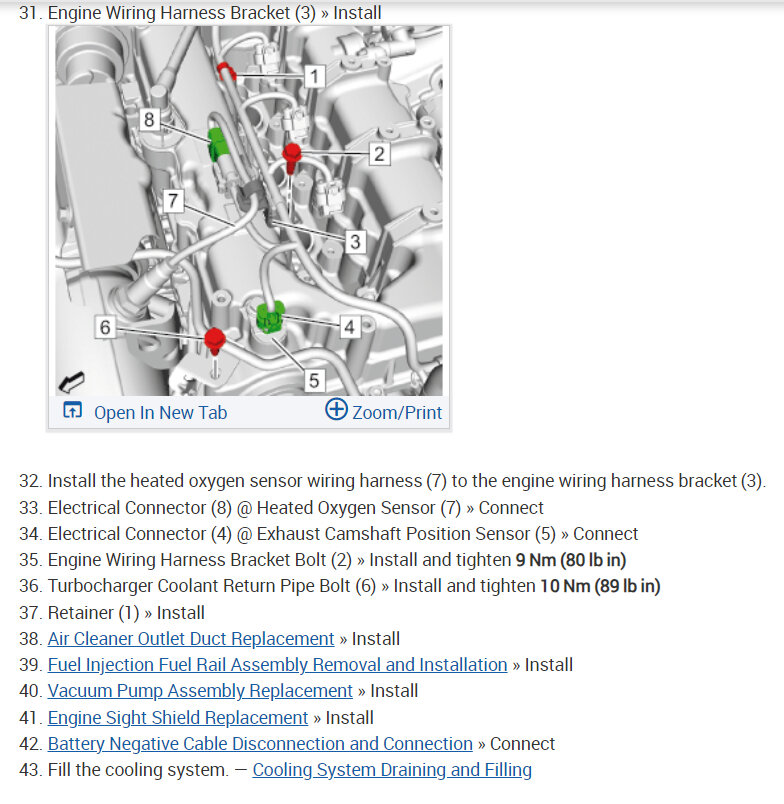

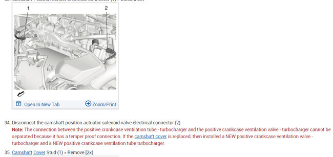

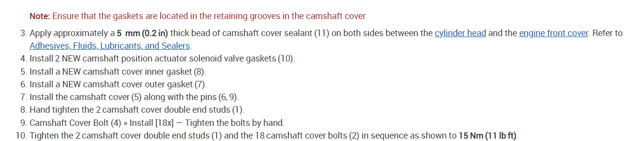

Hi, I just need the tightening sequence for the valve cover.
Jan 26, 2024 at 7:52 PM
Experienced Mechanic
55,647 POSTS

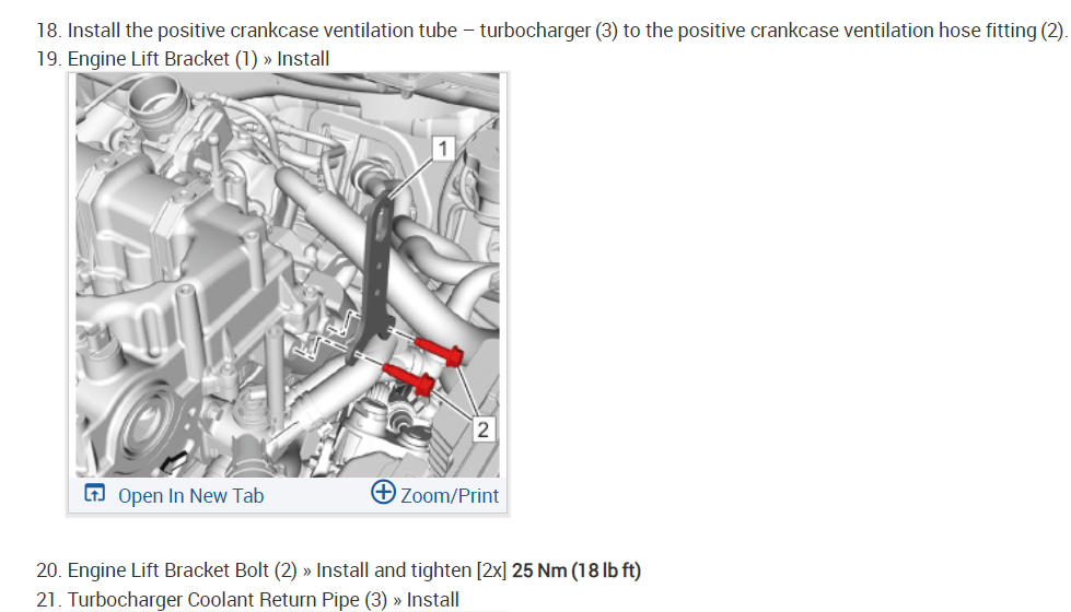

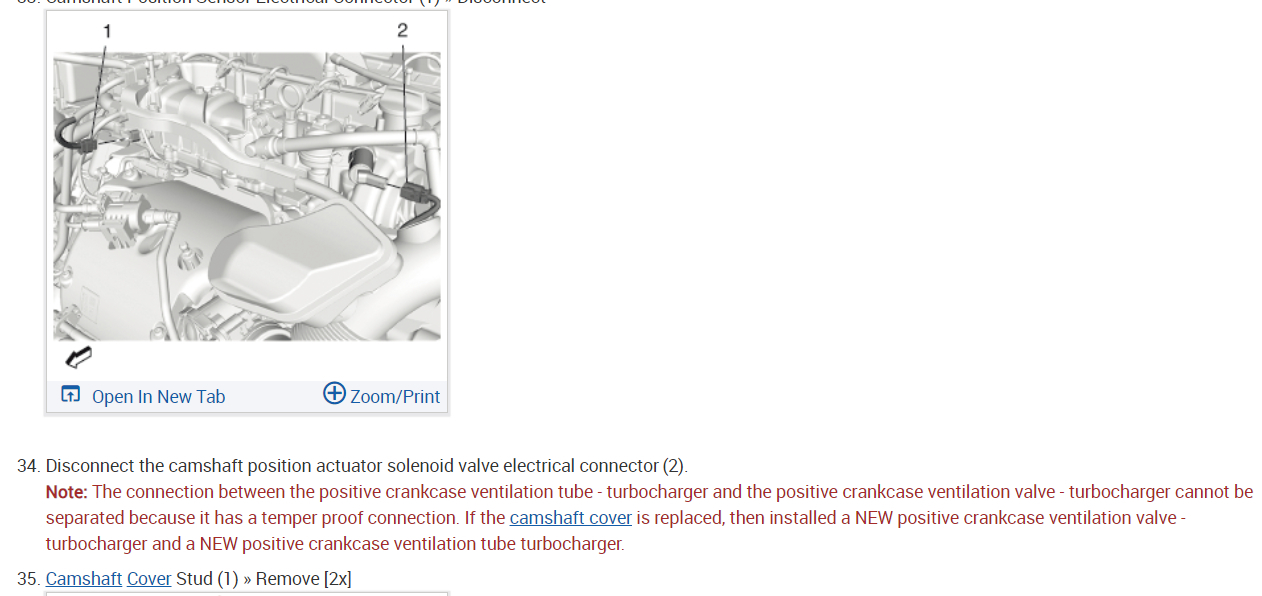

Here are the instructions and tightening sequence for replacing the valve cover. Check out the images (below). Let us know if you need anything else.
Images (Click to enlarge)
Jan 27, 2024 at 3:05 AM
MARCVRYAN
MEMBER
2 POSTS
Hi, I just need the tightening sequence for my 2017 Holden Astra.
Jan 27, 2024 at 3:06 AM (Merged)
55,647 POSTS
Please check out the post above.
