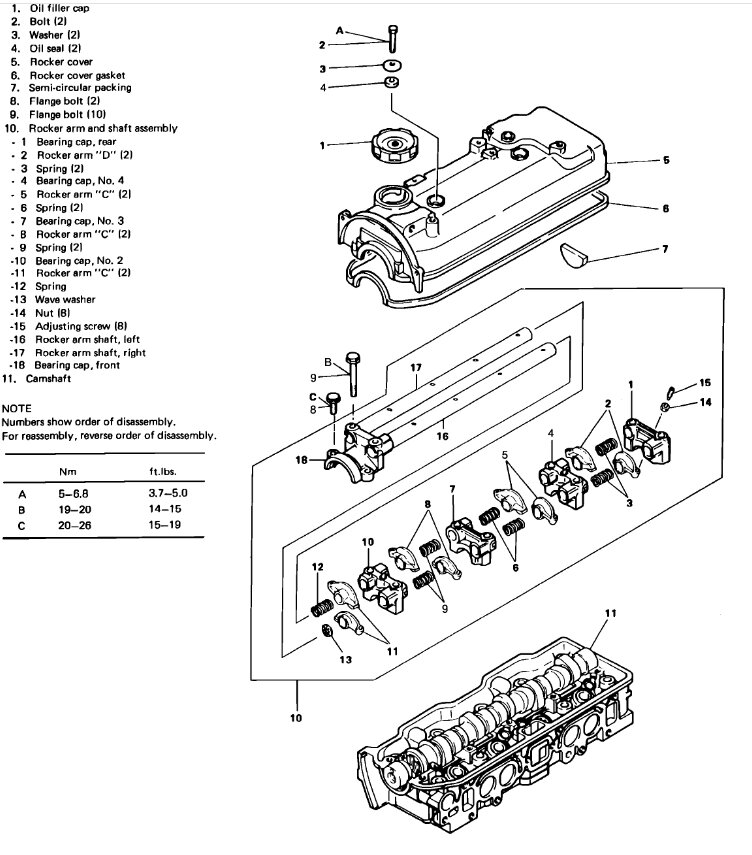

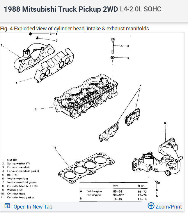

Valve cover noise?
1988 MITSUBISHI MIGHTY MAX
170,000 MILES • 2.0L • 4 CYL • 2WD • MANUAL
WILLY864
Sounds like a typewriter in the valve cover.
Nov 10, 2024 at 5:38 AM
  • 55,399 POSTS
The first thing I would do is check the engine oil. Next, remove the valve cover to see if any valve train components like valve springs or rocker arms are worn or broken. Here is how to remove the valve cover. Check out the images (below). Please upload pictures or videos in your response of any problems so we can see what to help you with.
