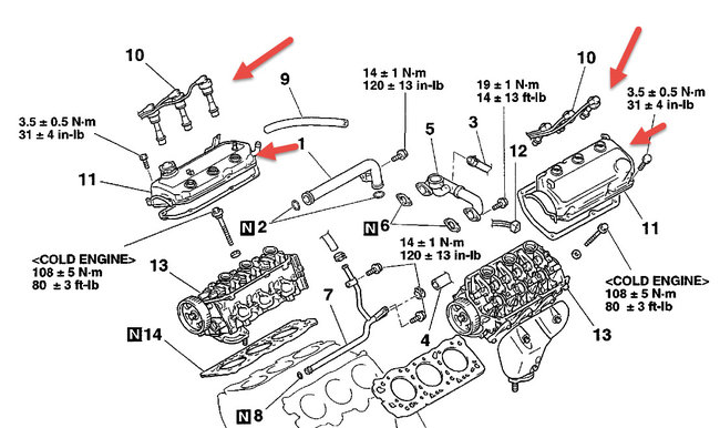

My Montero has an oil leak from the valve covers. I was needing to know how to replace them?
Mar 4, 2016 at 10:09 PM
HMAC300
  • 48,601 POSTS
remove plug wires and spark plugs and anything else in way of valve cover. Then the remove bolts and cover see picture.

Picture didn't show up.
