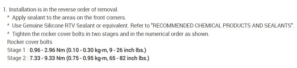

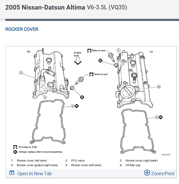

Valve cover gaskets replacement.
Feb 10, 2024 at 1:05 PM
Experienced Mechanic
55,649 POSTS

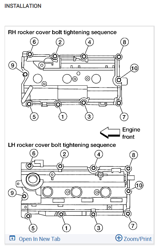

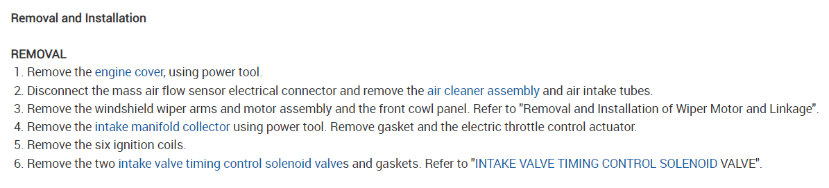

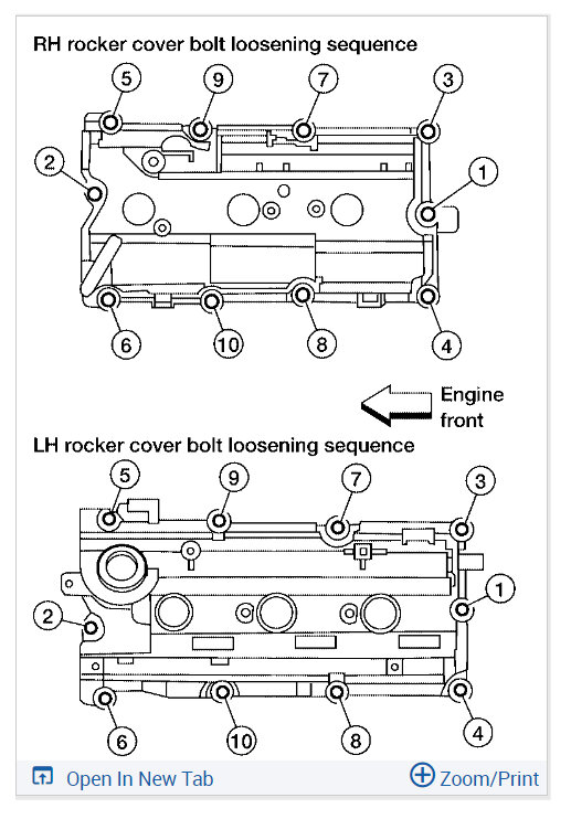

Here is the labor time for changing out both of the valve cover gaskets.
Both Banks 2.7 HRS @ shop rate.
Here is how the job is done so you know. Check out the images (below). Let us know if you need anything else.
Images (Click to enlarge)
